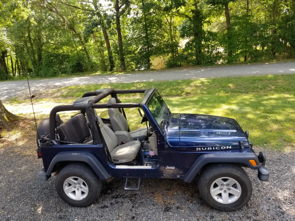

Ok so is this lift a good deal as I have read here and there about ome lifts being one of the best regular price is $1754.00 on sale for $1469.00 ...cant see going bigger that 33s...2004 Rubicon
Not really wanting to regear or deal with brake lines or long arm ...at least not right now and are these shocks good for road and trail or should I get rancho 5000x
