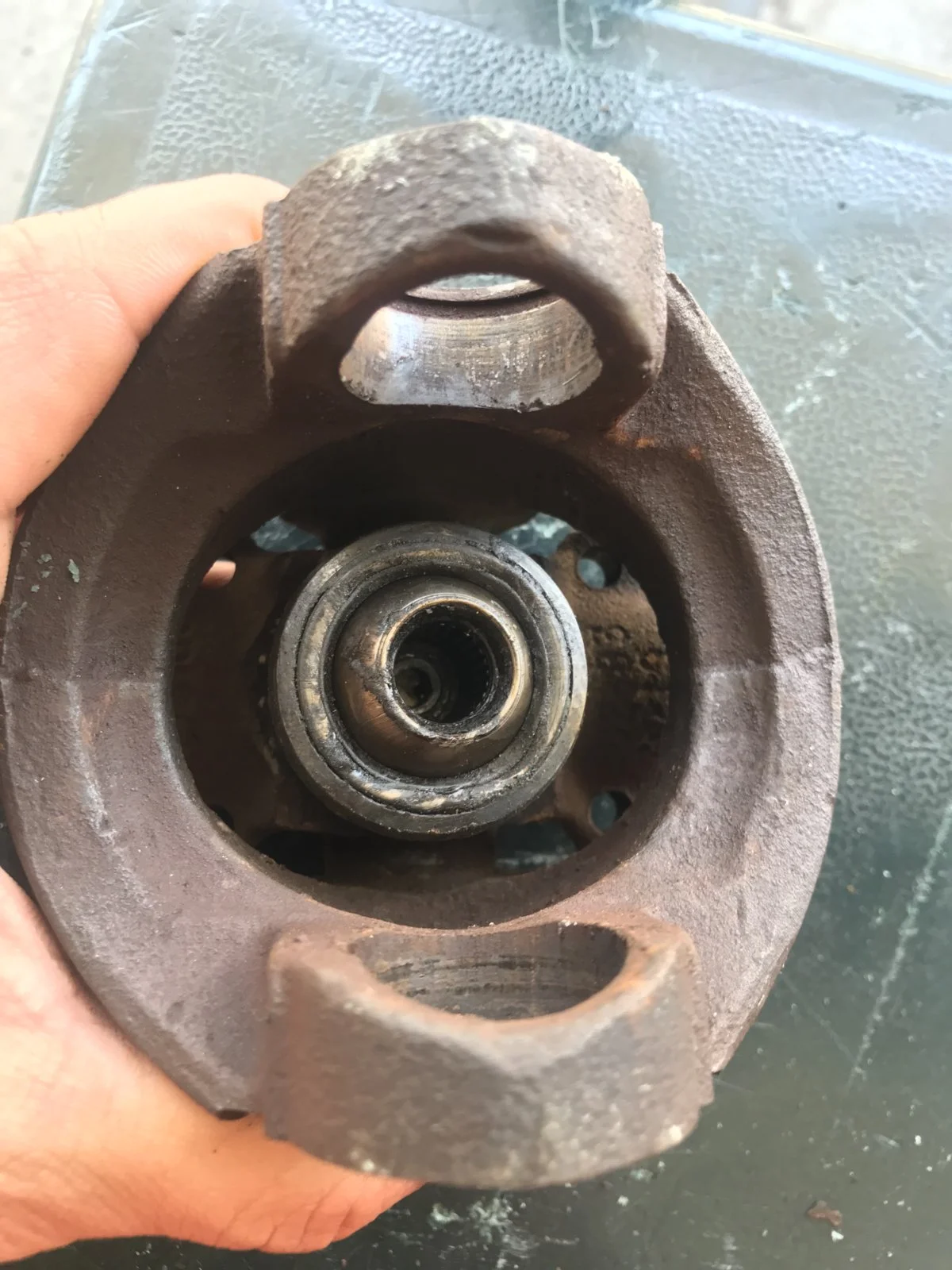

I was replacing my front Drive shaft u joints today and a needle bearing came off the front centering yoke. I never replaced it so now is the time. I already bought the 2 spicer 5-1310x u joints.
Part number is Dana Spicer 211544X Centering Yoke....NON GREASEABLE
Do I need the greaseable yoke or like the I joint is better to have it sealed?
Or should I just wait and buy a whole new front drive shaft?
I just replaced mine and the part number is 211996x for the non greaseable. I have a 06 rubicon not sure if it would be different for yours. I also replaced the rubber boot p/n 2-86-418. I think the non greaseable one is better.
Your part # for a non-Rubi model is correct. Get the non-geasable. It is a PITA to get a grease needle in there to grease them.
