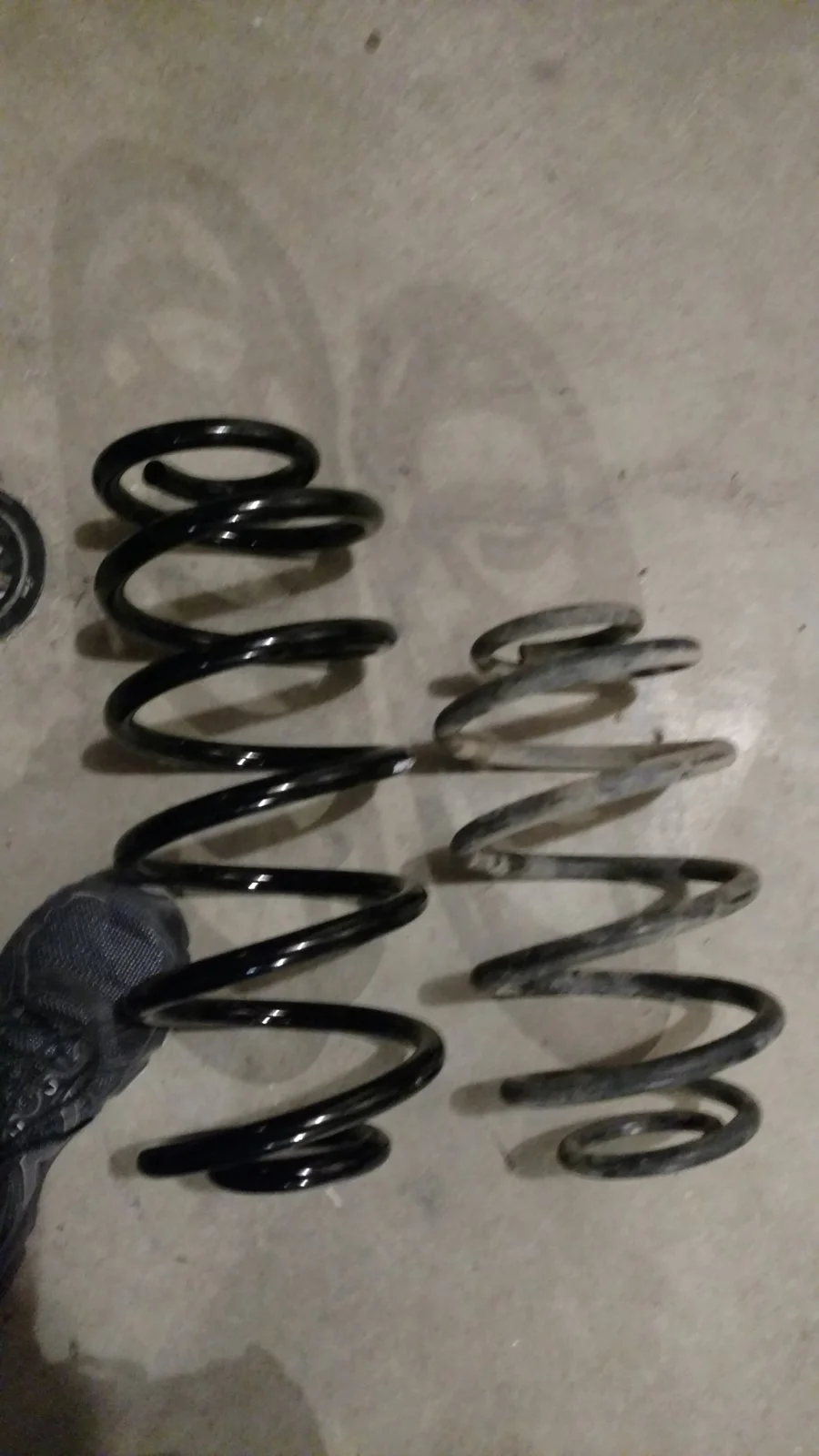

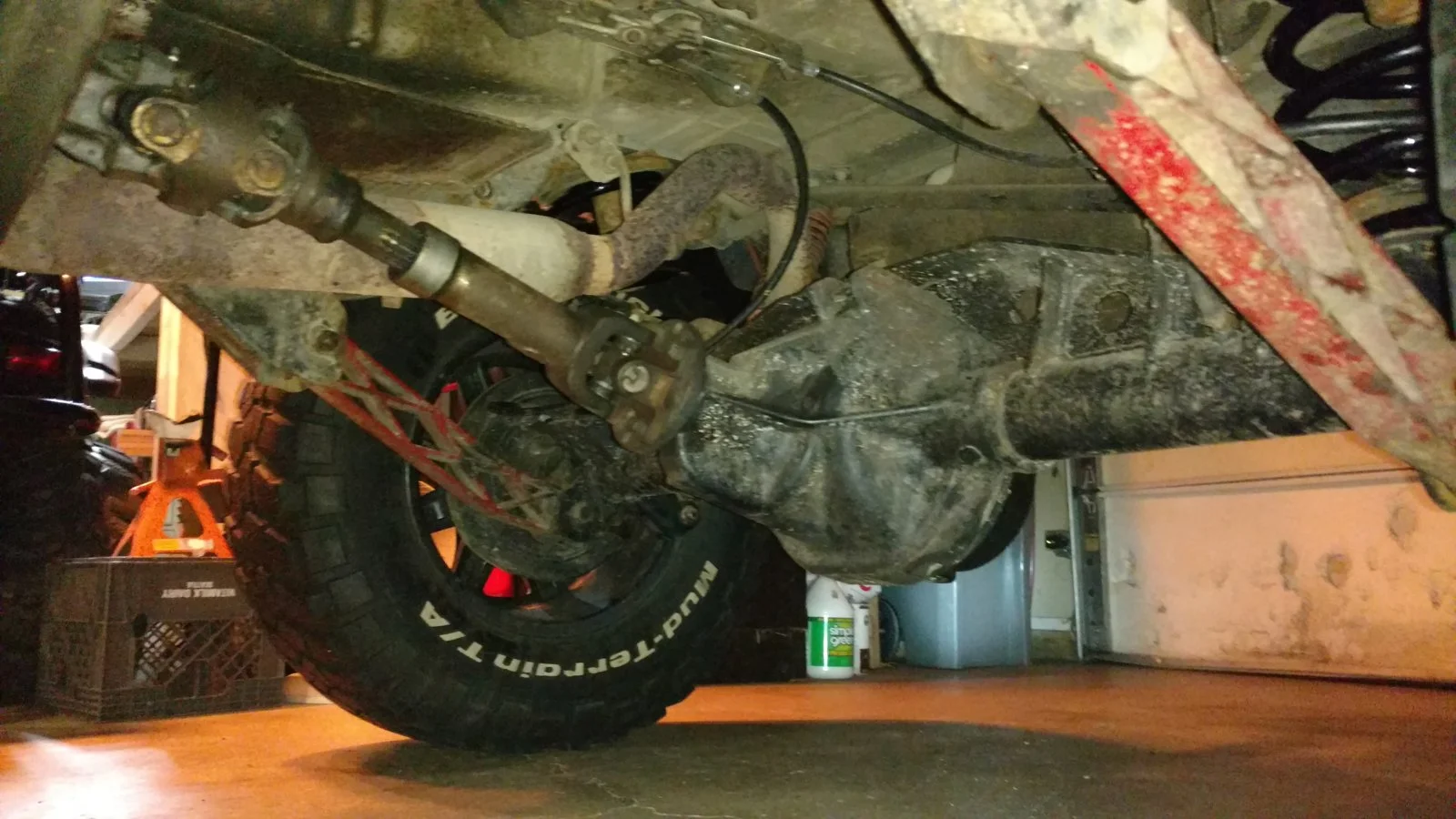

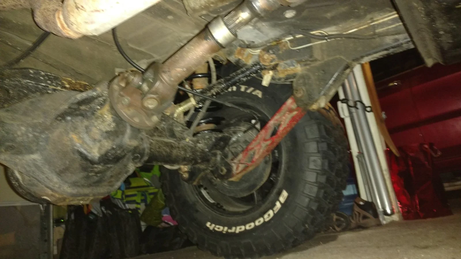

Digging this thread up because I recently purchased an 02 TJ with Rough Country 3.5" lift kit. The rear was too low, definitely had a squat look to it & the trussed Ford 8.8 diff cover was rubbing on the gas tank skid plate and the rear bumpstops hit all too often. The seller included a set of Rusty's Off Road progressive springs, about 4" taller in back, maybe an inch in front. I installed all the springs this weekend. Now I have a definite death wobble at 35 or 40 mph. I don't feel it so much in the steering. Reading up on what causes DW in here & other places. Sounds like the pinion angle is the problem. With the taller rear springs, about 4" or 5", the angle of the rear drive line has to have changed. The driveline has an SYE in it & like 1" spacers on the trans skid plate.
So I guess the best way to test this is to pull the rear driveline and give it a test drive?
Pinion angle does not cause death wobble (DW) no way it can.
The largest cause is out of balance tires. 90% of the time that is the trigger. Death wobble is ALWAYS felt in the steering wheel. It is bone jarring.
You vibration may be caused by the pinion angle.
If you have a SYE and a transfer case drop you are set up wrong. WAY wrong.
You need to have adjustable control arms to adjust the pinion angle. The point of a slip yoke Eliminator is that you don't need a transfer case drop.
Upload a couple of pictures of the drive line. And the drive shaft angles.
