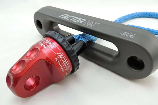

For anyone looking to create a scenario where a thimble can gouge the aluminum hawse, look at how Factor 55 does it. This is the correct way to do it wrong.
This is new to me so I'm still trying to learn it.... can you elaborate? How is the Factor55 different than the TRE in context of gouging the hawse?

The first thing to understand is that the red Factor 55 thing is really a shackle, not a thimble. The actual thimble is the rope support protruding from the red shackle.
From there, think about how the Safety Thimble is a redesign of the thimble used with the Factor 55 shackle.
The first thing to understand is the red Factor 55 thing is really a shackle, not a thimble. The actual thimble is the rope support protruding from the red shackle.
From there, think about how the Safety Thimble its a redesign of the thimble used with the Factor 55 shackle.

A thimble has the rope wrapping around it in such a way as to protect it from whatever object it is attached to. The Factor 55 is junk because it uses the stock thimble that sticks out of the bottom of their device and may come into contact with the fairlead. In reality, the Factor 55 (no one on here is a big fan of them, myself included, they make a lot of "bling" for jeeps that is quite dangerous and stupidly expensive) is nothing more than a poorly designed shackle that adds one more "link" in the winch line. When winching you want as few connections or links as possible, each one is a potential failure point, the fewer you have the easier it is to keep an eye on them for failure...... The TRE is a true thimble, in that the line is routed around the opening (the opening is large enough for a screwpin shackle if needed, or radiused enough for a soft shackle) thereby creating a protective path for the eye of the rope.
