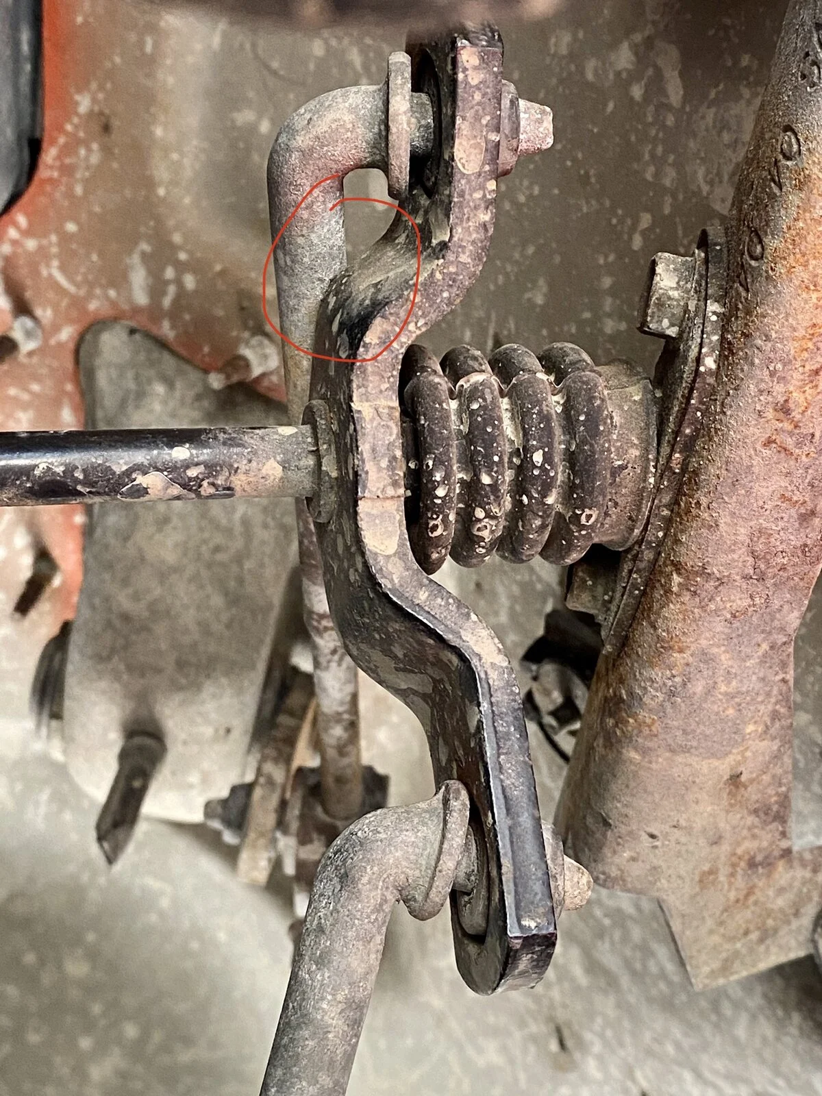

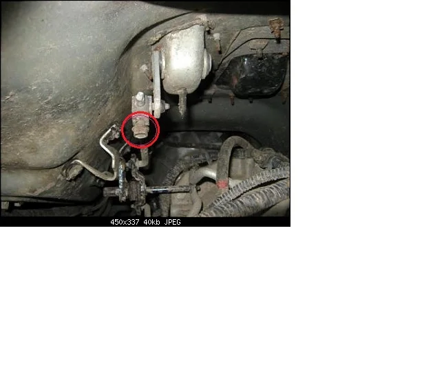

Your shift linkage has likely just slipped out a tad just needs to be adjusted back in to get it working correctly again. You only need a 1/2" wrench to do that, the bolt circled in red below is what holds it in adjustment

Thanks, @Jerry Bransford. So just tighten it up some?
Actually loosen the bolt , allow the rod to move the direction it needs to to move the actuator on the transfer case so you get more throw, and snug it up - I saw one guy loosen it, roll the actuator til it firmly engaged in 4 low by hand as someone held the lever up all the way, then tighten the nut.

So I messed around today with the piece that @Jerry Bransford siggested. It was already tight, and I was barely able to get it any tighter. Didn’t change anything as far as engaging 4L.
I messed around trying to get it in 4L for about 10-15 mins but never could get it to engage. It would only say it’s engaged, and then grind when I have it gas. Here’s a video…. any other ideas?
You need to loosen the bolt in the picture, then move the rod for the TC to engage 4L all the way, then tighten the bolt.
So if I do this, and then the 4L engages properly, I’ll know it’s my shift linkage that is the issue.
And I assume you mean do that every single time I want to shift into 4L, not just a one time thing, right?
Frank M
Oct 31, 2017
153
Bucks County, PA, United States
If you adjust the linkage so it engages into 4L all the way and tighten the bolt it should stay adjusted. You would not have to do it every time you wanted to shift into 4L.
It's the linkage thats the issue

This afternoon I put it in 4L, loosened the bolt, and manually forced it as far as I could into the 4L position. It appears that the rod running from the shifter to the plate (idk what it’s called - see pic) is hitting the plate and not letting it go any further to fully engage. I can get where the light will come on, but as soon as any gas is given, it slips right out. I can’t get it to go any further. It’s hard to tell if it would go any further if it wasn’t hitting, but I can’t move it any more.
I see a cable system in my near future, but any recommendations on a temporary fix?

It’s the t-case drop causing the problem. That type of linkage can’t have much change to the pivot points. It’s just not designed for it.
Avoid 4LO until you get the cable shifter. If you need LO, reach under there and shift it by hand. Expect it to fall apart. Been there, done that. All those pieces will be hot as hell when you do it. Good times.
