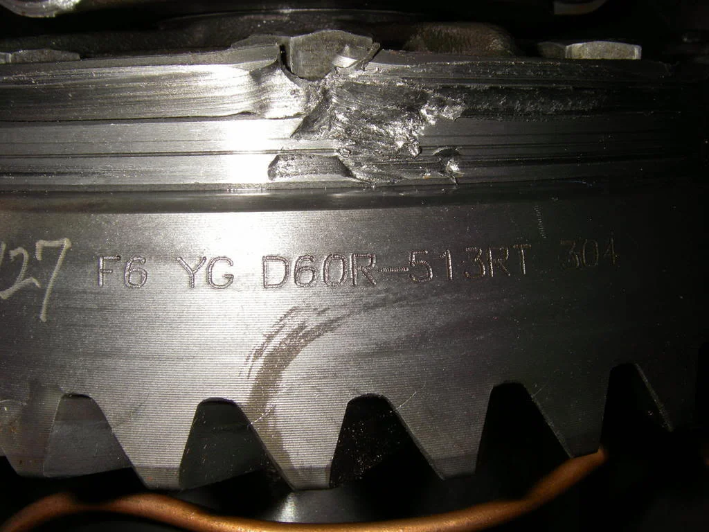

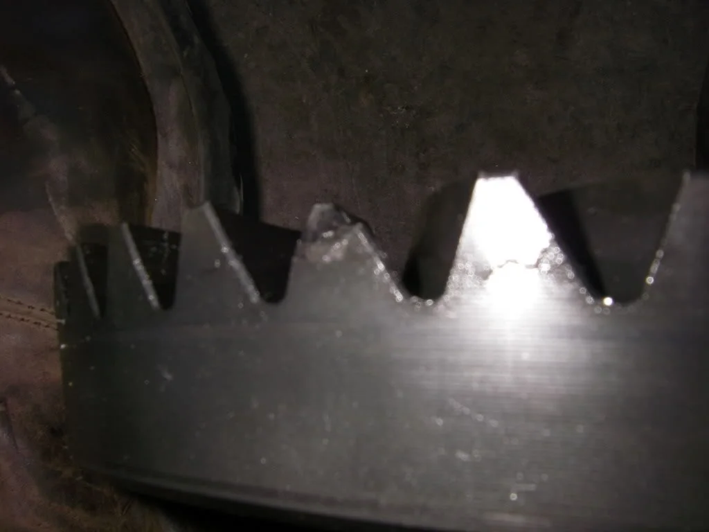

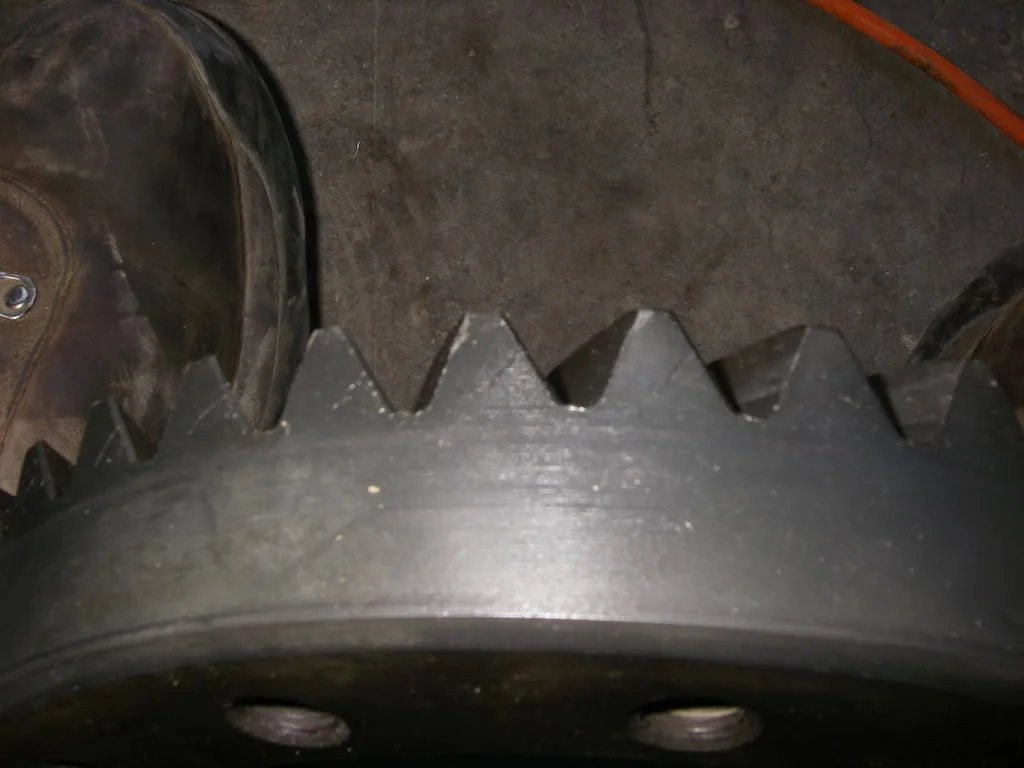

Well I broke the ring gear in my rear HP60. Once was being too throttle happy and bounced it about 4-5 times while getting on the throttle of my V-8. The second time was in Moab trying to climb some ledges. I think that second time was due to a faulty gear setup. I found a shop who was well versed in HP60's that setup my gears the 3rd time and so far so good.

Cracked ring gear
