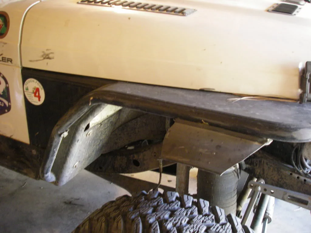

I'm still not understanding what you're not understanding. A flare mounts to the outer edge of the fender, why wouldn't it receive more damage than the fender does?
What do my PS Fenders look like they do? Get damaged? Some but not much, their outer edge is flush with the body.

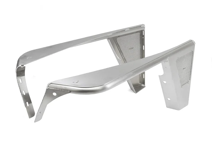

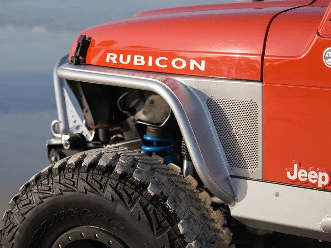

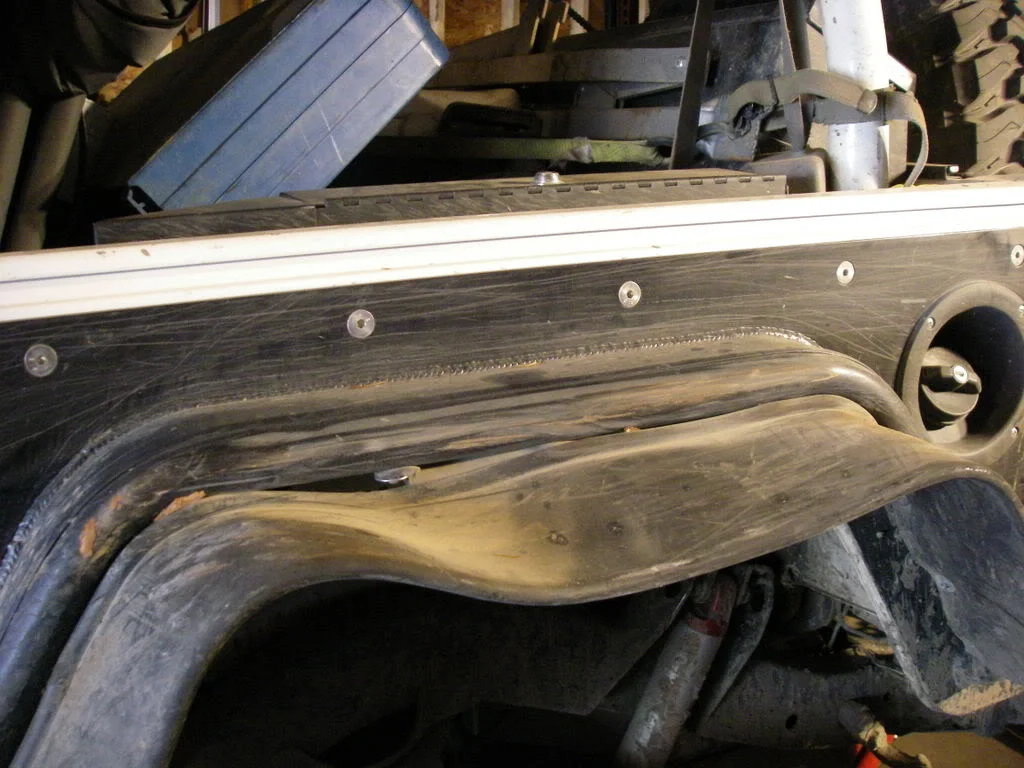

Isn't say the GenRight flare made out of the same material as the flush tube fender? So I am asking why does the flare fold but not the fender?

Look closely at those two images. One has a protruding metal flare. The other does not. The one without the metal flare has less stuff to get hung up on.
I know what a flare is and I know it protrudes away from the fender. But if they are both made from the same material why does one bend and not the other?
Both can bend. One just gets in the way before the other one does. If it isn't there to get in the way, the bending doesn't happen.

Misunderstanding. The flare doesn't bend, the whole fender does. The fender gets pushed inward far enough that the flare is flush to the outside of the body. The flare is still pretty happy with itself. The fender, not so much.

If one gets hit and the other doesn't, then of course the one that doesn't get hit isn't going to bend, but there could also be a geometric reason that wider-flared fenders bend more easily...that being: they're wider. There may well be a point - likely variable and situational - where the tube portion of a fender begins to act as a lever on the rest, or on the tub itself...and the longer that lever is, the easier it will be for it to fuck up that to which it is attached.

Geometry in this case is the tube is pretty stout and doesn't yield nearly as easily as the formed back panel does which is just a 90 degree bend with a 1" leg.
