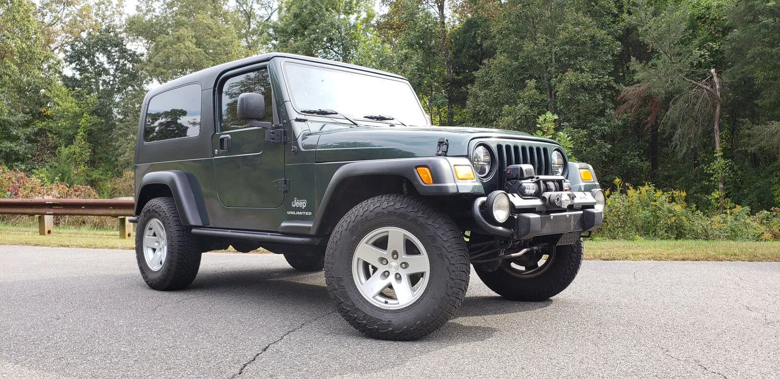

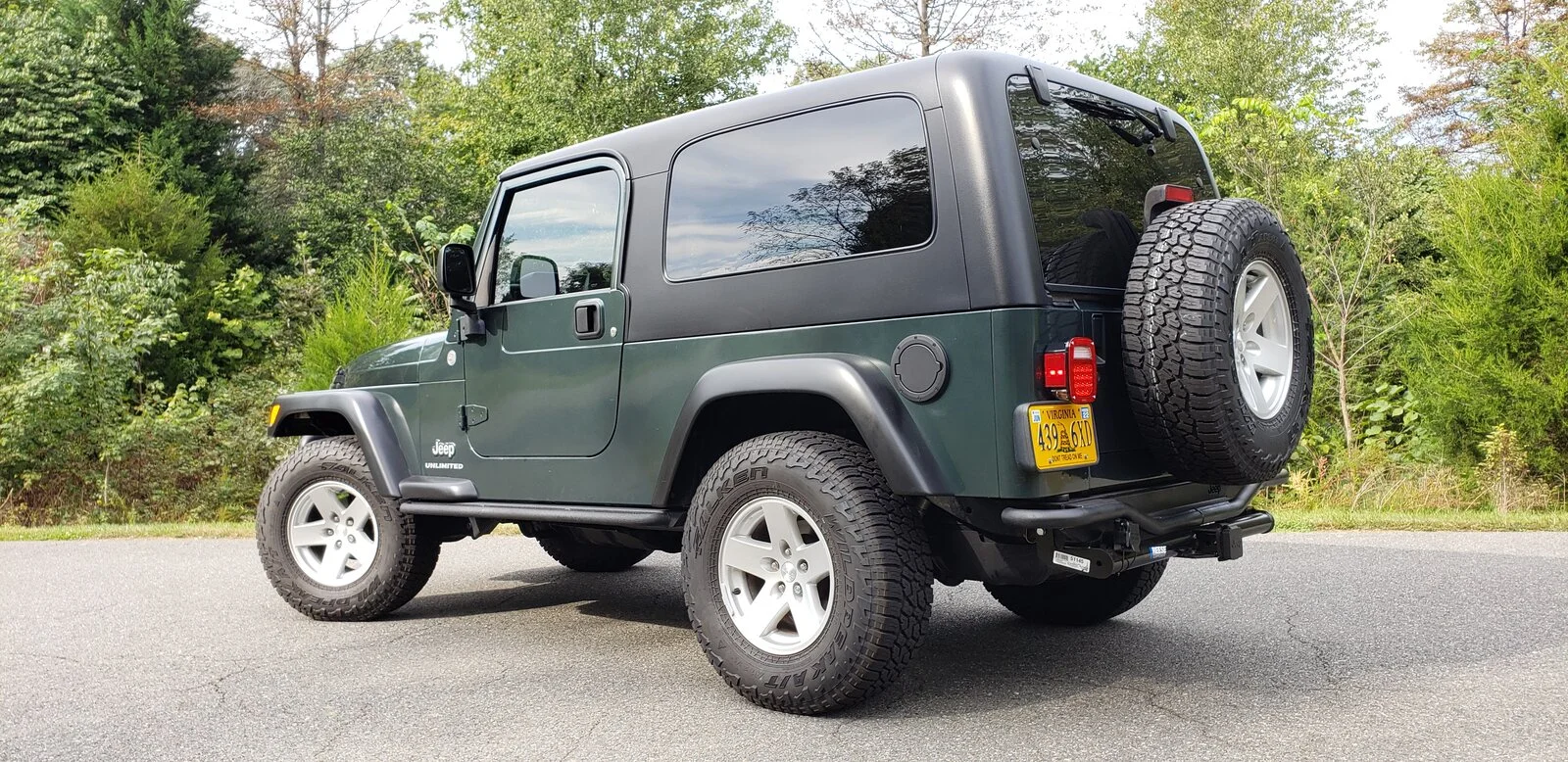

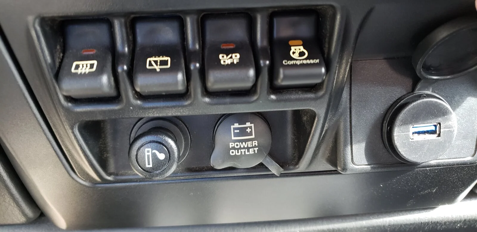

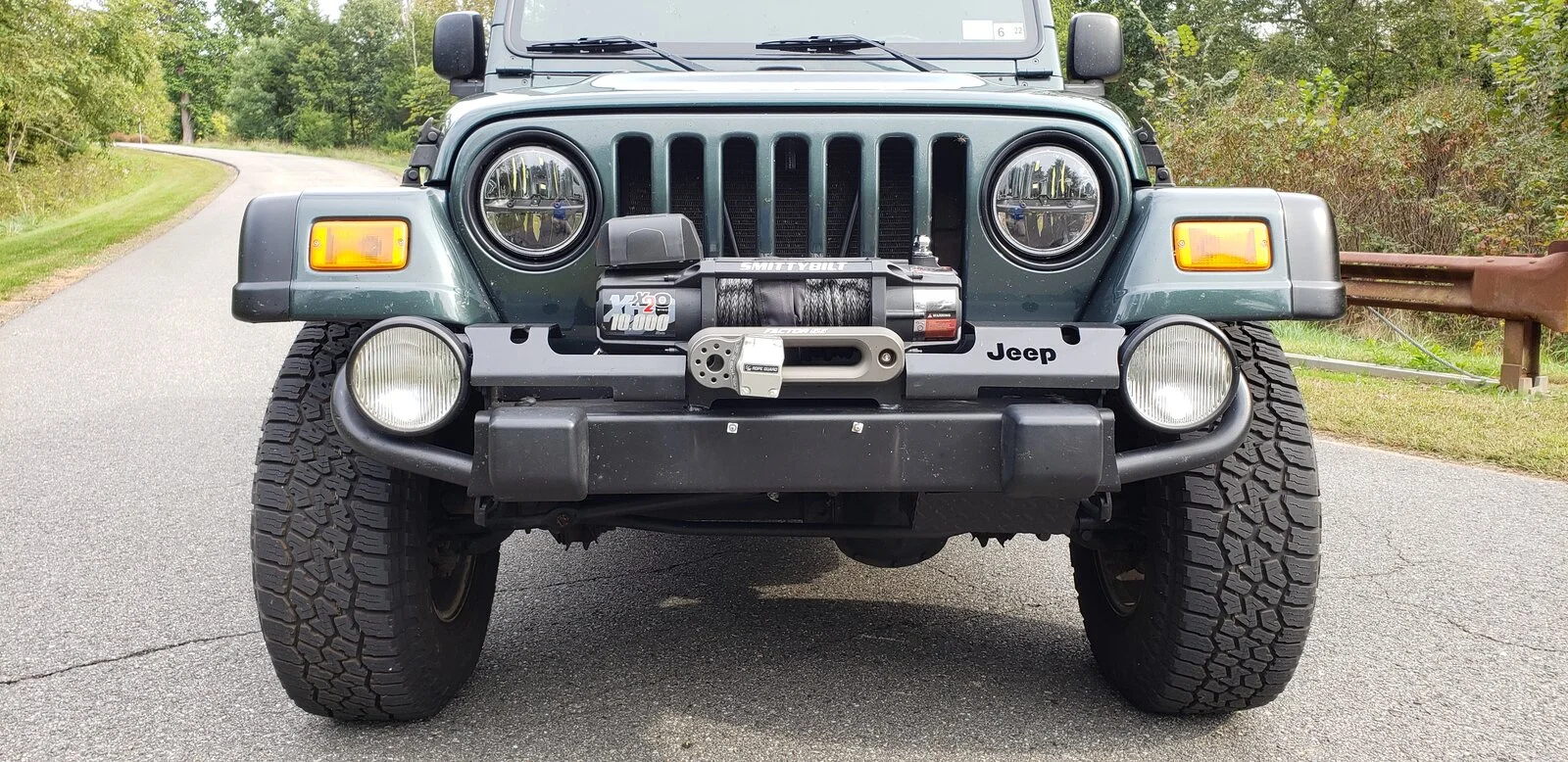

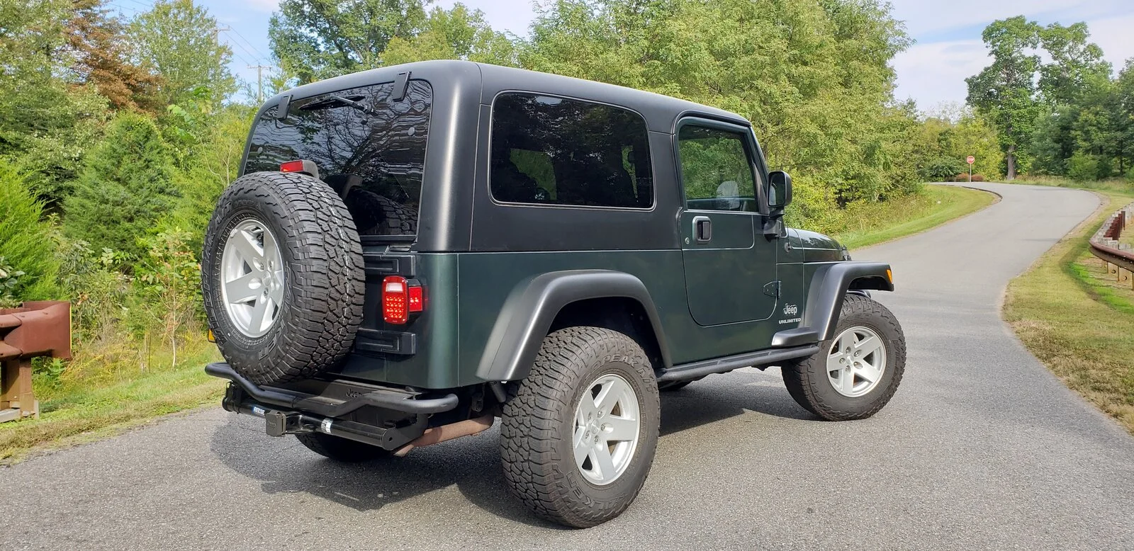

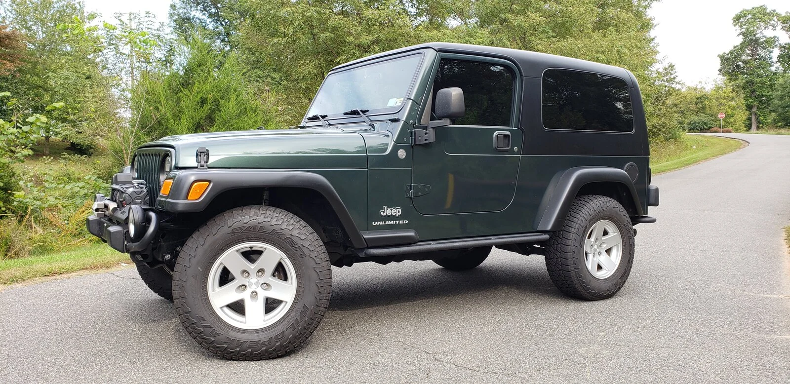

This one is like an unplanned child, it just happened, and I'm going to love it anyway! That said, let's get started with the details! This Shale Green 2004 LJ, one of 309, was most recently owned by another forum member @jwilson2899 (Jeff). Before that, by a Nurse in Winchester, VA. Under Jeff's ownership he made some tasteful additions that were focused on creating a comfortable daily driver. Since this was a fairly stripped down model, with a single note horn, soft top, full doors, and A/C, Jeff added the following under his ownership:
- Color matched 1/2 doors, with mirrors
- Tinted full door windows
- Hard top, headlined and wired in for the wiper and defroster controls
- Factory Cruise Control
- Rubicon flares

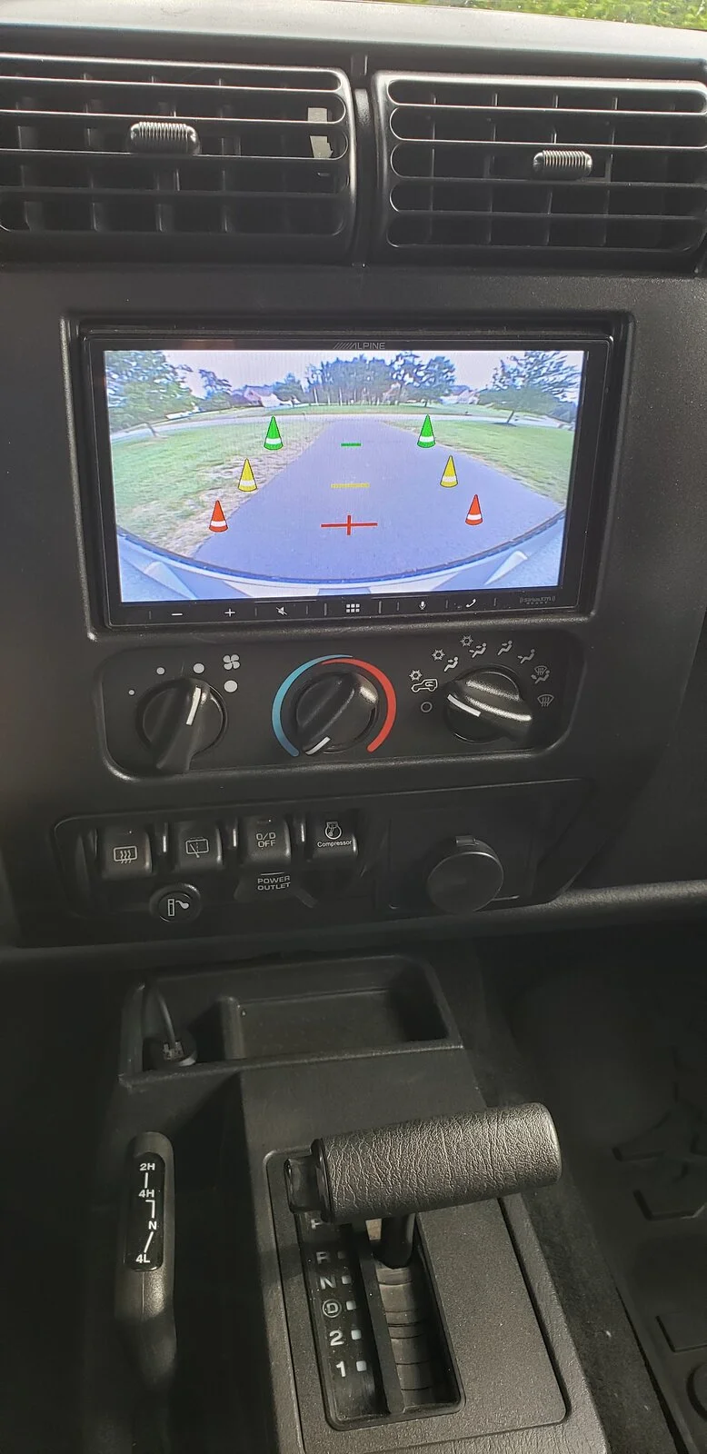

- Alpine Double DIN Stereo and backup camera
- Subwoofer
- LED headlights and tail lights
- LED dash and interior lights
- JK-based (I think?) back seat, with built-in headrests

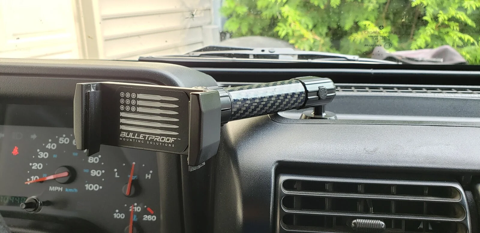

- BulletPoint cell phone mount
- Bartact front and rear set covers
- Quadratech floor and cargo mats
- Rocker rails/steps

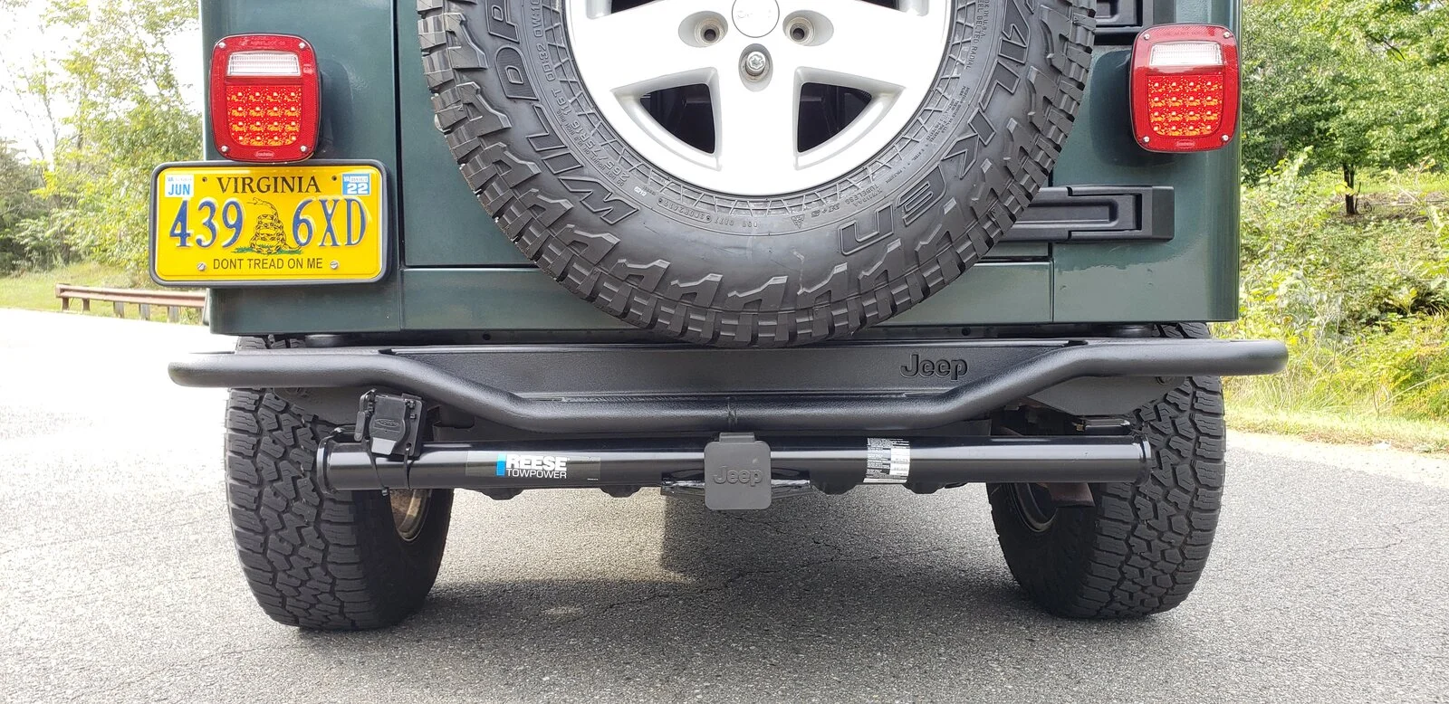

- Mopar AEV RockCrawler Front and Rear bumpers
- Smittybuilt 10k Winch with Factor 55 Fairlead and Flatlink
- 2" lift
- Sock Moab wheels
- Falken Wildpeak AT3 tires 265/75R16 (SL)
- ZJ steering upgrade

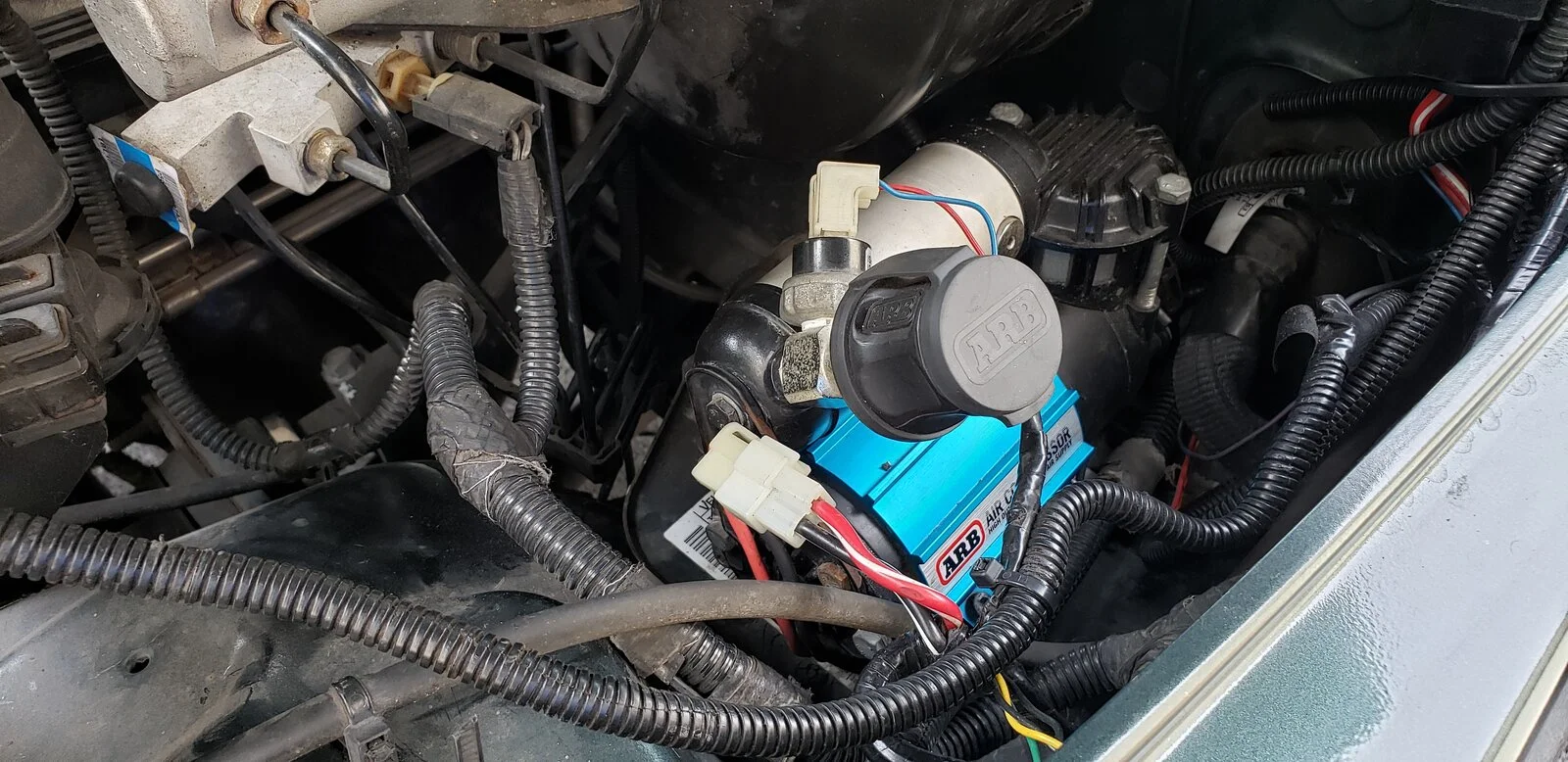

- Single ARB compressor (under the hood)

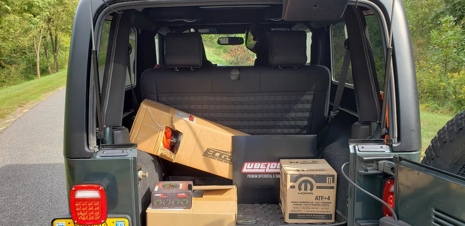

At sale time, Jeff also included a few uninstalled parts, including:
- Parts for adding a transmission cooler and temperature gauge
- East Coast Gear Supply 4340 rear Dana 44 axles

That said, I've ordered the first set of parts, to include:
2004 JEEP WRANGLER 4.0L L6
CONTINENTAL66692Radiator Hose
CONTINENTAL62394Radiator Hose
CONTINENTAL64418Heater Hose / Pipe
CONTINENTAL64419Heater Hose / Pipe
CONTINENTAL49256Belt Tensioner
CONTINENTAL49039Idler Pulley
FEL-PRO35630Thermostat / Thermostat Housing / Water Outlet Seal
GATESCO34741Thermostat Housing / Water Outlet
STANT45359Thermostat
STANT10334Radiator Cap
MOPAR5503 7653ABRadiator
OMIX17105.12Fan Clutch
MOPAR5012366AFWater Pump
THERMOCURETC001Coolant System Rust Remover
RED HOUND ‎2946079Valve Cover Grommet
DORMAN47128PCV Rubber Hose Connectors
FELPRO45458Timing Cover Gasket Set with Repair Sleeve
Order # 144016717
MELLINGM167HVSHigh Volume Oil Pump and Screen
FELPRO35629Water Pump Gasket
DORMAN47079PCV Elbow (Back of Valve Cover)
DORMAN47057PCV Elbow (Front of Valve Cover)
DORMAN56398Water Pump Inlet Tube
CLOYES90385SATiming Set
SKPSK594018Harmonic Balancer
What I'm struggling with, a little, is the water pump. I've installed several Gates 42293 water pumps recently. The last two were made in USA and had metal impellers. The later isn't a deal breaker, if it is plastic, but I do like the Made in USA piece. However, I'm getting mixed information on the new pump. My plan is to just order it and, if needed, return it.
