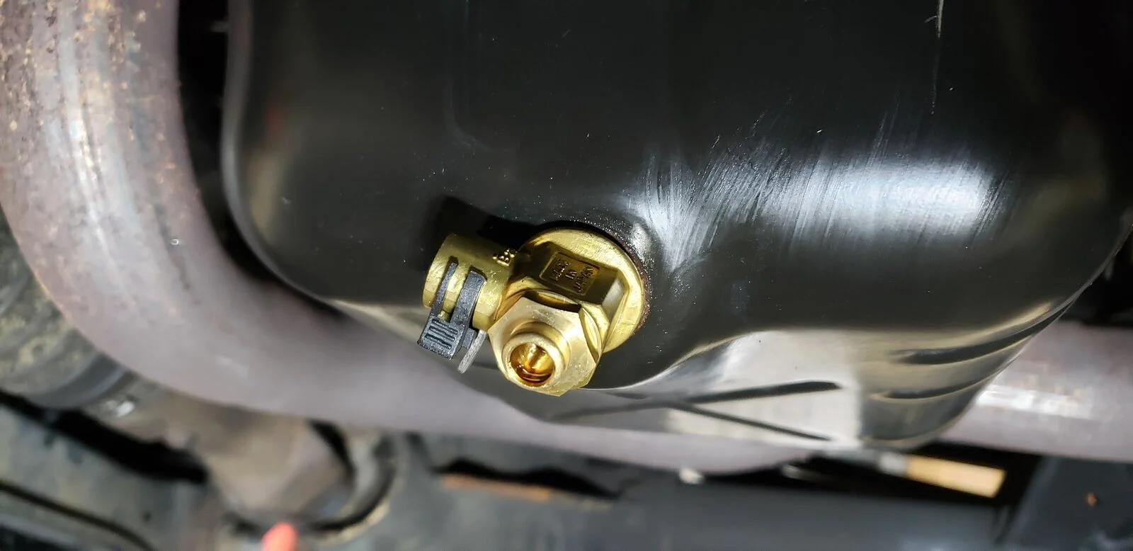

Fumoto F101S LC-10 Lever Clip FS-Series Engine Oil Drain Valve​

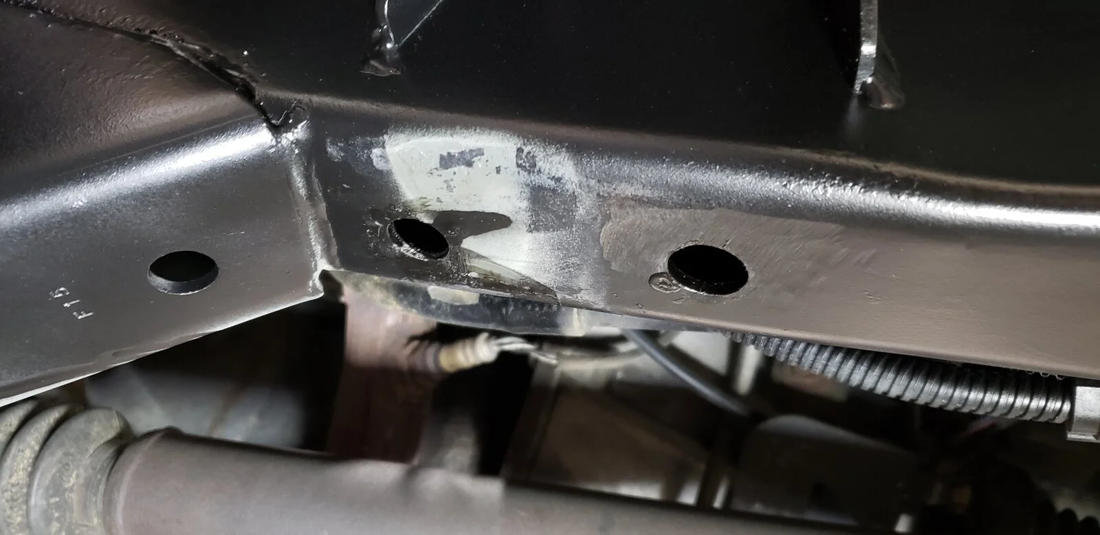

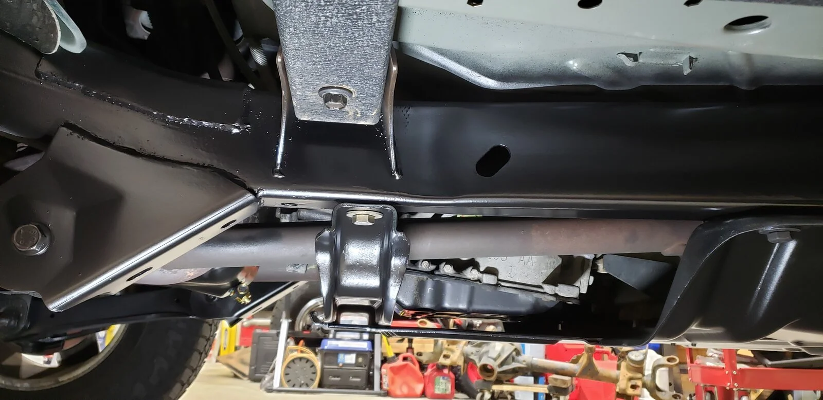

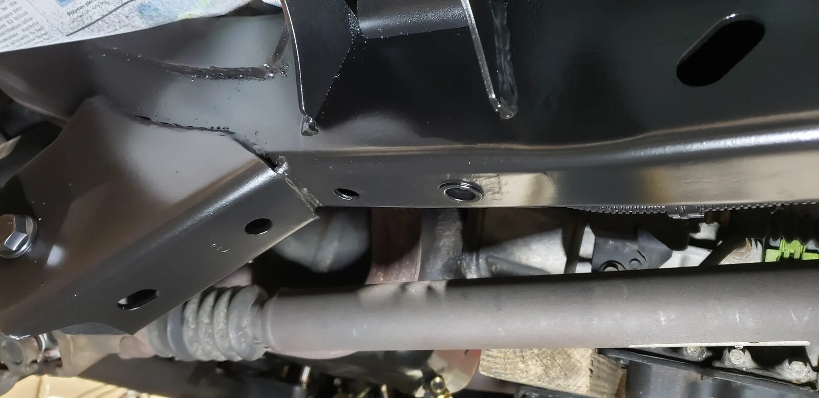

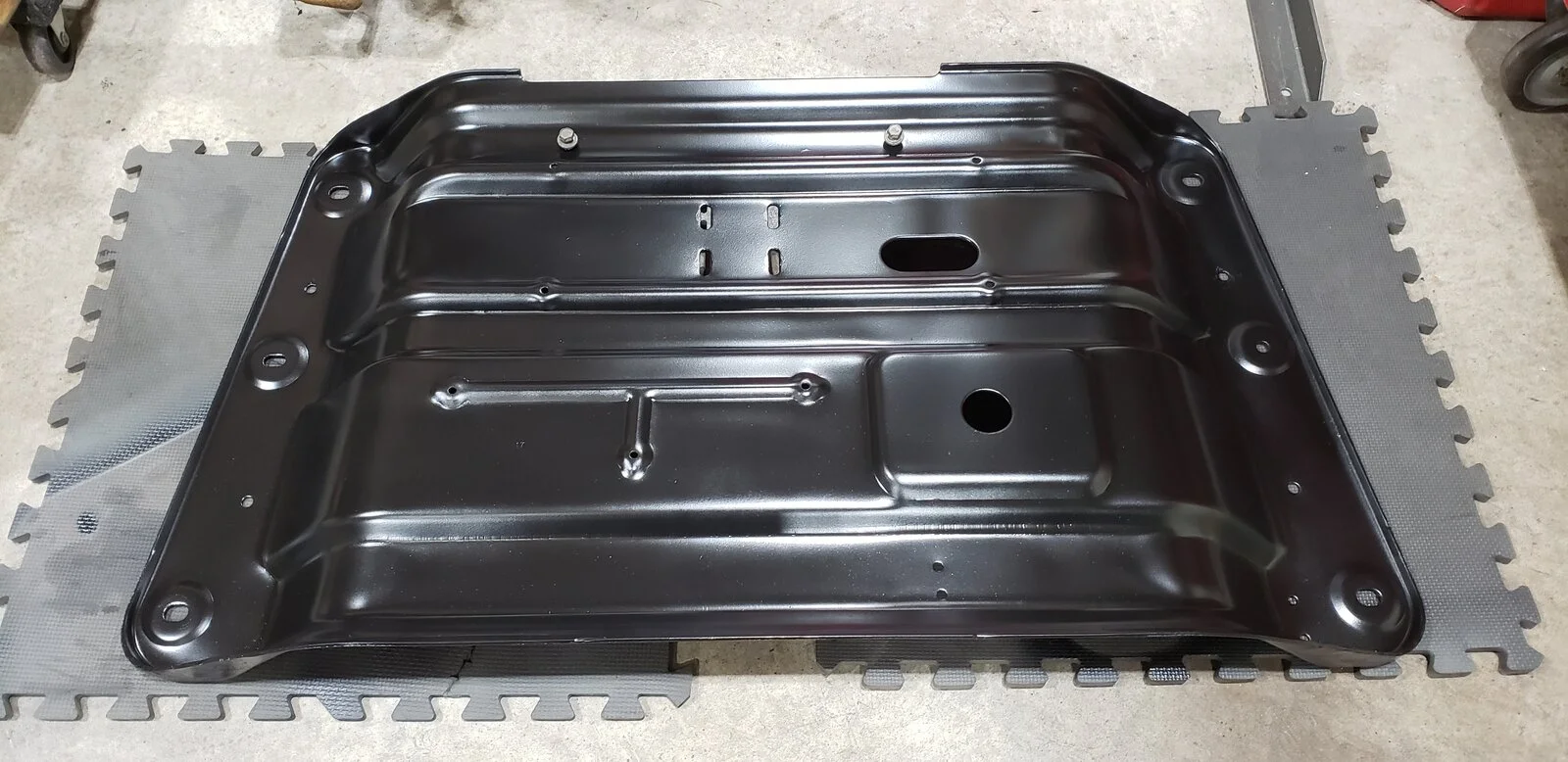

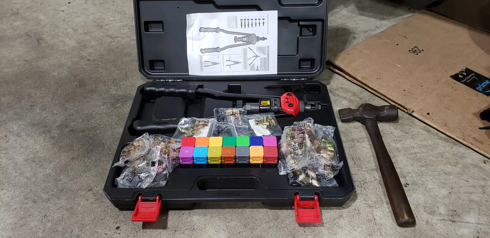

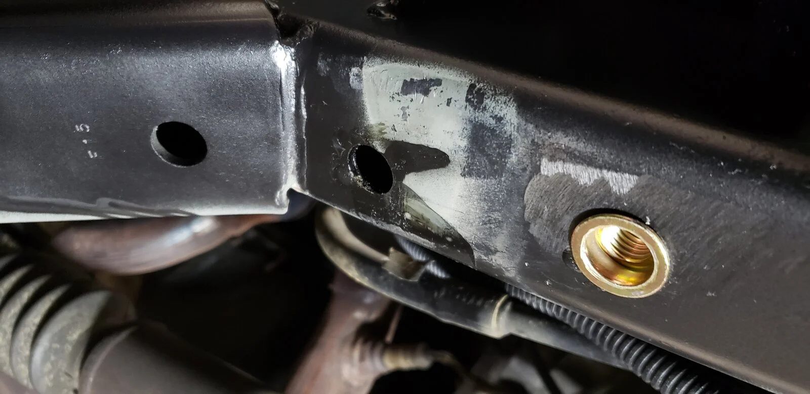

Second, was replacing the nutserts from the transmission skid. They spun loose when removing them, so they were ground off, punched through, then pulled out of the frame with a magnet. In their place went 1/2-13 nutserts. Although I have an Astro tool for installing them, I ended up buying another one. My old one is 13" and only has 6 mandrels. The new one is 16" and came with 15 mandrels, along with 10 nutserts for each mandrel.
https://www.amazon.com/gp/product/B07VRLL8KX/?tag=wranglerorg-20

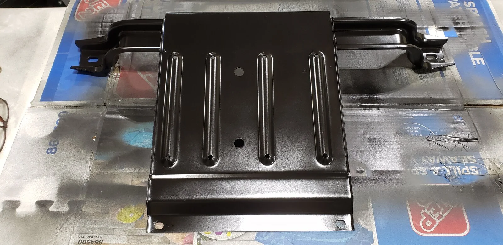

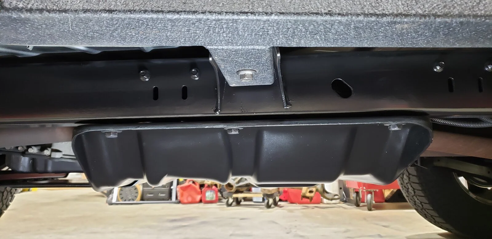

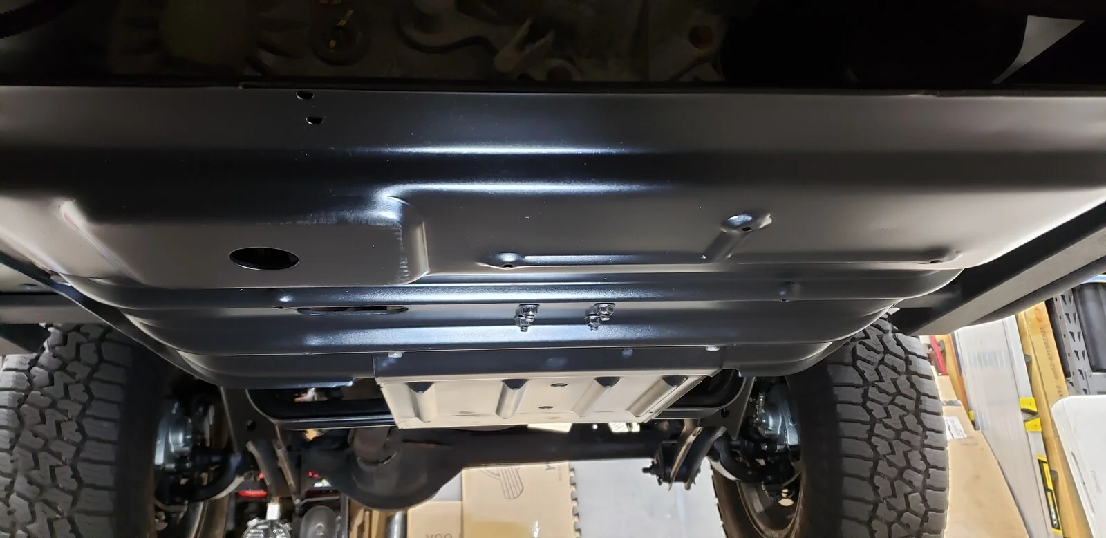

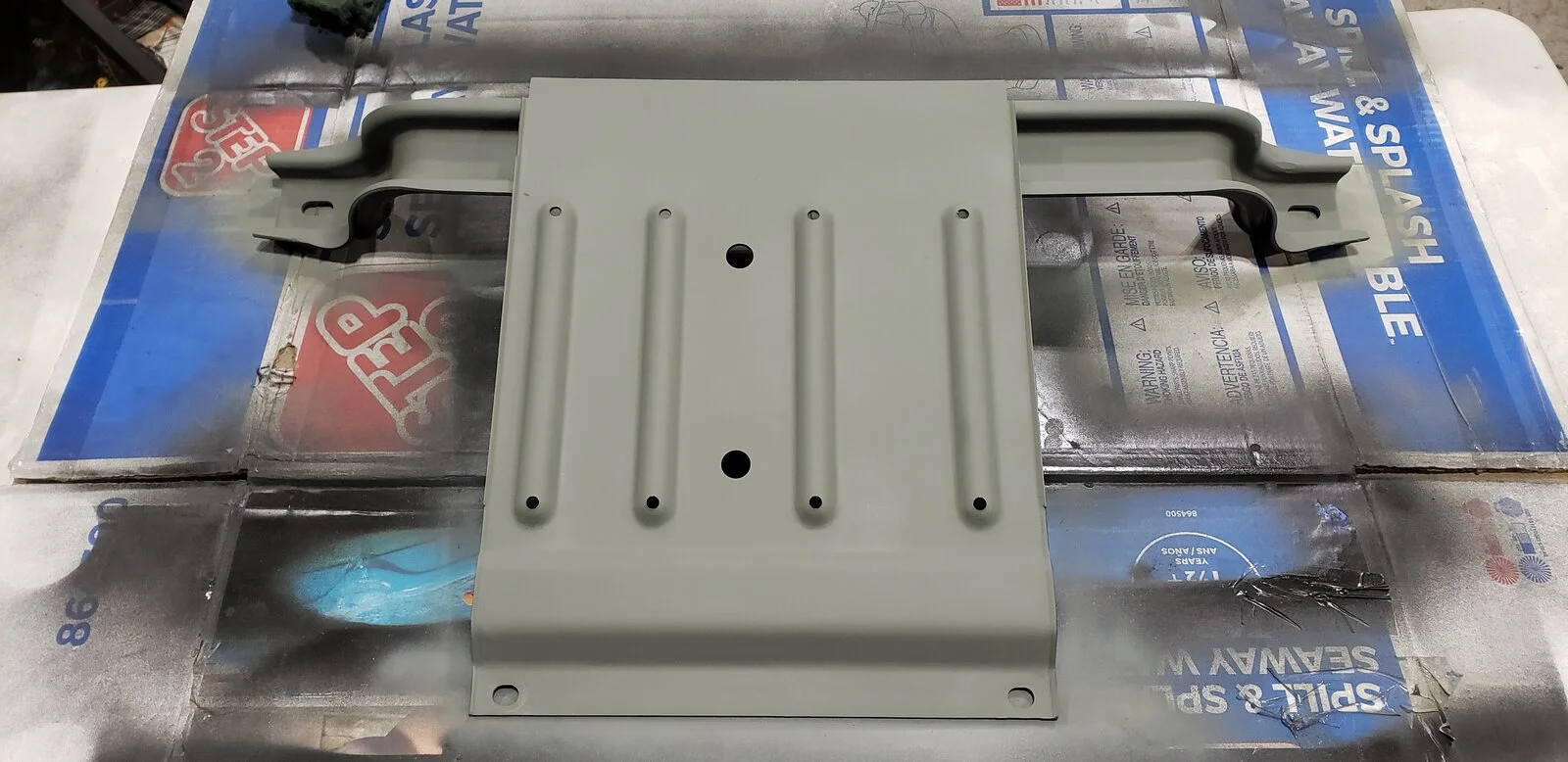

Last, the transmission was supported and the transfer case skid removed. Underneath the skid was the only place on the frame I didn't get to. It is now done. Since getting a Savvy UA anytime soon doesn't look likely, I also cleaned, sanded, primer coated, and painted the stock skids. I'll run those, until I can get a Savvy UA.
As @psrivats said, oil changes are supper easy. Remove the plastic locking tab, flip the lever, and the oil pours out. When it's done draining, flip the lever back and re-insert the locking tab.
I got the Stahlbus for mine. Curious if you considered it and what made you choose the Fumoto. When I looked at them, I liked the design of the Stahlbus better but I think both are equally good functionally. I actually started changing my own oil after I got this since it is so damn easy now and no mess whatsoever.
Reactions: Irun
If it wasn't for the fact that I already had a new Fumoto valve, I would have gone with the Stahlbus. Even though the Stahlbus costs more, they are more compact than the short Fumoto I used. That alone makes it a good choice. (y)
