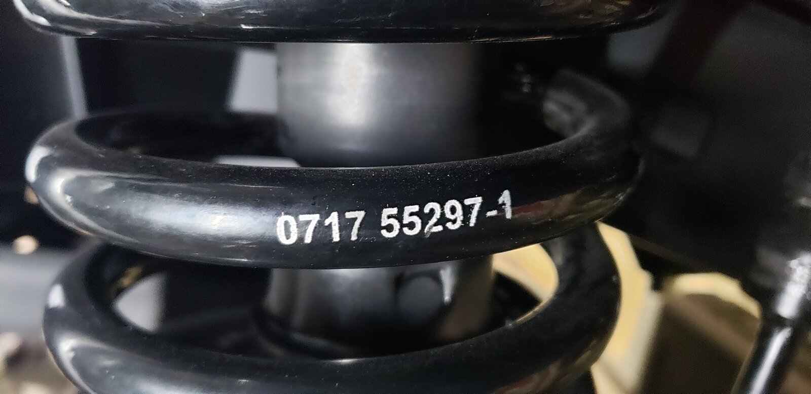

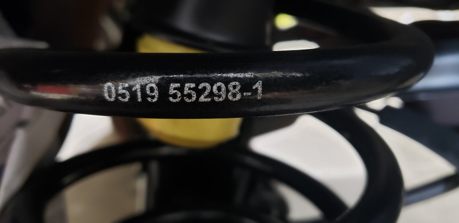

Can anyone verify if these springs are BDS? I did a search and could not. What I did get was ProComp matches on 55298 and 55297.

I have BDS rear springs but I don't recall there being any numbers marked on them like you show. I'll take a closer look this evening and let you know.

My BDS springs do not have any numbers on them. It makes the most sense that you have pro comp springs as they match their part numbers.
Yup, I checked mine, no markings on the BDS springs.
From back in the early 200''s ProComp springs were sought after as a decent spring. It was the rest of their suspension system that sucked.

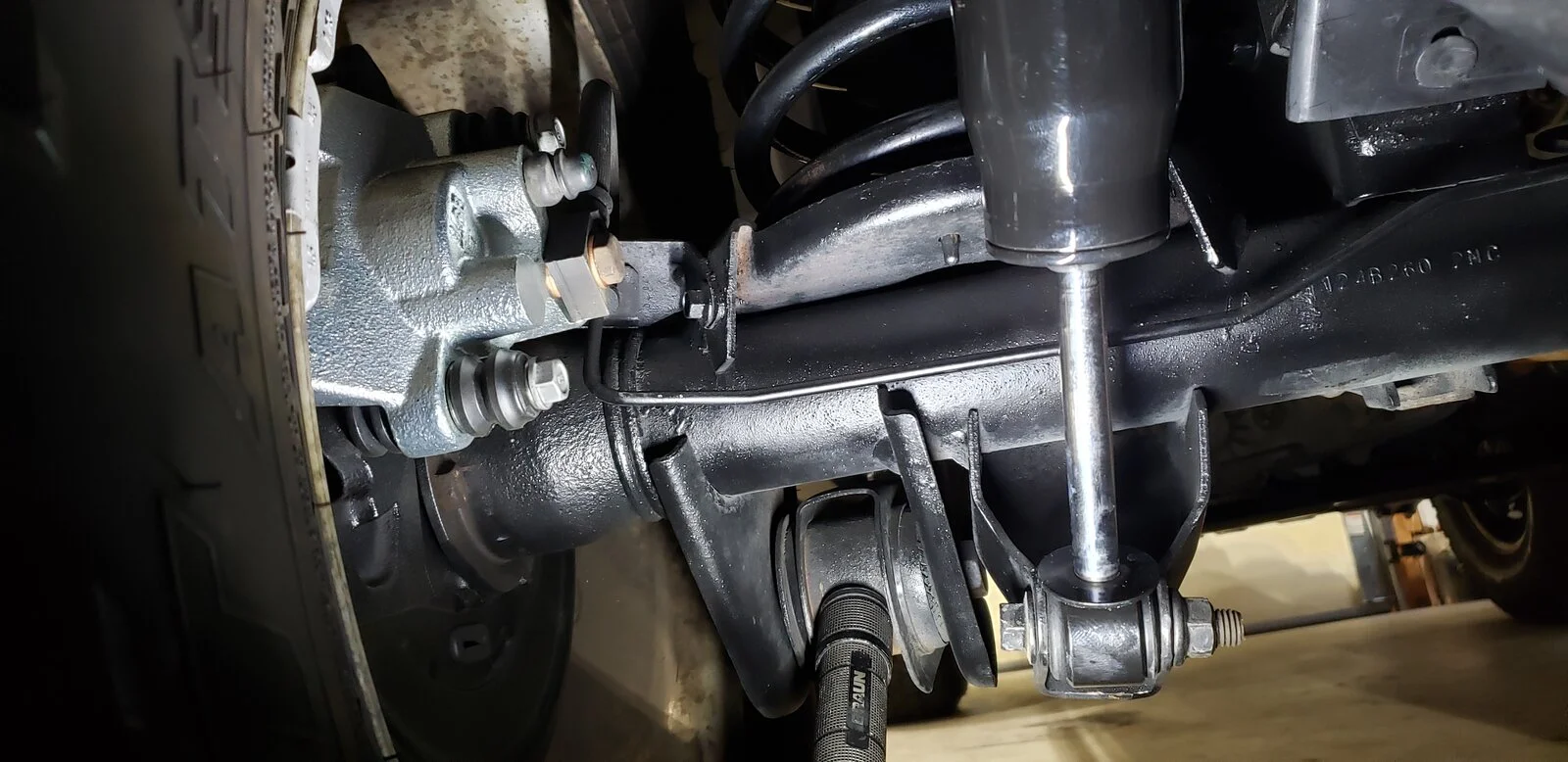

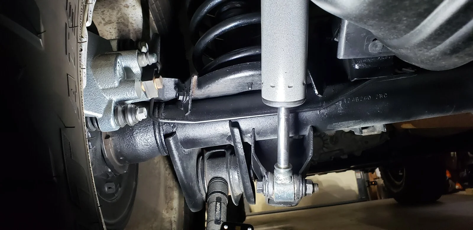

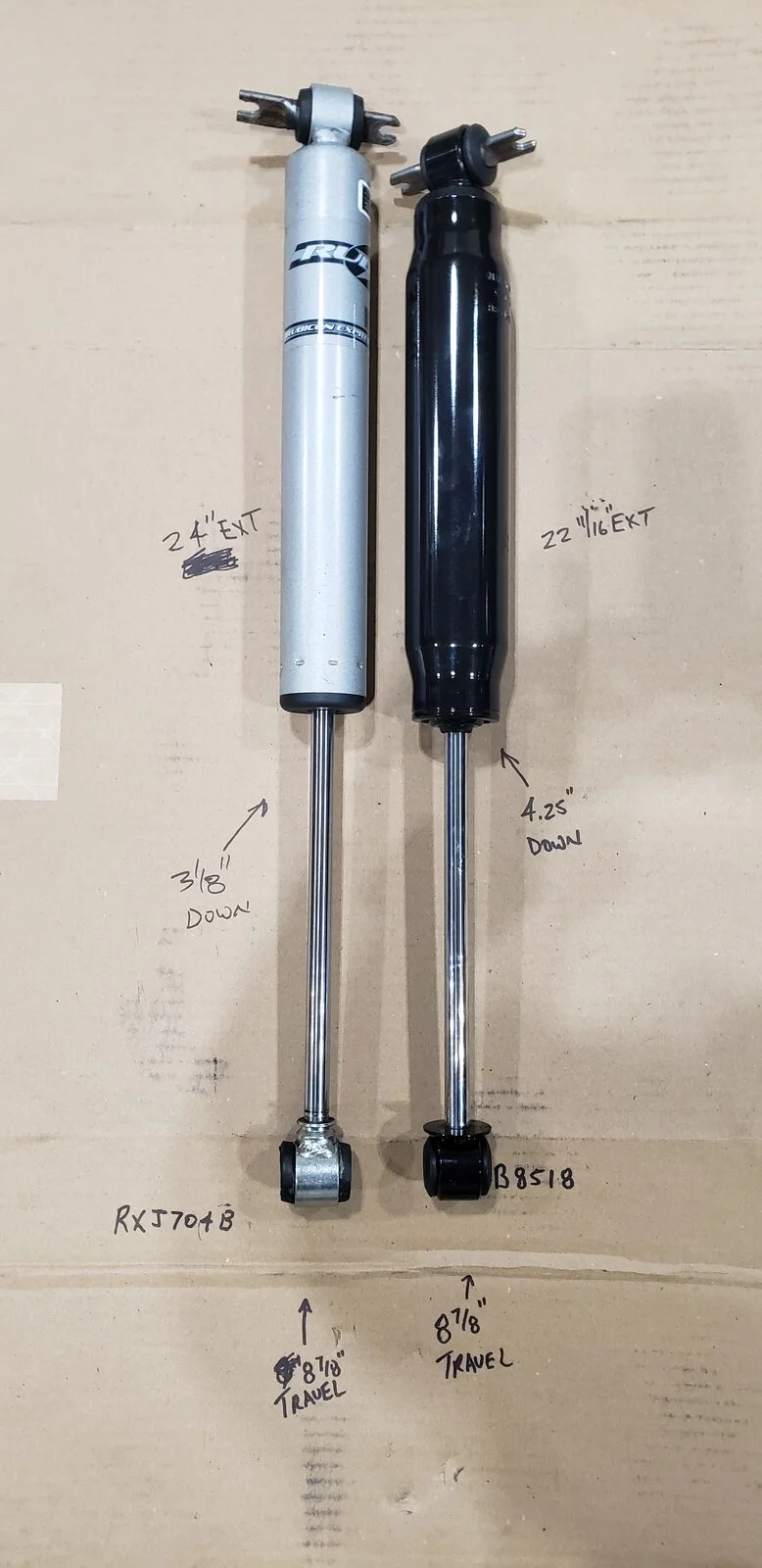

Finally got around to replacing the Rubicon Express shocks. They list these, RXJ704B, as a fit for 2 - 3.5" lift. There's no way they'd work with a 2" lift, unless of course you want 3 1/8" up and 5.6" down travel. Switching to the BM B8518 balances the suspension out much better, at 4.25 up and 4.53 down.
Rear Springs
Front Springs
I was like 98% sure I told you Pro Comp, but if I didn't, that's my bad. They are Pro Comp springs, I bought those on Jerry's and other's recommendation.
Shocks were supposed to be for the 2" lift as well, but apparently were no bueno.
No worries! After looking at the numbers on the springs, they're definitely Pro Comp. Those will do the trick for my use. The shocks on the other hand had to go. I'm hoping someone local will buy them! (y)
Can you run the can up on these skyjacker shocks?
