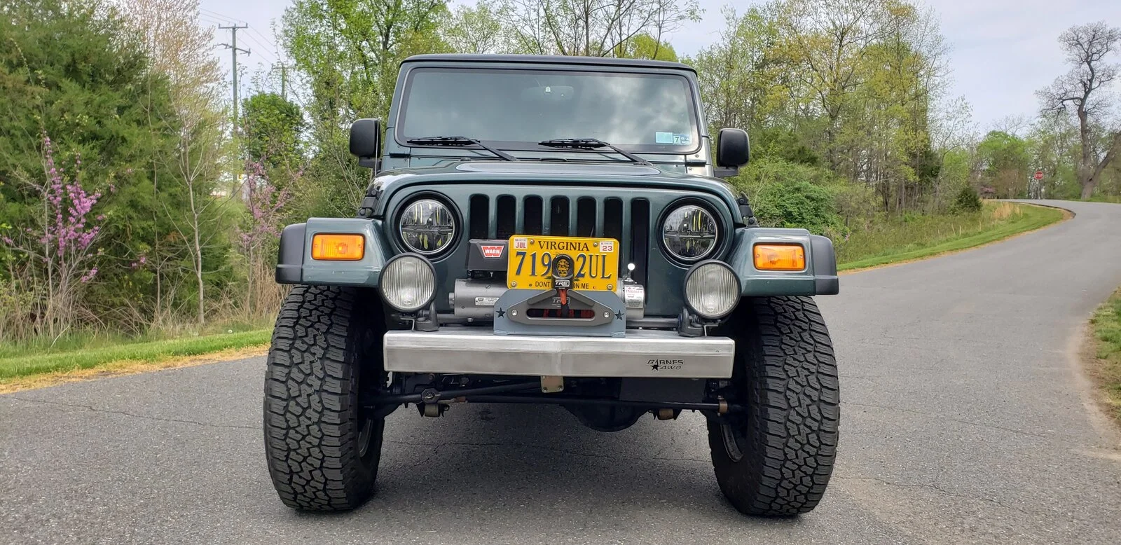

I really despise the front license plate requirement in some states, though I do understand it’s purpose.
You’ve done the best that can be done to keep it out of harms way.
That's the purpose. I've mangled more that one license plate when they're mounted to the bumper! ;)

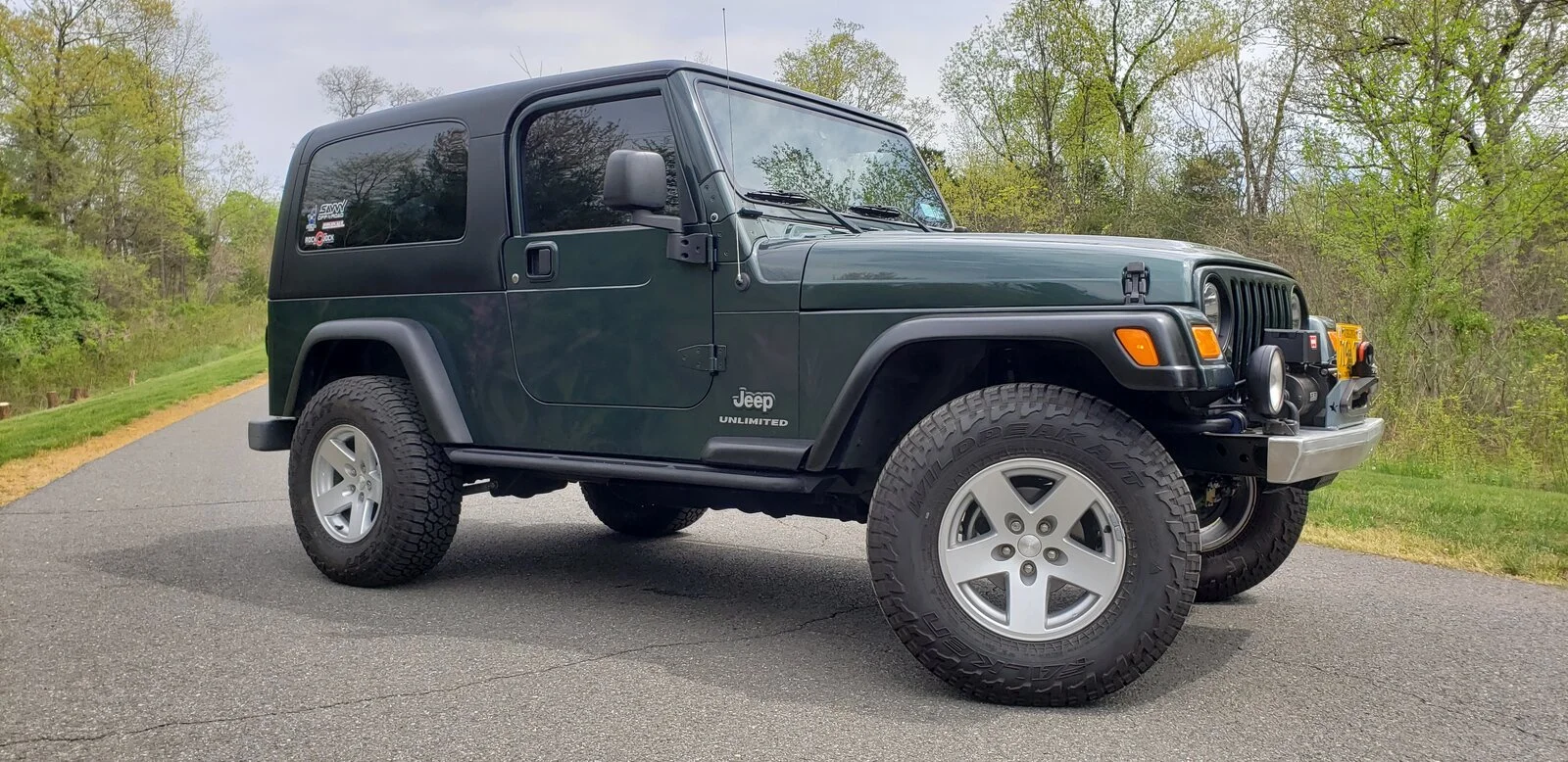

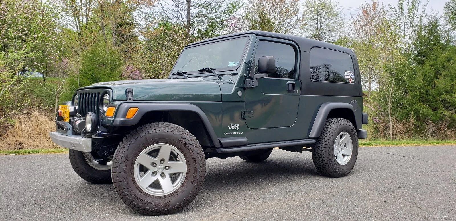

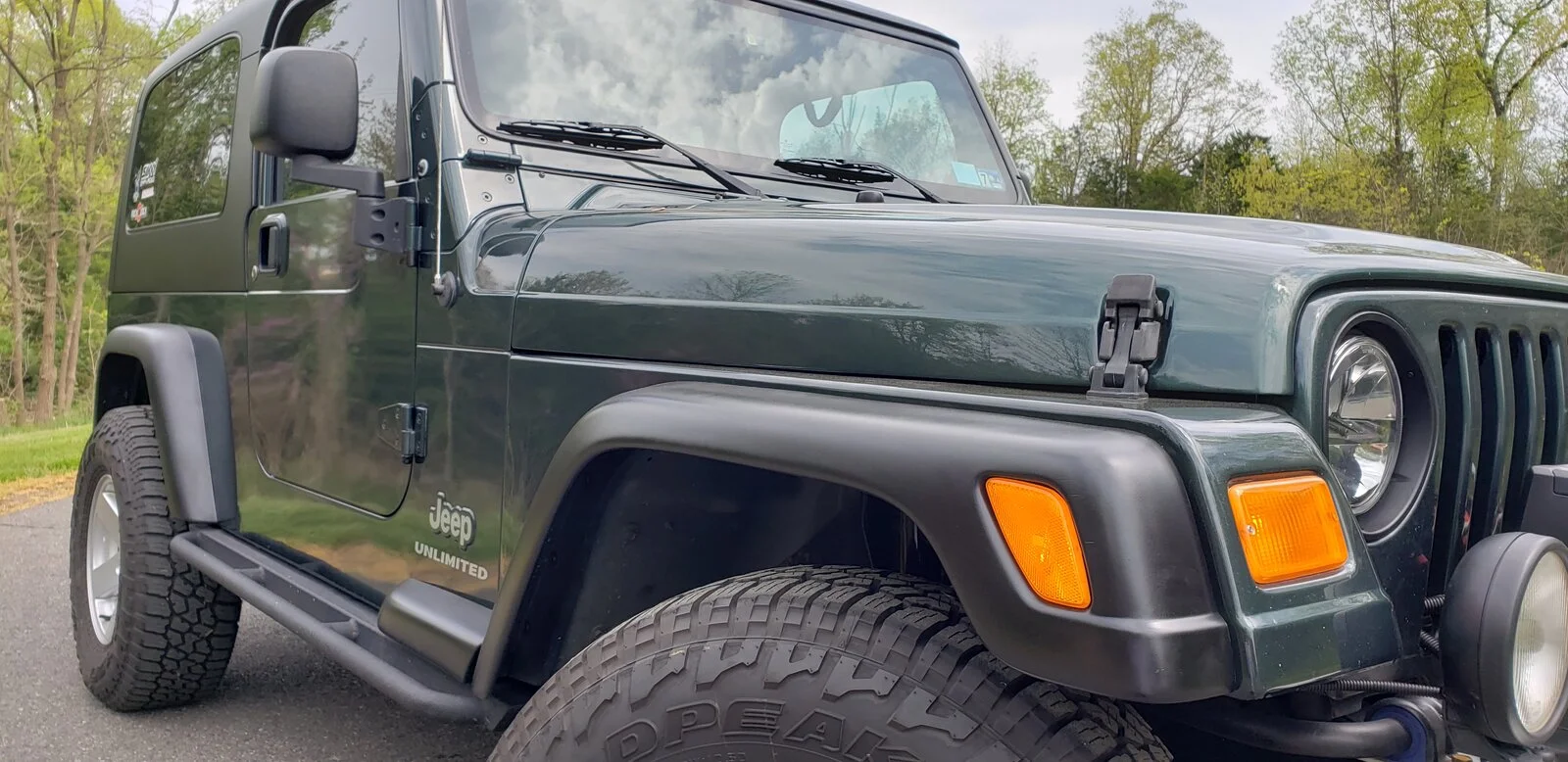

Did more detailing on the Jeep.

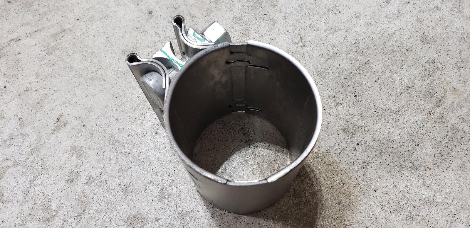

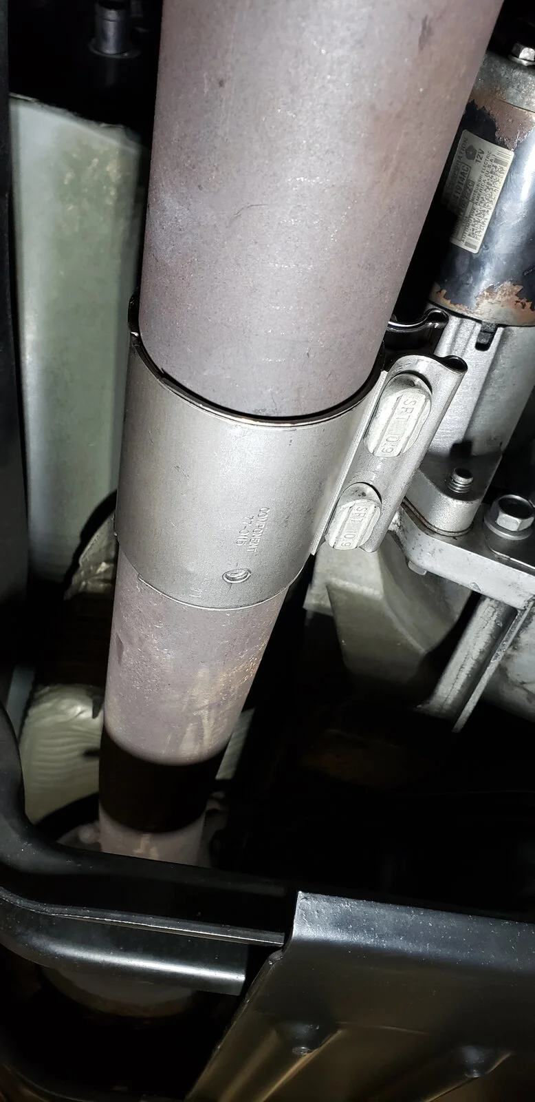

While my buddy was over today, I also had him remove the temporary cheap "Made in China" 2.5" OD butt clamp that was installed on the cut down-pipe. In it's place went a Walker 36530 exhaust 2.5" OD butt clamp.
If anyone else ends ups cutting their pipe, to make doing the RMS and oil pan gasket replacement easier, this is the clamp to use. I ordered several other clamps, including a Walker 33240. However, the 36530 clamp is far superior. The primary reason being, it has two clamps, an inner and outer, resulting in a stronger and tighter seal.
Do you achieve proper seal with this one? No exhaust leaks?

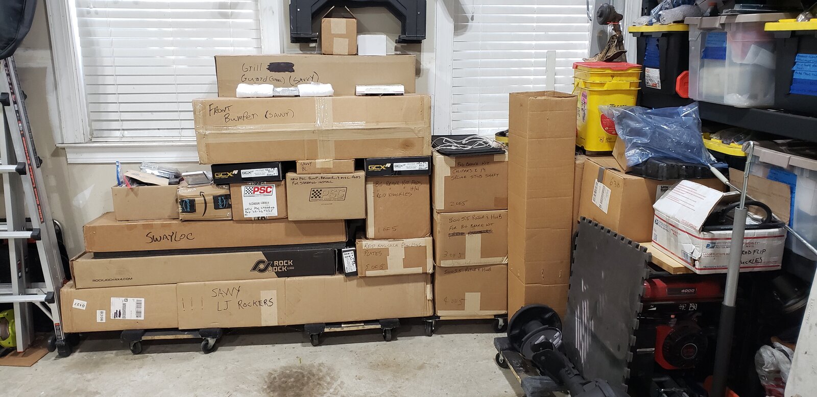

1 tons, 40's and a Hemi swap?
Don’t forget the 4-speed Atlas!
If you’re all in, you’re all in…
