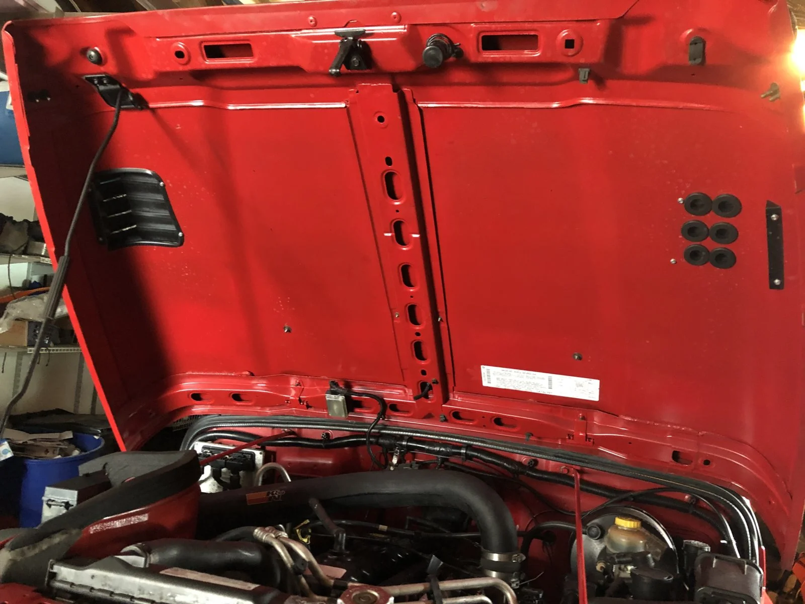

Where did you find that hood, I love the louvers on the side?
you got it! Daystar was also really cool as one of them cracked when i tightened it and they sent one out right away. I did also modify my install as those hood vents that come with 3 grommets per vent and the instructions are to drill 3 holes per vent so heat escapes and water doesnt fall in. I changed mine so one of them feeds my K&N cold air intake thats blocked off from the engine heat with home AC foam. i also made a piece of aluminum that hooks on the nose brace bar and prevents water from contacting the air filter. from a hose or something as it is protected with a plastic edging around the hole cut in the hood.
