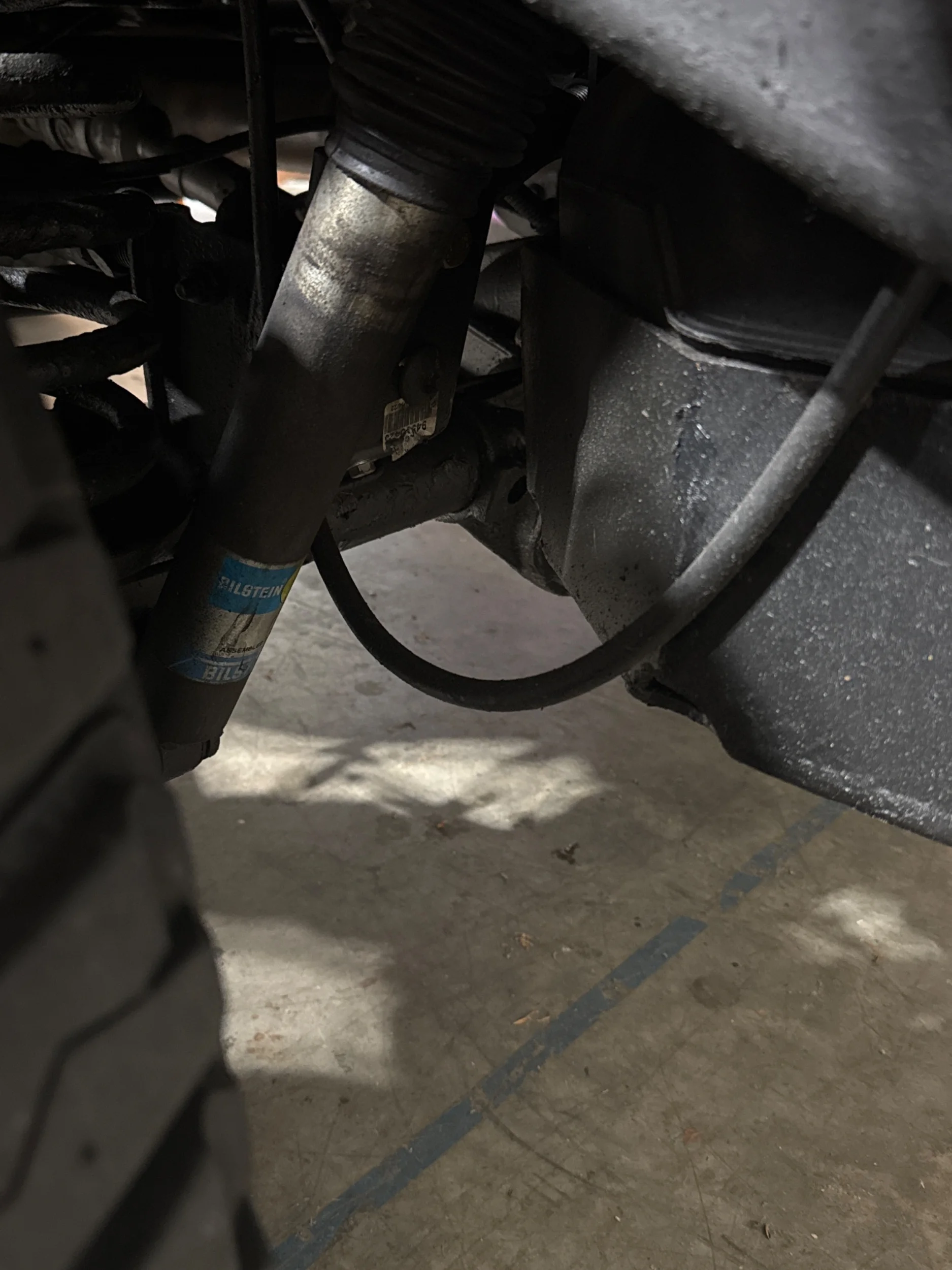

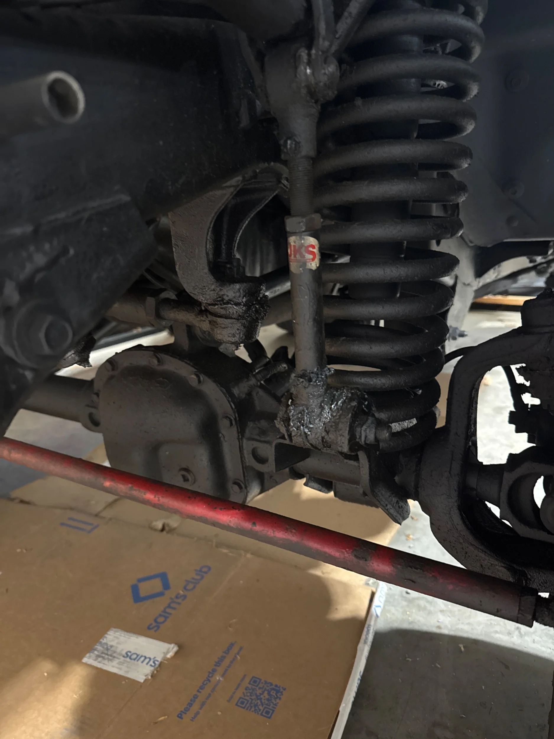

How much shock shaft is showing at ride height?

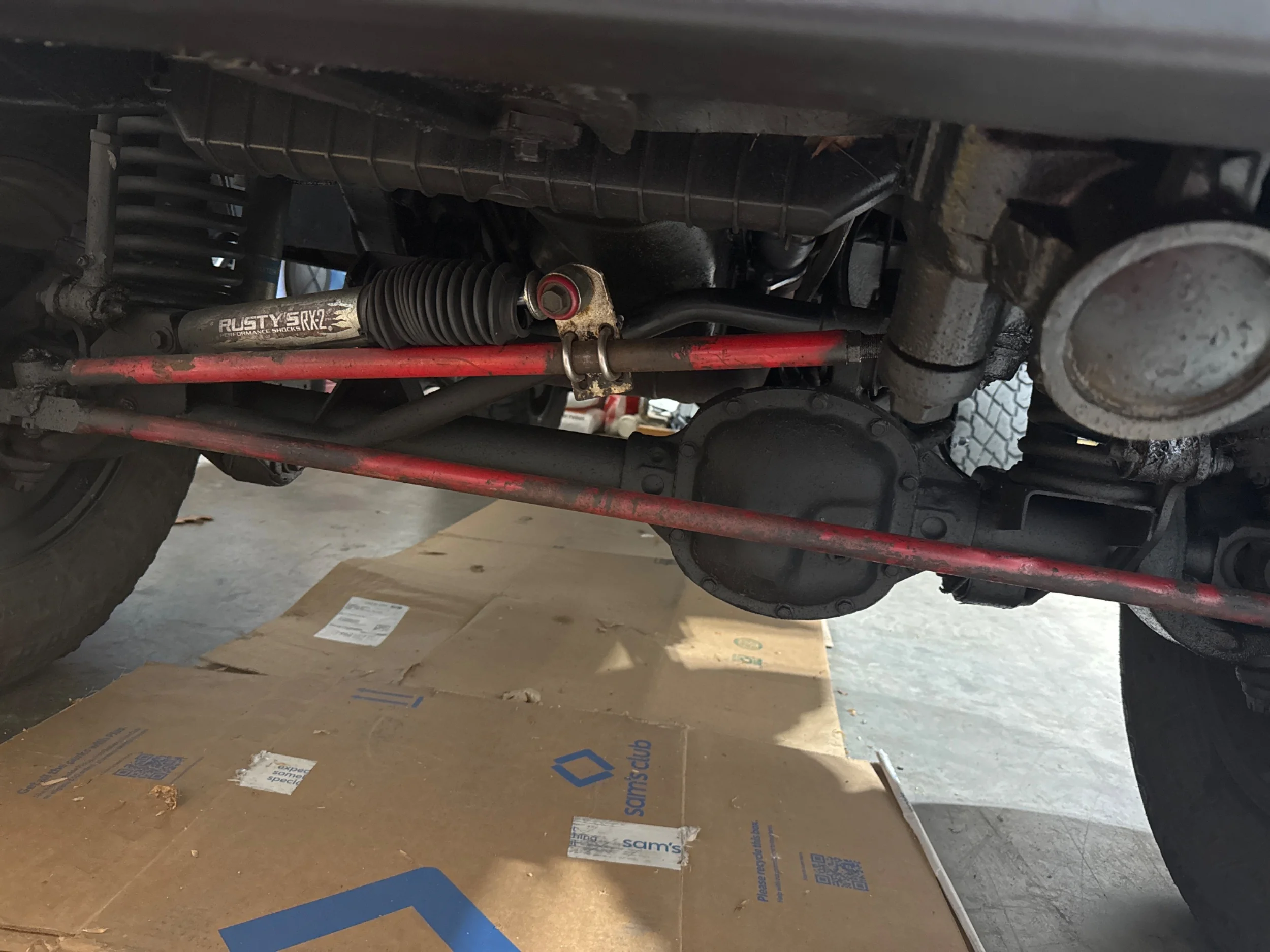

Flip the draglink stabilizer mount around. The bolt goes behind, U-bolts go behind.
Inverted T is crap steering, get rid of it and go to inverted Y or the stock style.
