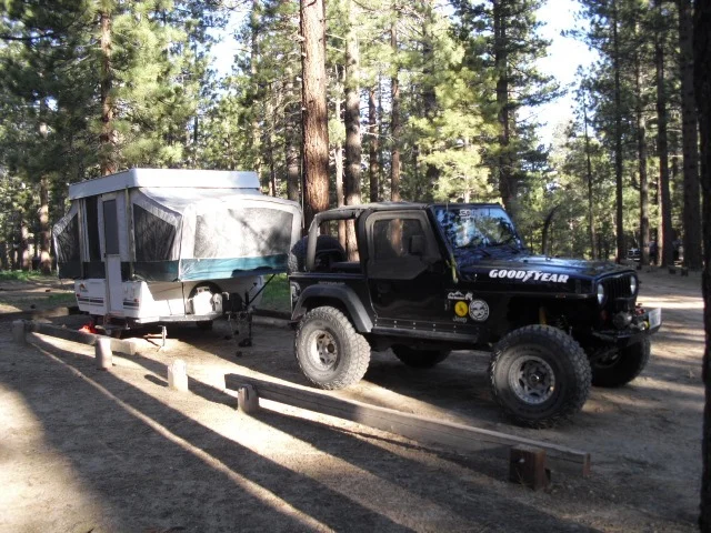

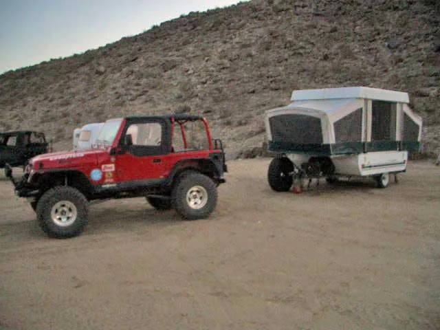

This is my Fleetwood Taos with my previous red and current black TJs...
