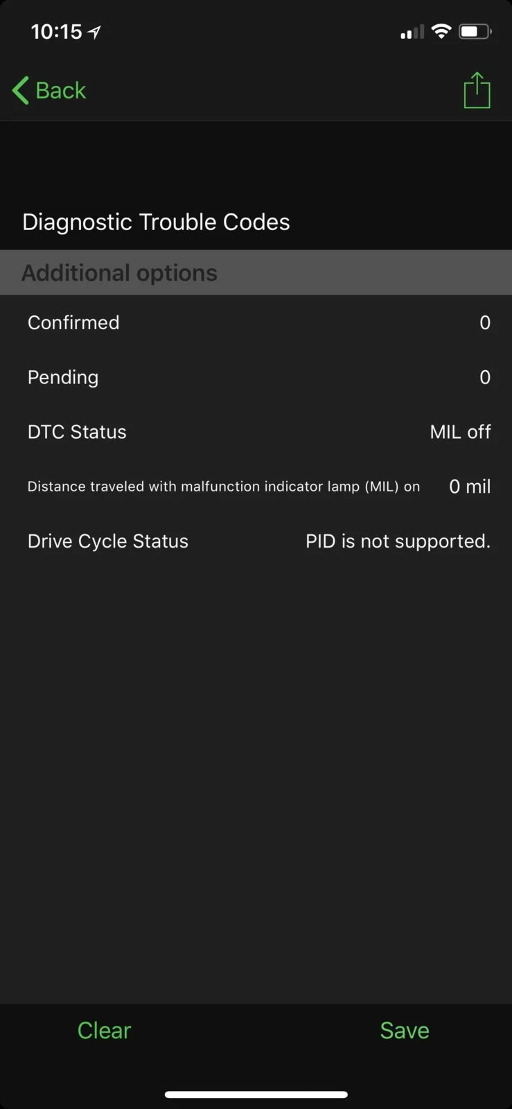

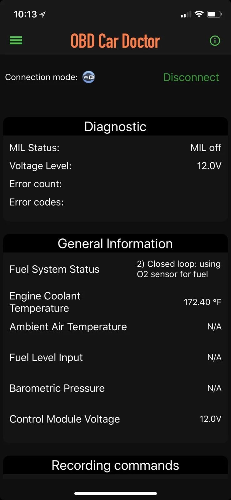

No diagnostic codes or CEL I'm pretty sure Chris ;)
