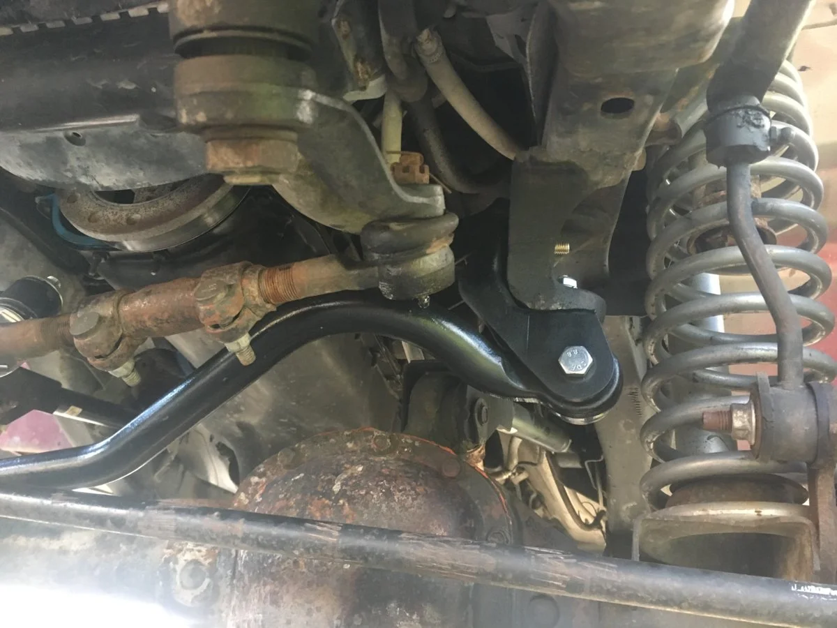

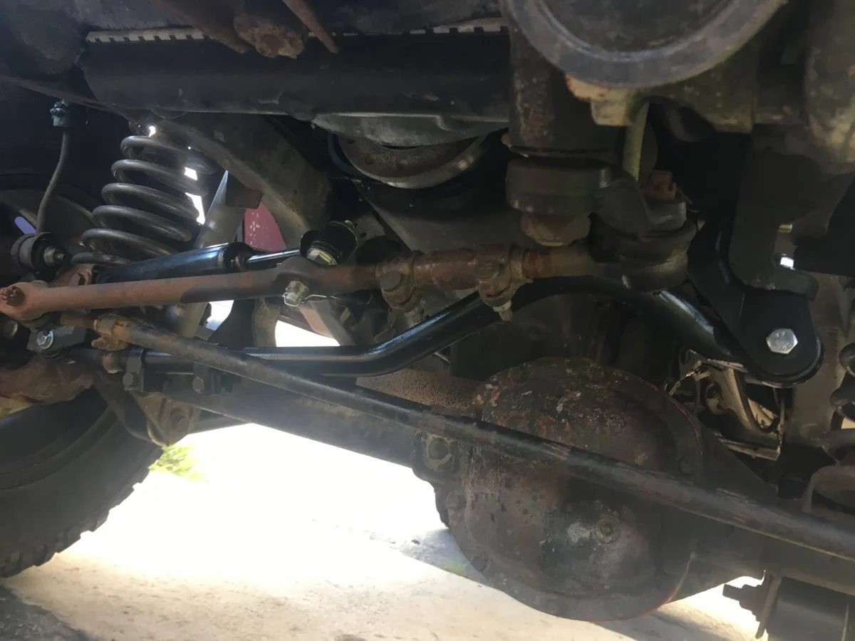

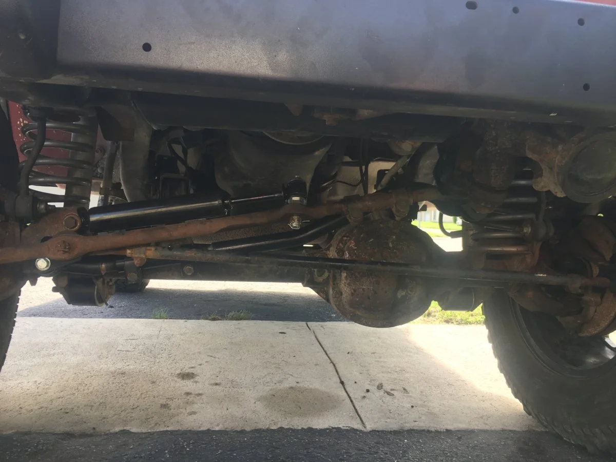

My jeep was the same way when I bought it, already had a 3”lift but same down the highway dangerous... it needed tires bad so I replaced them 33. Also installed A courier heavy duty tie rod system in the front, along with upper and lower adjustable control arms, my caster is set at 8.1 deg. (Shop did it) I can’t tell what the reading for my toe and camber is, All of this made a big difference...I could finally drive down the highway with one hand..lol
