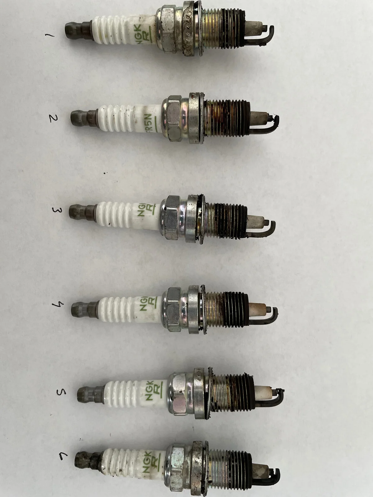

Pulled the spark plugs this morning

I'll grab a fuel pressure gauge when I head to the parts store in a little while and I'm gonna replace the spark plugs since a few of them are definitely looking rough. I'll update everyone later in the day once I've got everything swapped. Thanks again yall
Update: Jeep started up just fine. Replaced all the spark plugs and tested the fuel pressure. The pressure gauge read exactly what the book said it should, and then when I tried to crank the jeep it started right up. Thanks all for your suggestions and advice.
Hmmmmmm - I’d be real concerned as to what caused the plug fouling. IIRC - you said you had changed plugs 2-3k miles ago. Other than the crud across the spark gaps on 2, 5, and 6, they don’t look that bad to me.
You might be right back to the same issue again in another 2-3k miles.
