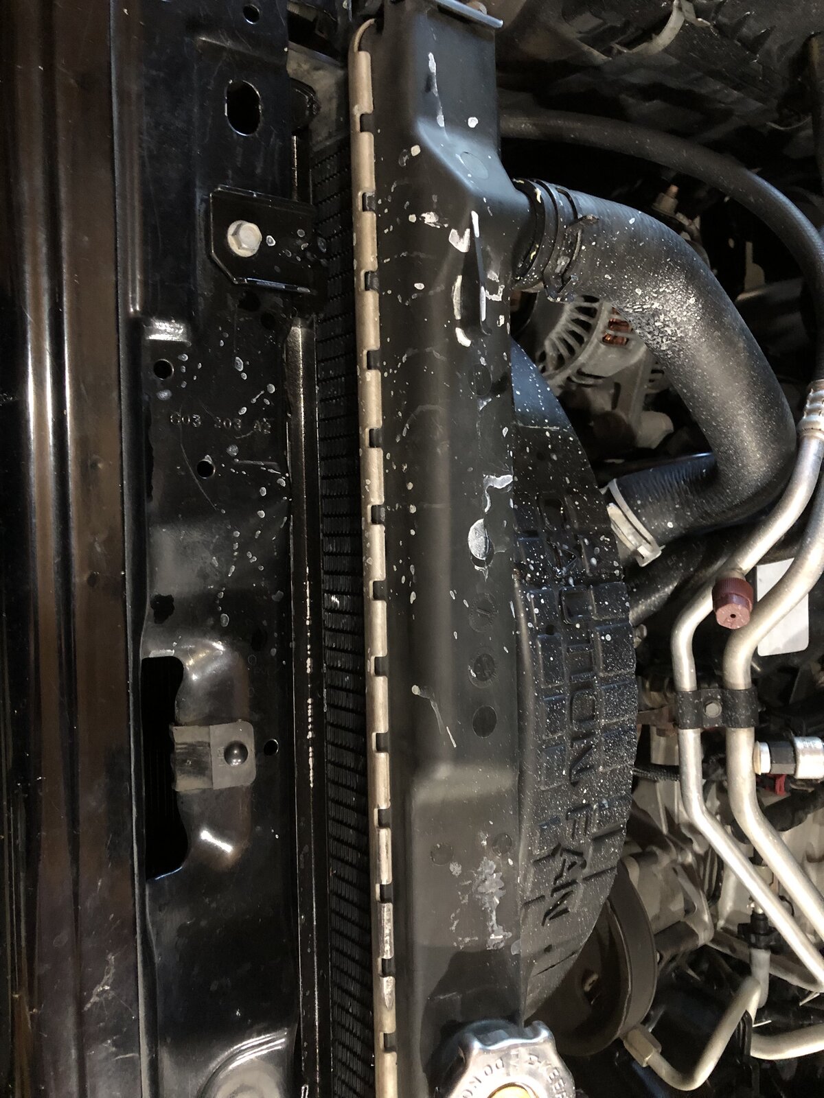

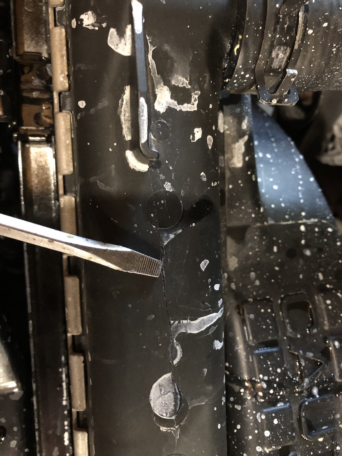

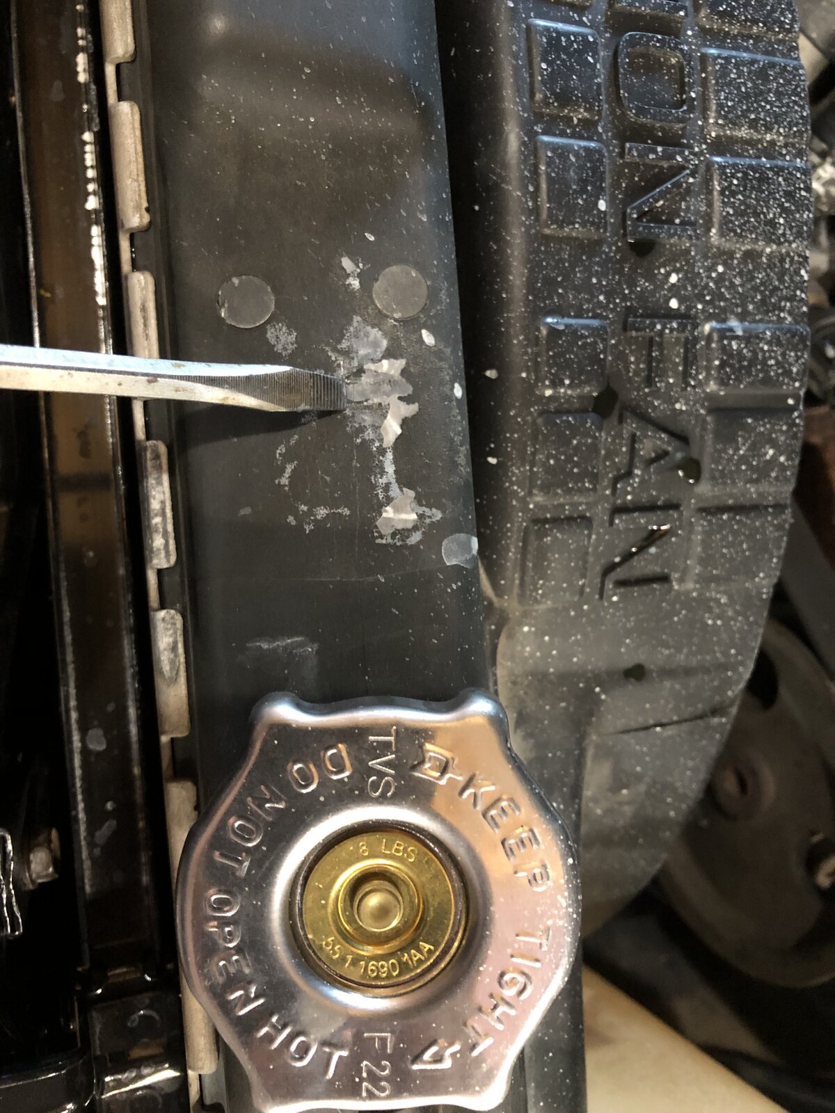

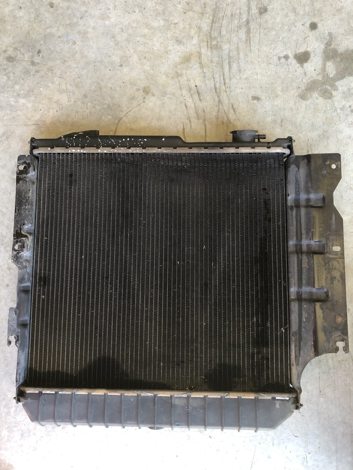

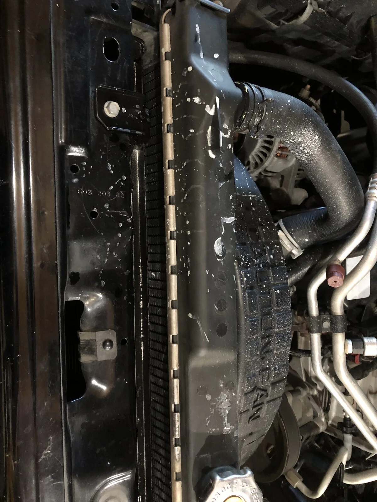

My factory Mopar radiator in my 2005 failed. Think it’s probably the original but don’t know. Going to replace it with a Denso tomorrow. Here’s a few pics of where it failed. I may do some destructive analysis tomorrow and disassemble the old radiator. The top tank split lengthways in a couple places.
My ‘06’s split in about the same place in 2017. I’m pretty sure it was the original too.

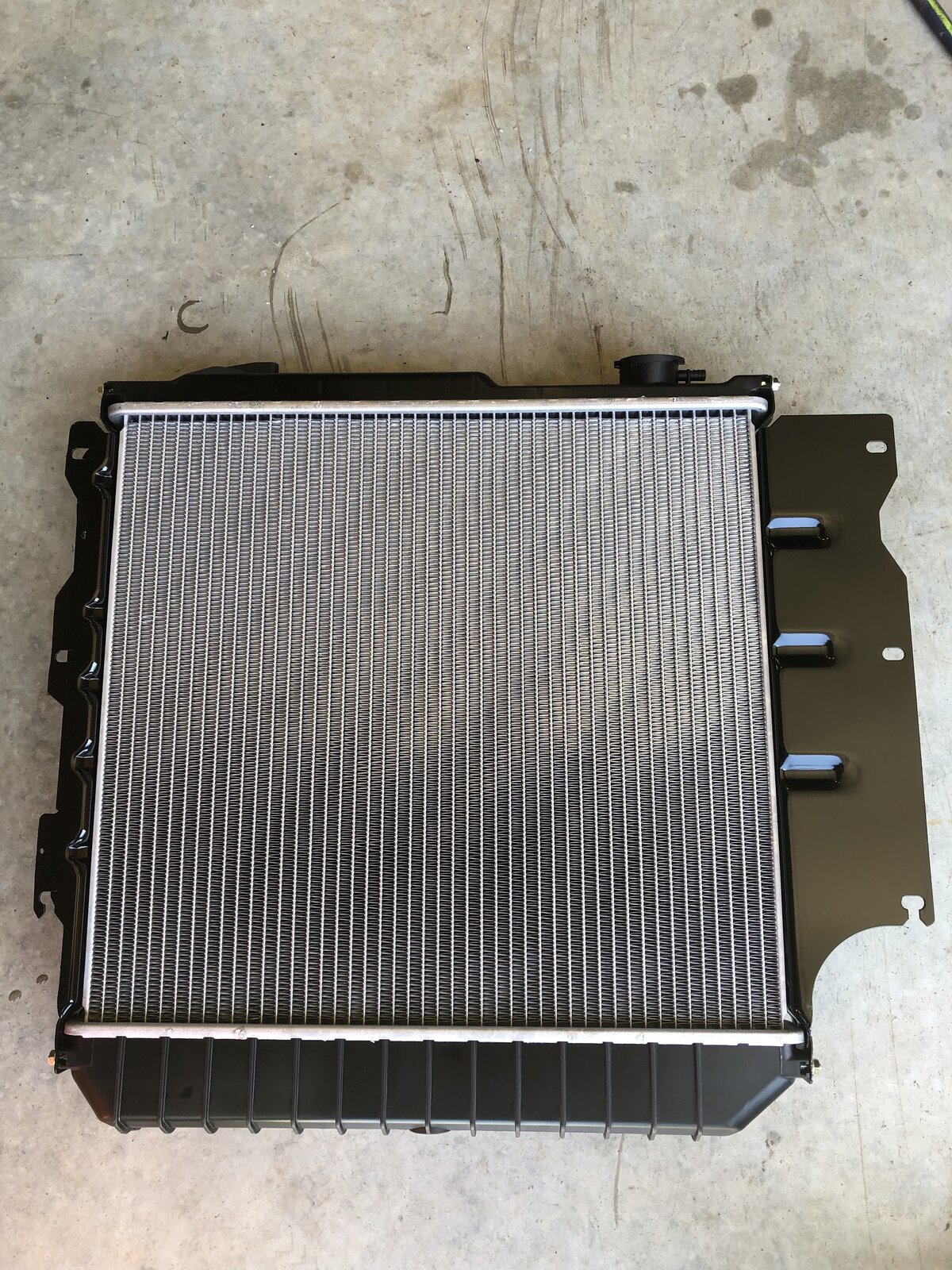

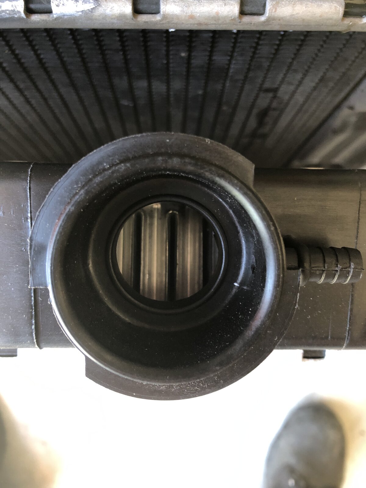

Here is the factory Mopar vs Denso pics. The Denso was purchased from Rock Auto. About $170 with tax and shipping at the time of this post (2023). Sticker on it says “Made in Indonesia”. It should be obvious which is the old radiator and which is the new one. The Denso bolted in with no modification. The tubes inside the Denso appear to be a little wider than the Mopar but not enough to make any difference I don’t think.
Weight wise they were very close. I don’t have a scale to weigh the two radiators but the weight is very similar. I think the Mopar MIGHT be a fraction heavier but that’s pretty subjective. So, weight is nearly the same.

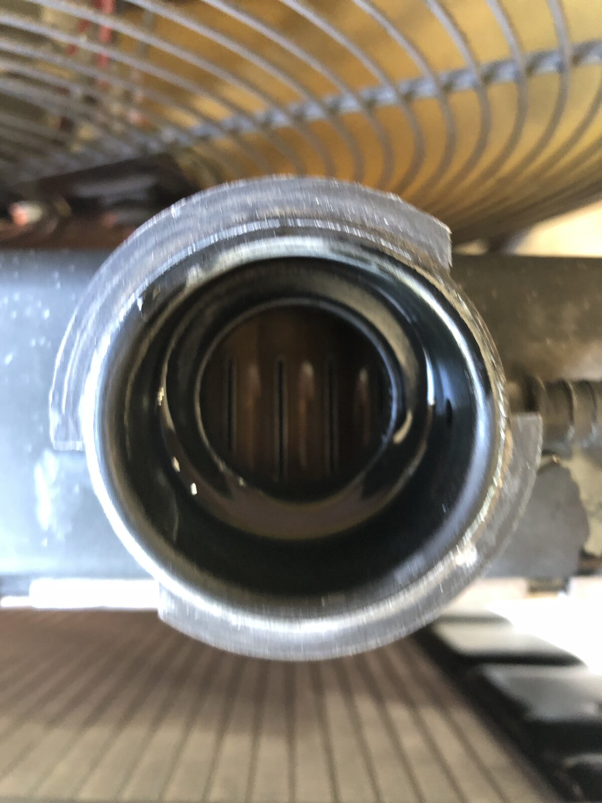

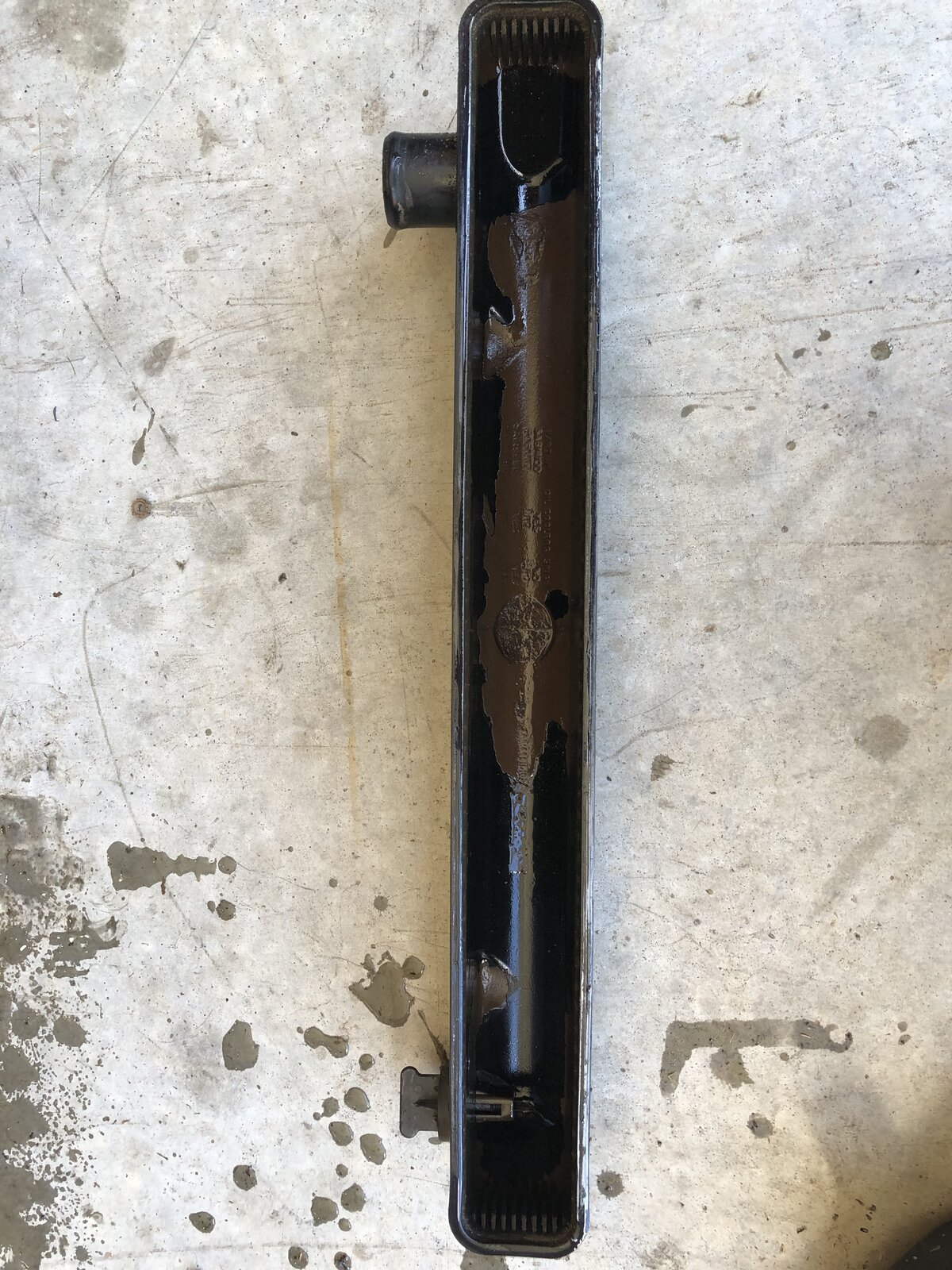

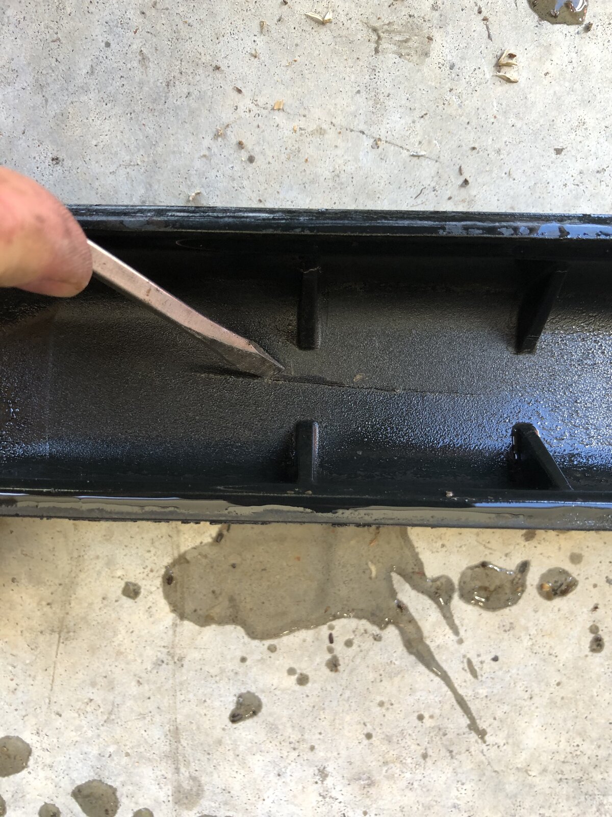

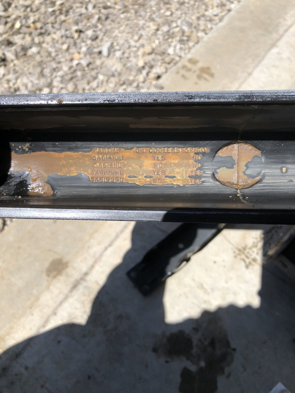

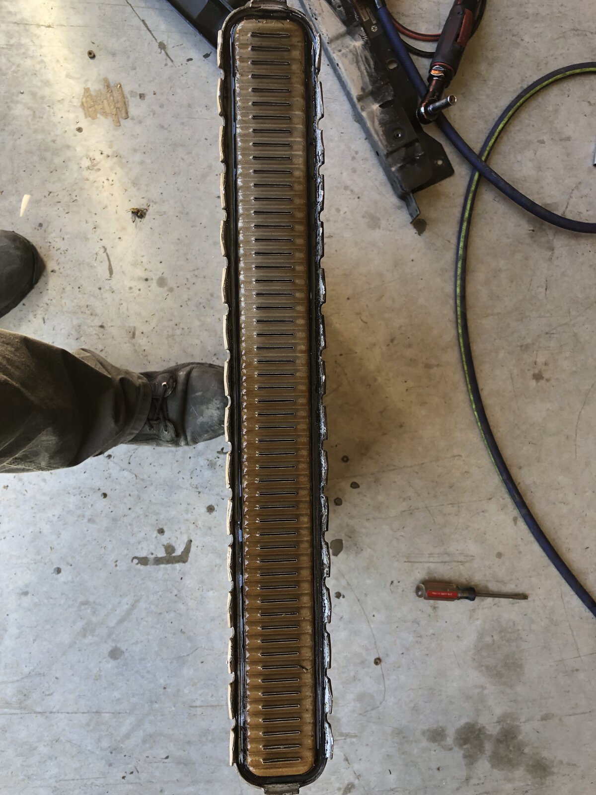

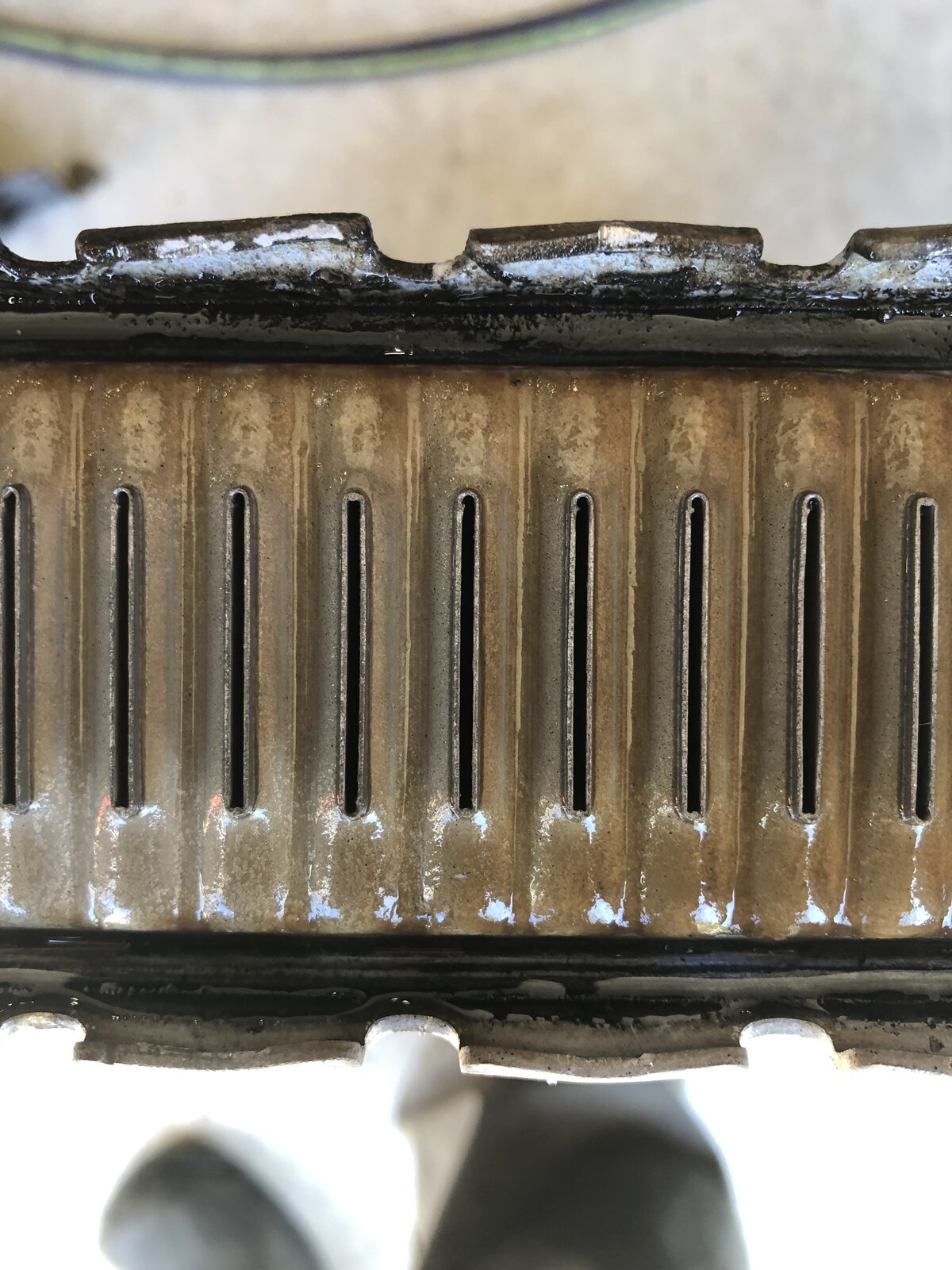

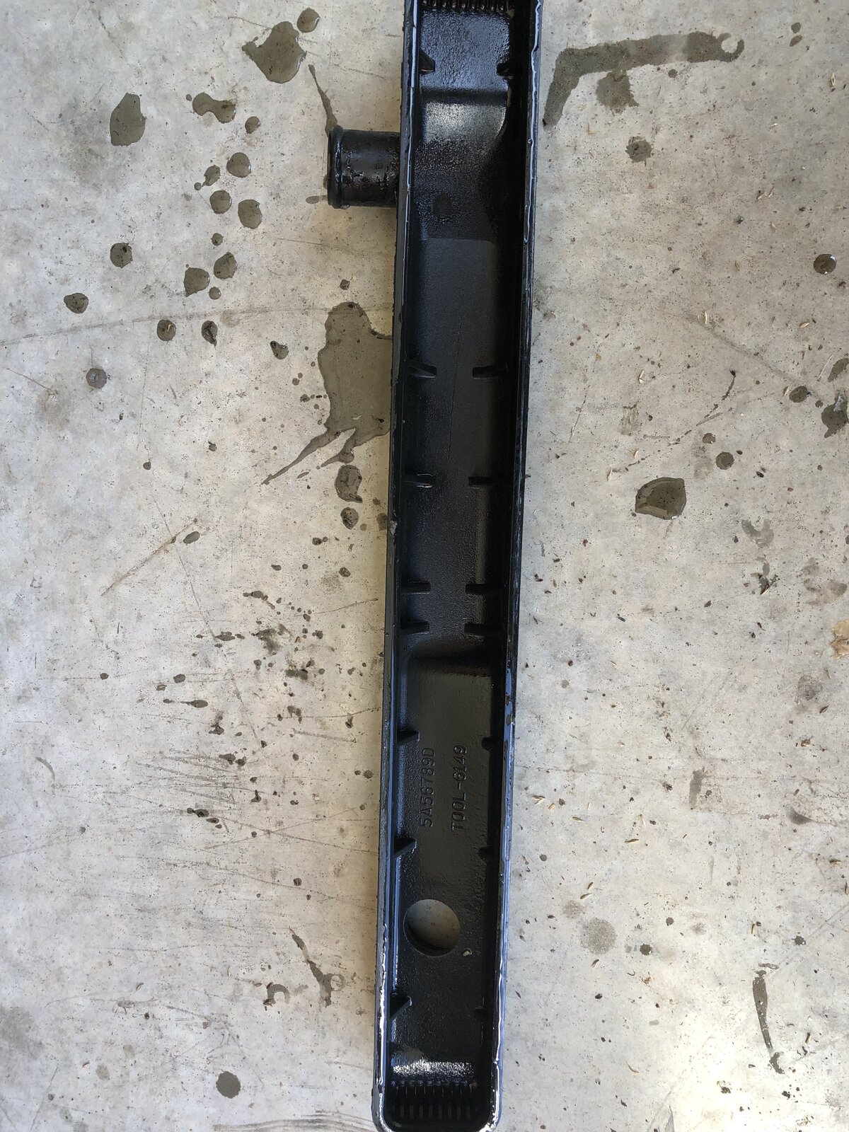

Here is the destructive disassembly of the Mopar radiator. I noticed something interesting about part numbers inside the lower tank. The upper tank felt softer than the lower tank so my suspicion is the higher heat in the upper radiator is harder on the plastic than the lower so the constant heat and cool cycles weaken the plastic on top first. The crack near the fill cap doesn’t appear to be all the way through but the one at the input hose IS all the way through….and is the source of my leak. It’s also interesting it’s near the hottest part of the radiator which also appears to suggest that heat is what does in the plastic tanks. The radiator tubes appear to still be in good shape. If you have a question about something you would like to see close pics of or more info, please ask soon because I’ll be tossing this old radiator in a few days.
For what it’s worth….I just got back from a 2700 ish mile trip out west. Wide range of temps from cold enough to need a little heat to hot enough to run the AC full blast. Ran the AC a good portion of the trip. The Denso radiator kept it at the right temp the whole trip. No issues at all.
