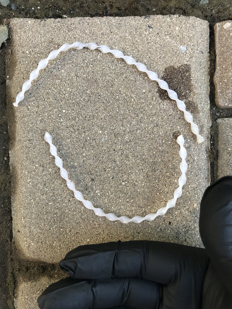

Hard plastic feel. I can’t deform the shape of the spirals. Looks like it may have been one continuous piece that was broken in two.

It looks like if someone drilled a big hole through some nylon and that was one long curly chip. But that doesn't make sense either..
Those are from inside the heater core tubes. They are designed to slow down the flow to increase heat transfer. I don't think that all have them, but I'm not sure.
