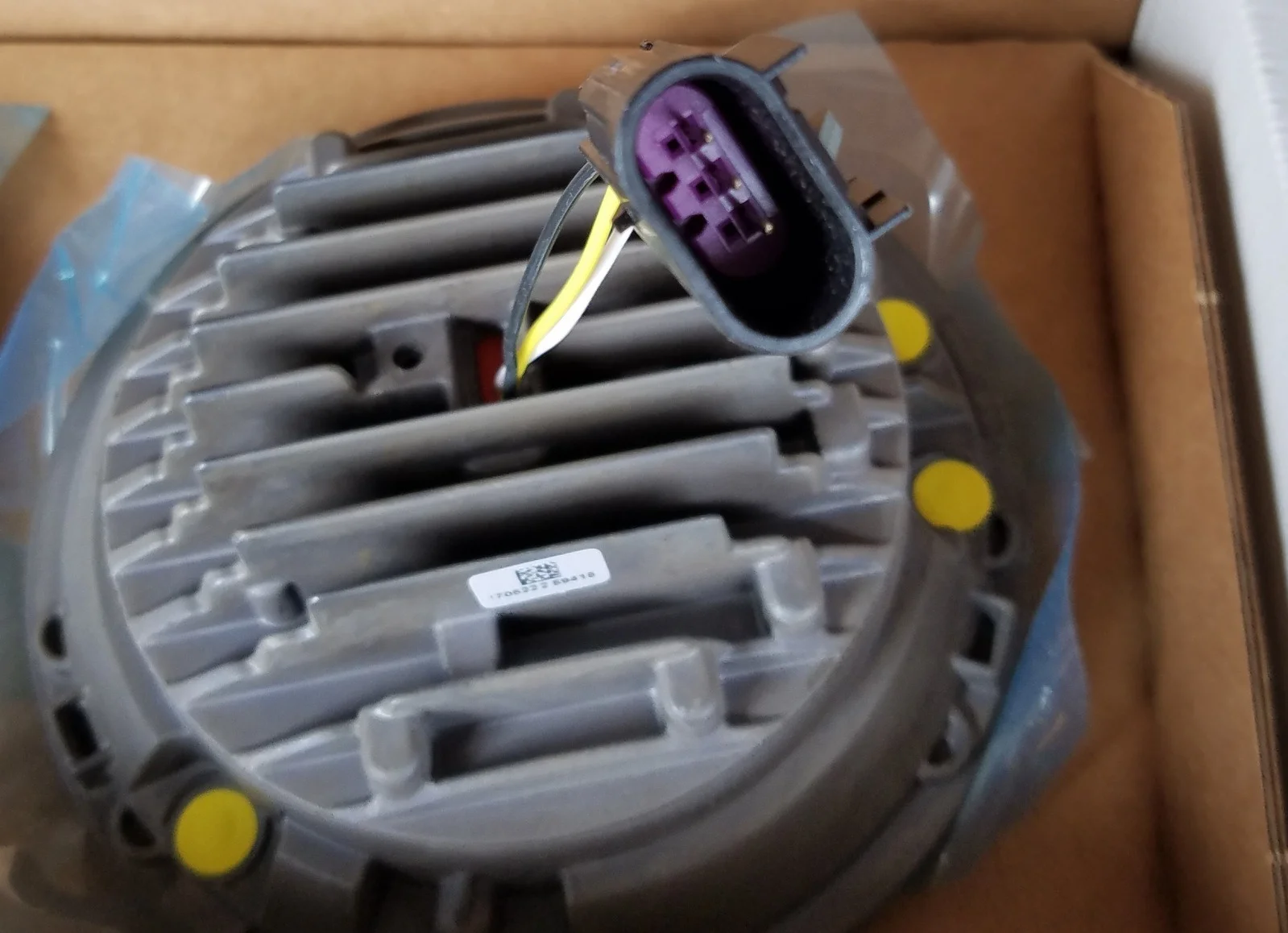

I just went to install the 8700 Evolution J's in my 2001 and something is off. My stock harness has a female connector that plugs into the male end which has 3 prongs on the existing headlights (Arranged in a triangle pattern, 2 on top parallel and one flat below them). My new JW Speaker headlights come with a male connector that has 3 parallel prongs. Can anyone point me in the right direction? I'll try to get some pics of the connectors as well as the box for the headlights I received. As far as I know and can tell, my headlights were standard factory lamps with factory connectors.

I just went to install the 8700 Evolution J's in my 2001 and something is off. My stock harness has a female connector that plugs into 3 prongs on the existing headlights (Arranged in a triangle pattern, 2 on top parallel and one flat below them). My new JW Speaker headlights also come with a female connector that has 3 parallel prongs. Can anyone point me in the right direction? I'll try to get some pics of the connectors as well as the box for the headlights I received. As far as I know and can tell, my headlights were standard factory lamps with factory connectors.
Since those new lights have JK connecters on them, you have two options:

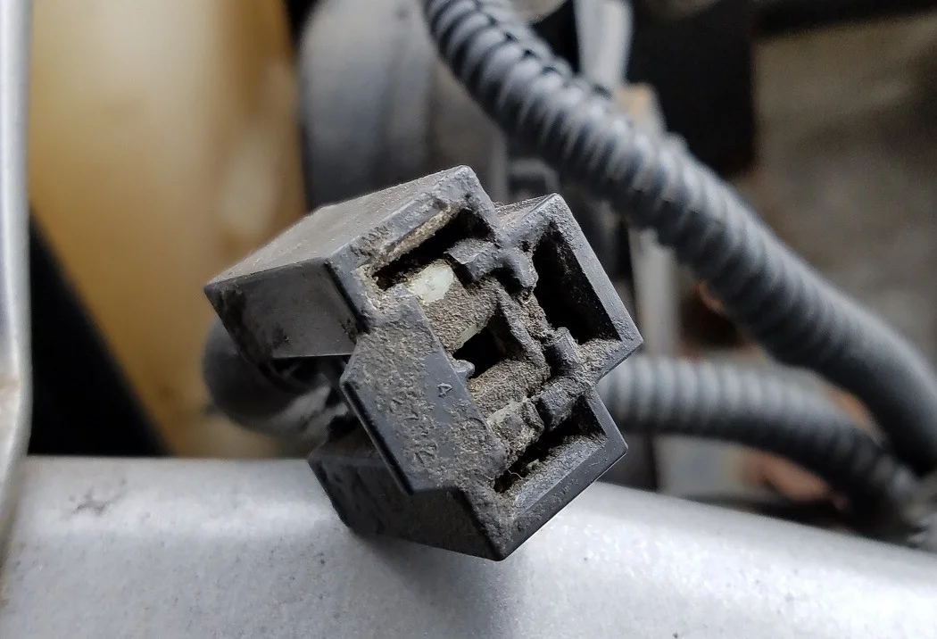

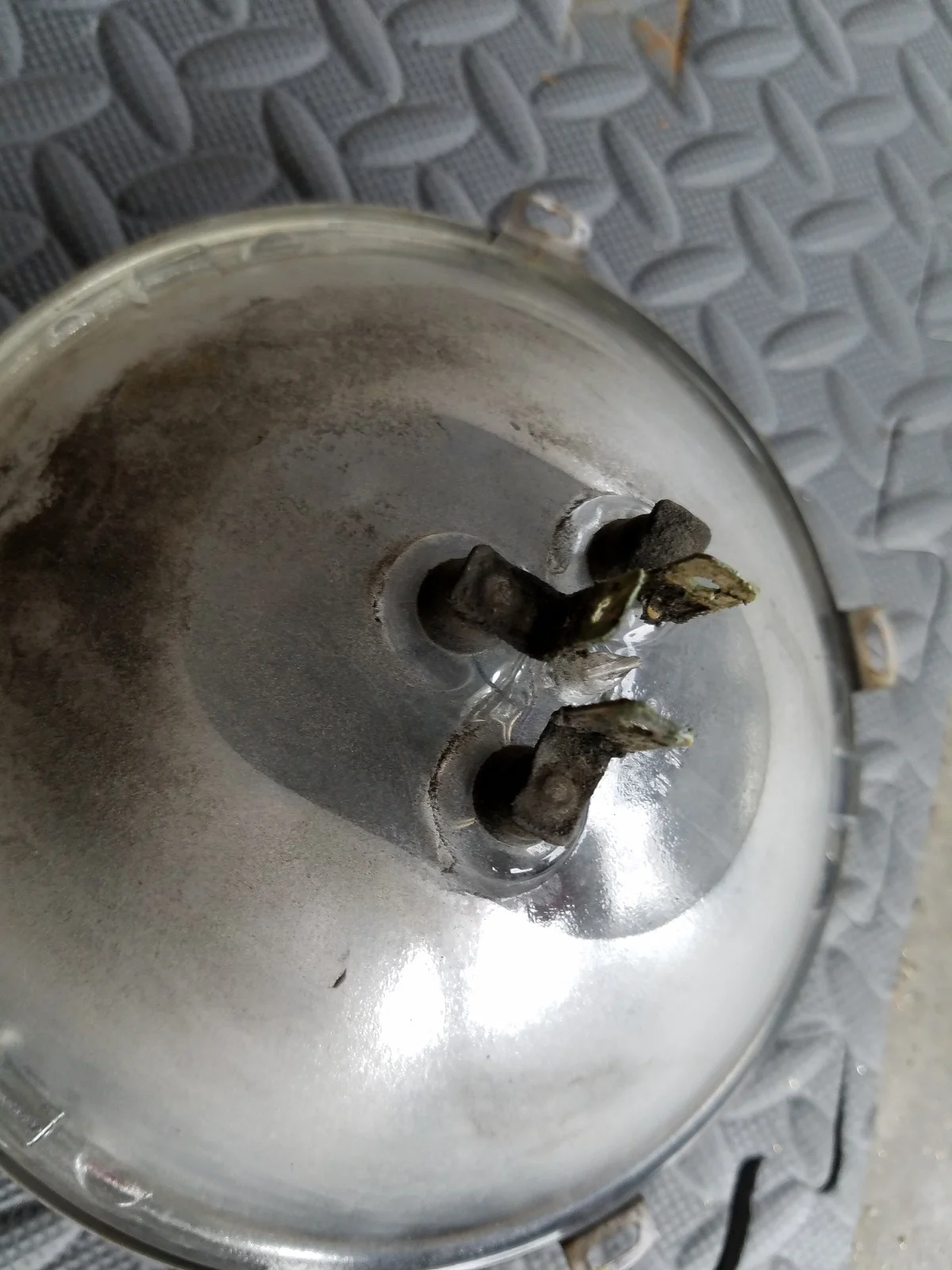

Here are pics of the various pieces. Just want to confirm, did I order and receive the correct lights and they are just now updated to fit JK's?
The headlights I ordered:
The connector on the new headlights:
The old headlights:
The plug from the harness to the headlights:

Those are the correct headlights, they just have the JK harness adapters on them. That is because these are the newest light from JW speaker, and the built them thinking they'd sell most of them to JK owners (which is probably right). So they will indeed work with your TJ, you just need those adapters I linked to, which convert that H13 adapter to an H4 adapter. Order them via Amazon Prime and you'll have them by Friday I suspect.
That will allow it to be 100% plug-and-play, and if you ever take them off, you won't have to worry about having cut them or anything.
