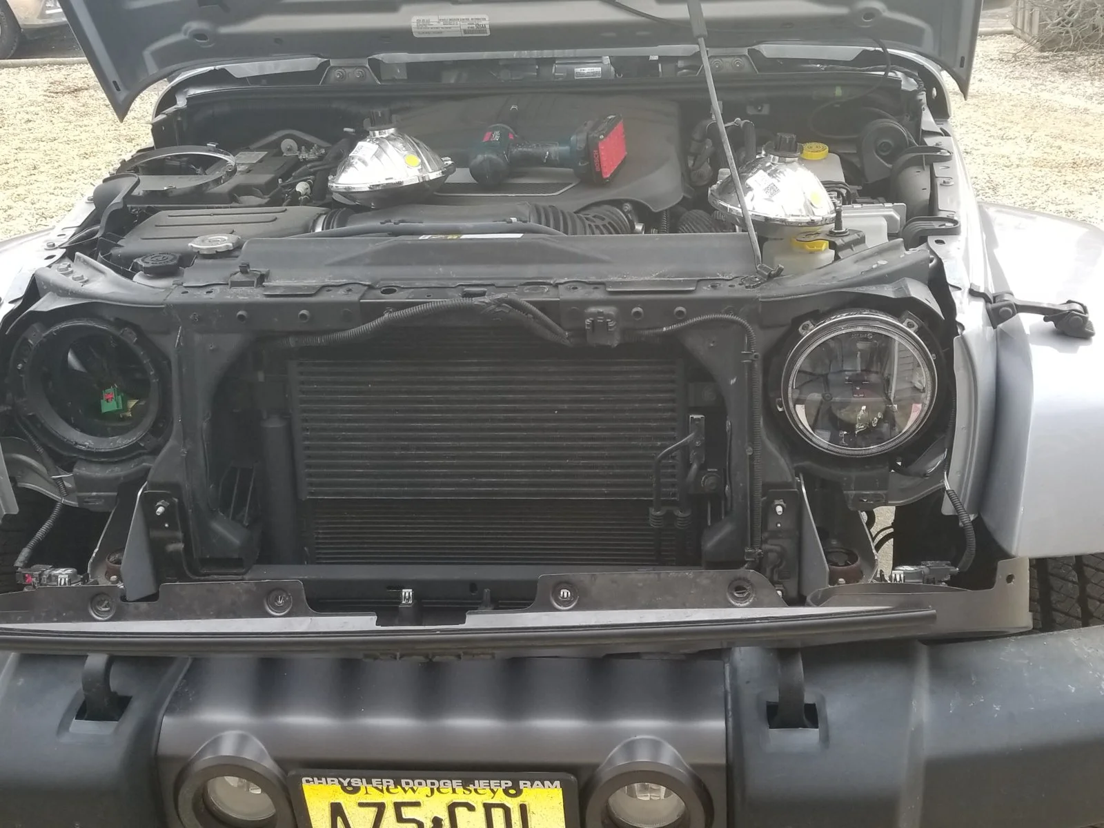

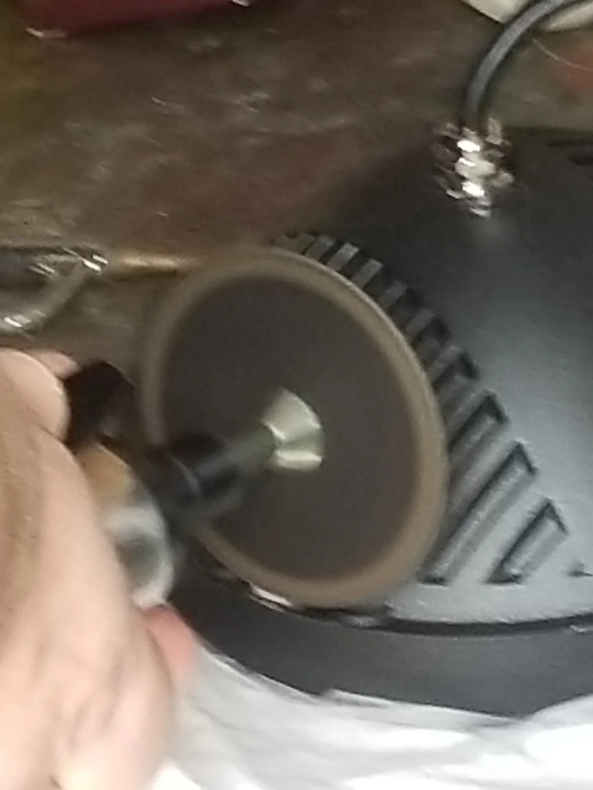

Okay, I was going to suggest grinding down the tab on each light, that would have been what I did. I'm just surprised that of all the people who have installed these, no one once has said anything about this. I hope one of those guys sees that I tagged them in this and chimes in!
Ohhhhh... is this a JK we are talking about? I thought we were talking about a TJ. That might be it.
Sorry for the delayed response. Mine were a direct replacement, not issues at all.
Stupid me... I didn't notice it until now, but @Rocco has a JK, that's why!
Looks like they're almost a direct fit for a JK, you just have to grind off a little tiny bit. Go figure! I was going to say... No one I know has had any issues with them fitting on a TJ.
Reactions: CodaMan
The application on the specs page states they fit cj and jk models. Being required to have and use a grinder is a joke
I guess the JK headlamp retainer bucket must be ever so slightly different than the TJ. Not by much, but apparently enough that you just have to grind off that little edge of the light.
