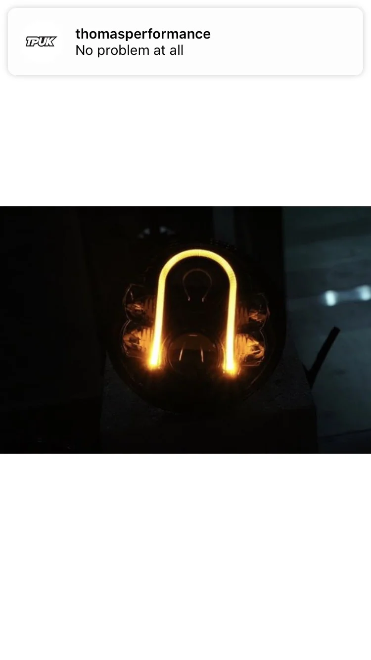

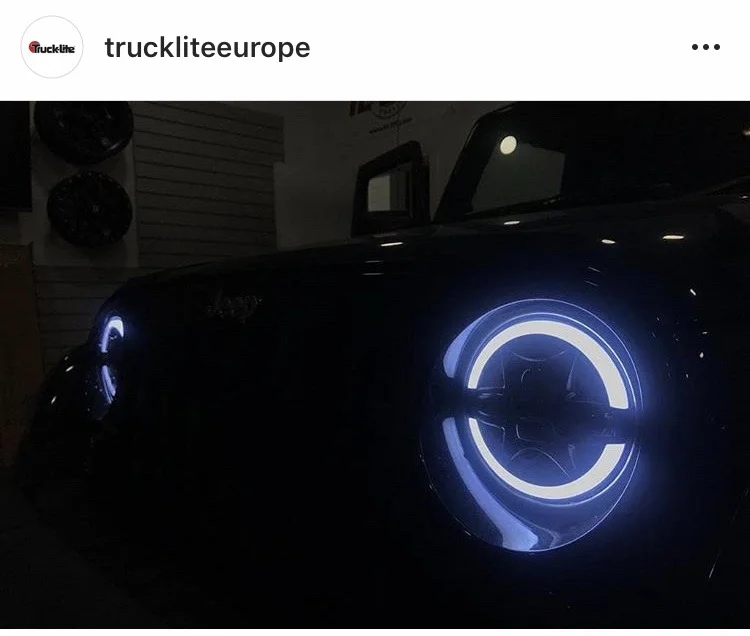

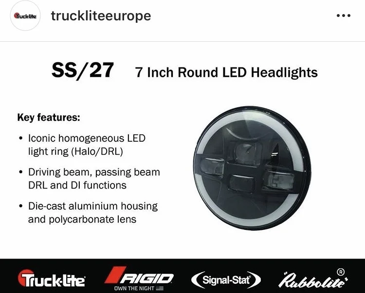

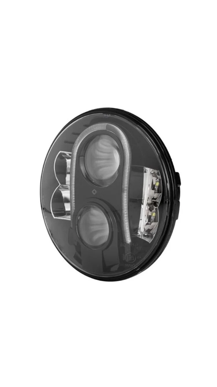

Looks like they followed the crowd and went for halos. The new design looks a little too much like HD speakers to me
View attachment 59082 View attachment 59083
Oh no, those look ugly. Looks like they jumped on the bandwagon.

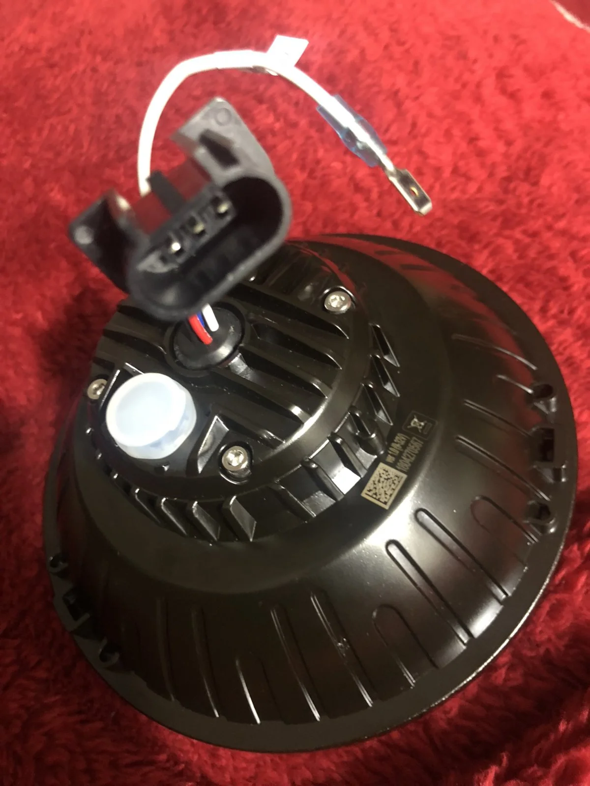

Just picked up these headlights, however my connection is different. I know I ordered the correct pair, not sure why its different. Is there a way I can still make these work?

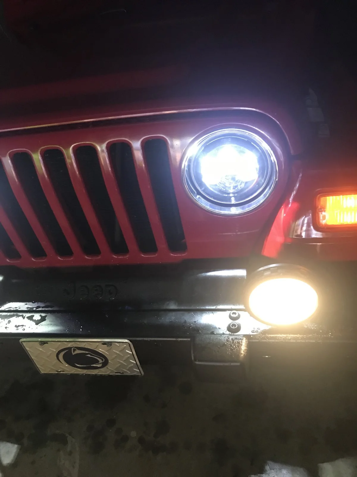

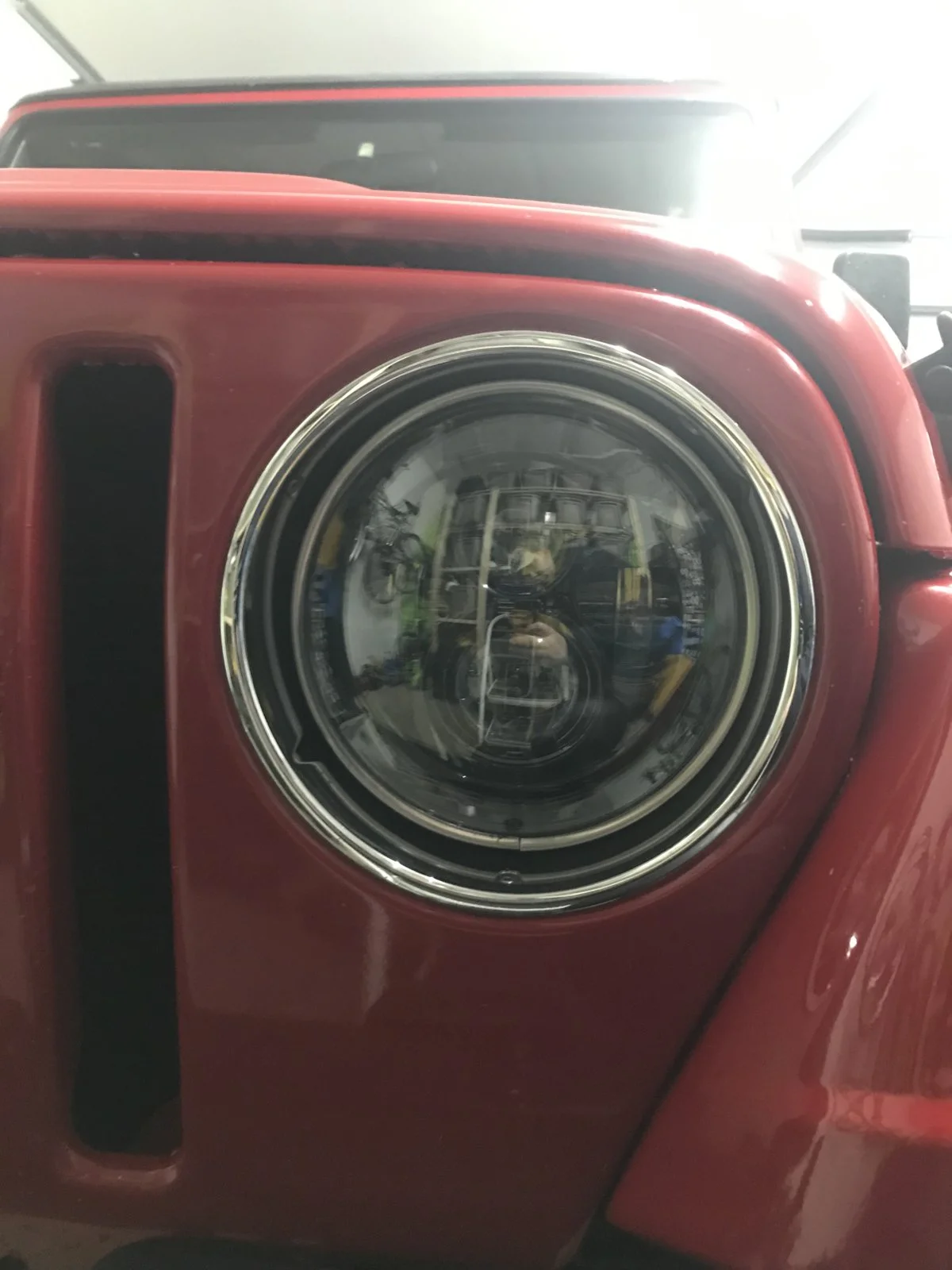

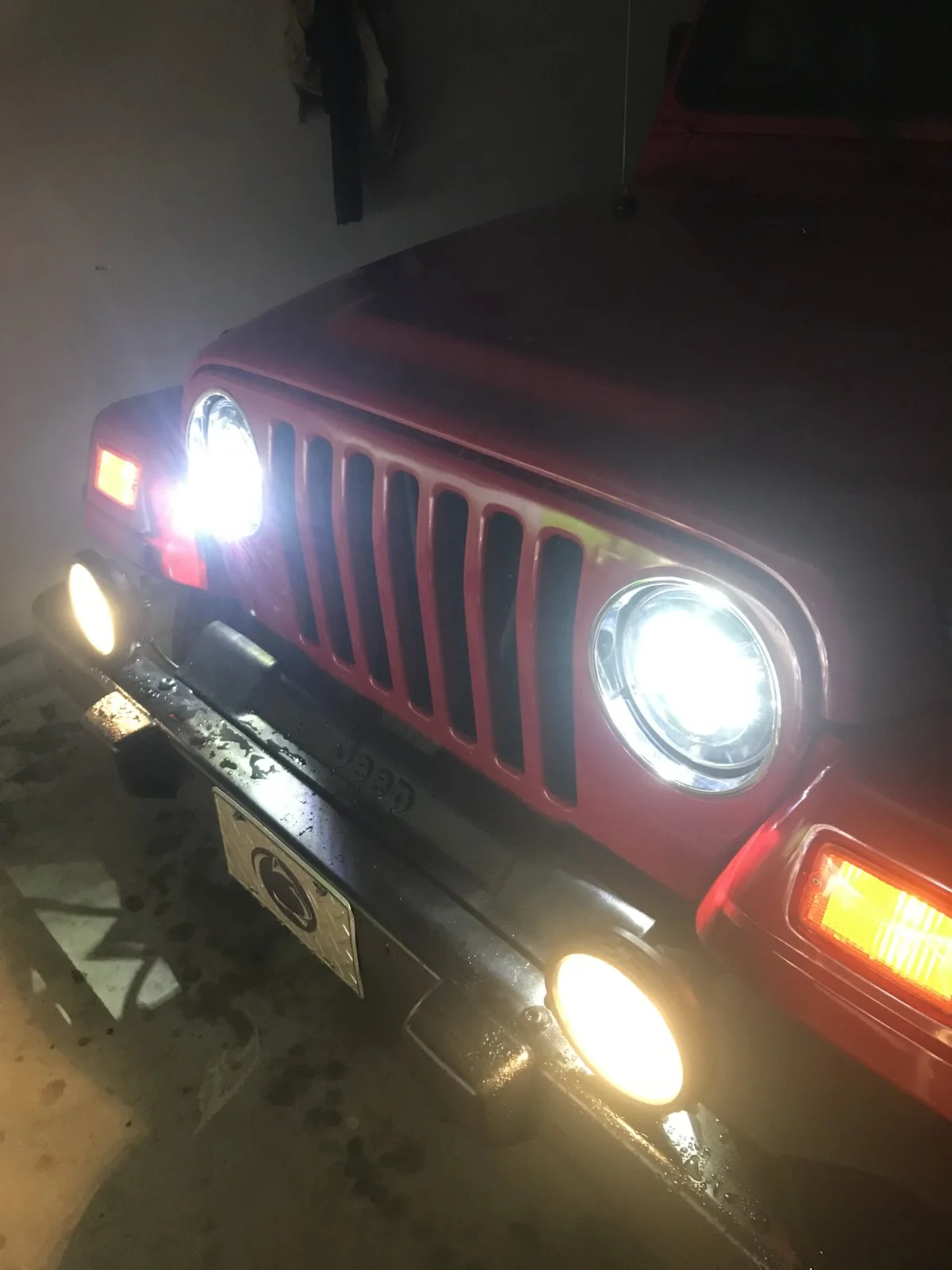

I bought a pair of LED headlights off ebay i believe they are copy.of trucklite. Can anyone advise which side should be up?
https://rover.ebay.com/rover/0/0/0?mpre=https://www.ebay.com/ulk/itm/153070854450
The only downfall I can think of with regard to LEDs are the fact that they don't get as hot, so in winter snow and ice can or could build up on the lenses. I haven't had them in winter yet, so I don't know if it will be an actual issue.
Yeah it’s misconception that LED’s run cold they just generate a lot less heat* than standard light bulbs, you will see most decent LED designs come with heatsinks built in as part of their design. Truck-Light 7’s come with a heated elements up front but that’s overkill for the average person.I've had my LEDs in the middle of a blizzard and they didn't accumulate ice or snow at all. I think that people blow that one out of proportion a bit. Maybe it happens in some places, but it didn't happen to me one bit. I was happy about this of course!
Yeah it’s misconception that LED’s run cold they just generate a lot less head than standard light bulbs, you will see most decent LED designs come with heatsinks built in as part of their design. Truck-Light 7’s come with a heated elements up front but that’s overkill for the average person.
they look like cheap knockoffs, probably get the job done though but would rather pay the same money for a solid build with less uneaded features if i'm on a budget.Anyone seen these? They appear to be a GEN II to the ones that are raved on in this thread. Kind look nice with the DRL being horizontal like that but the signal light not so much and don't care for that.
