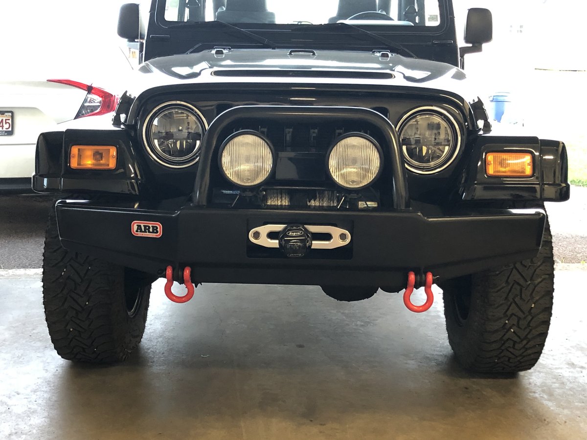

Just got these bad boys. 3 days from allieexpress cheapest I could find online. I’ll have to address the DRL as my Jeep has it.

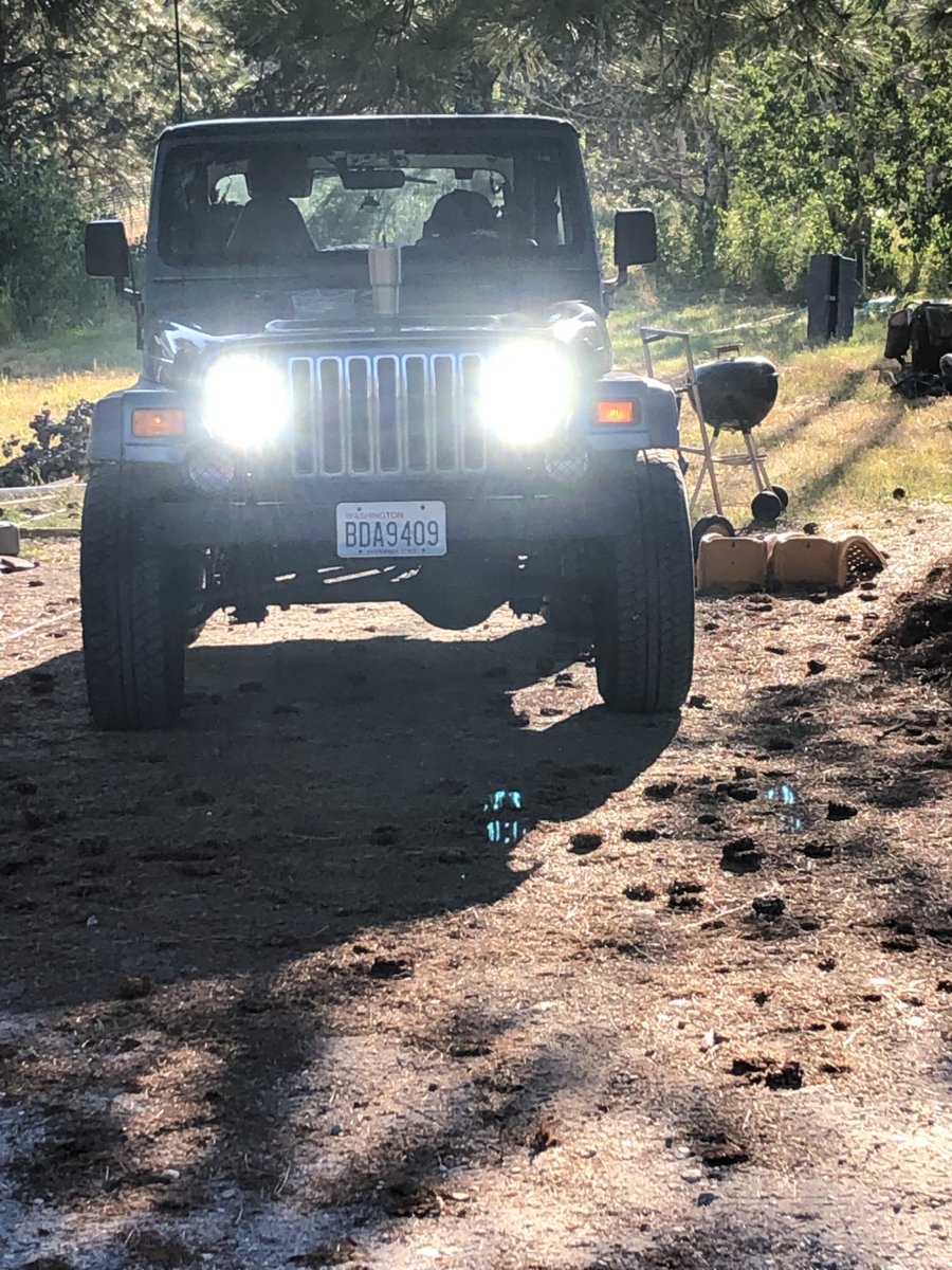

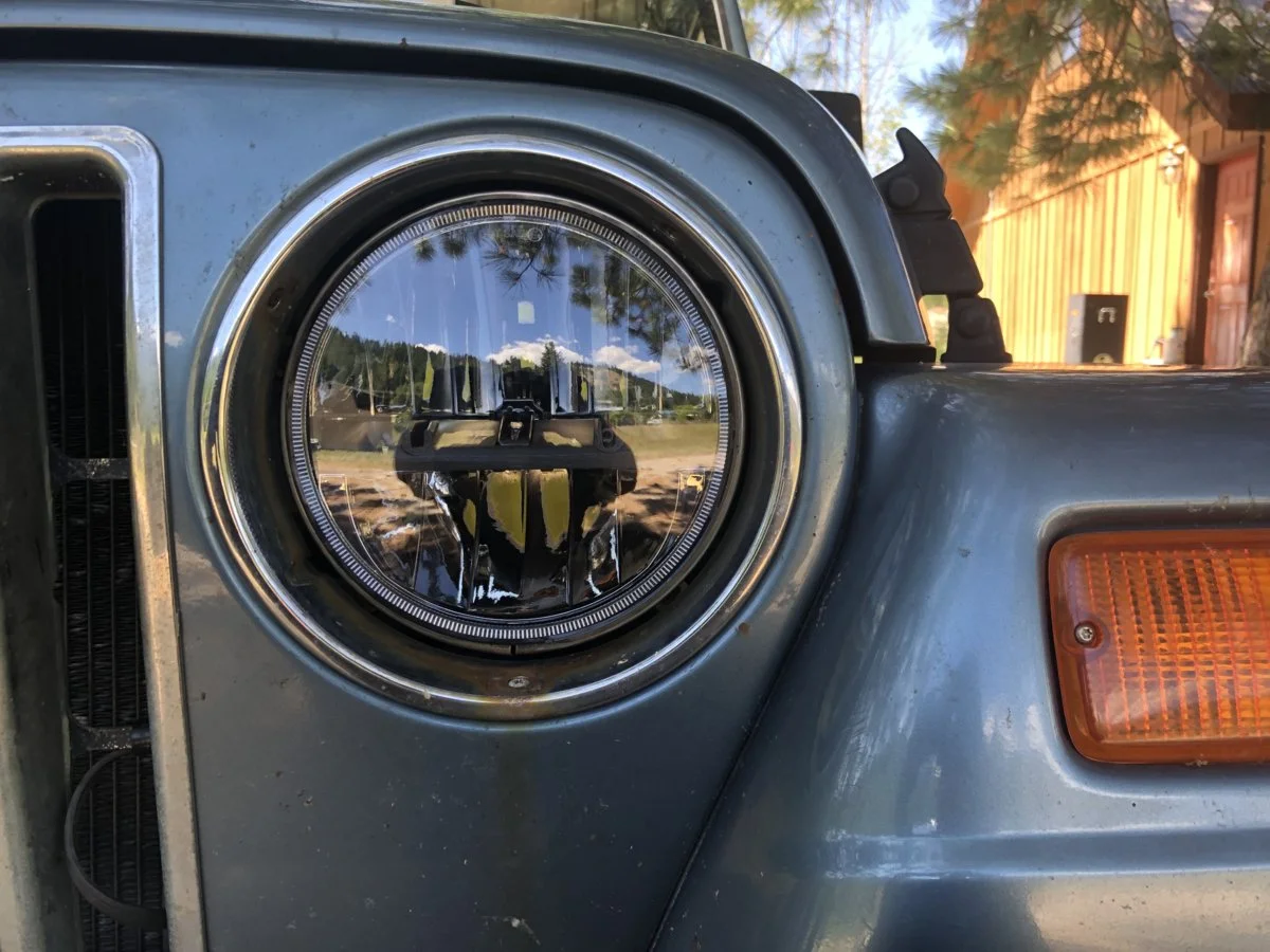

Installed them! Light output looks amazing compared to the stock. Also the look of these is real nice. Not sure why some had issues with the DRL but these work fine with my DRL Jeep.. when the Jeep moves the lights come on at a little dimmer output but no flickering of LEDs etc. so that’s perfect.
Few questions, regular headlights is the upper bowl, correct? High beam adds the lower bowl. Or did I not orient these correctly?

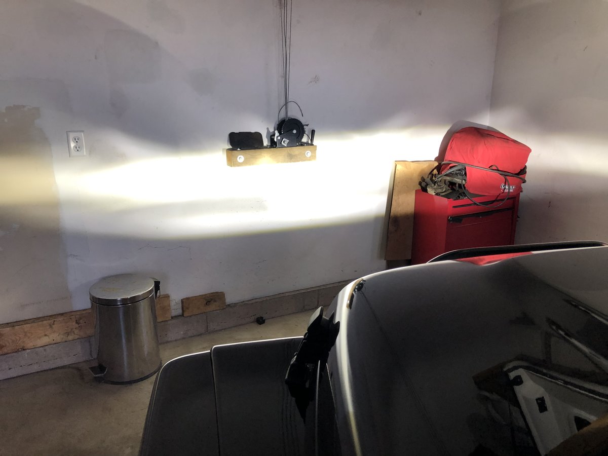

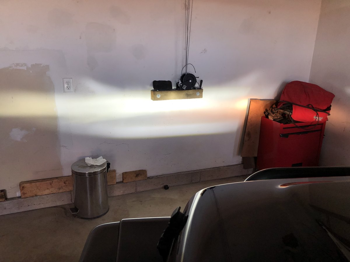

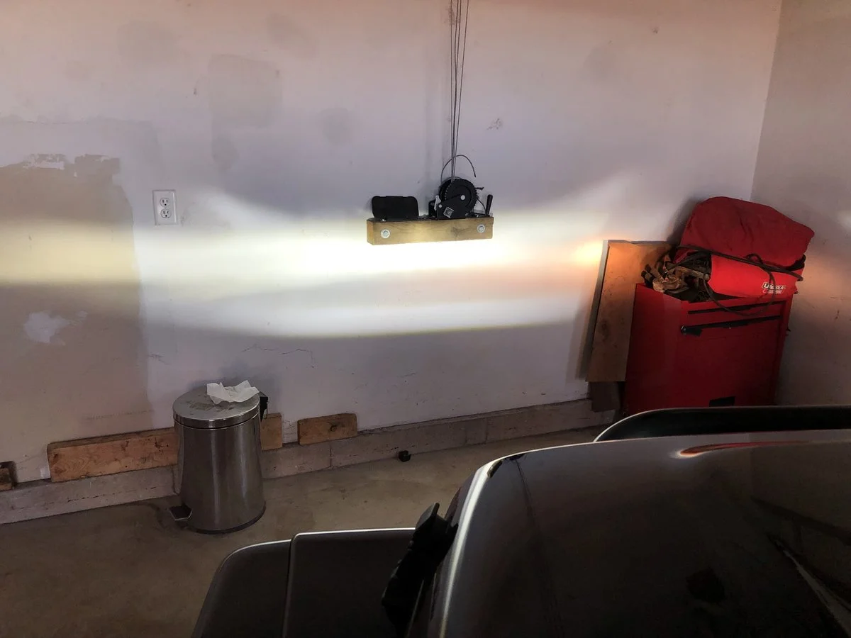

Any idea if I need to aim these or can it be considered aimed since I never touched the aiming screws. If they do, how does one do that?

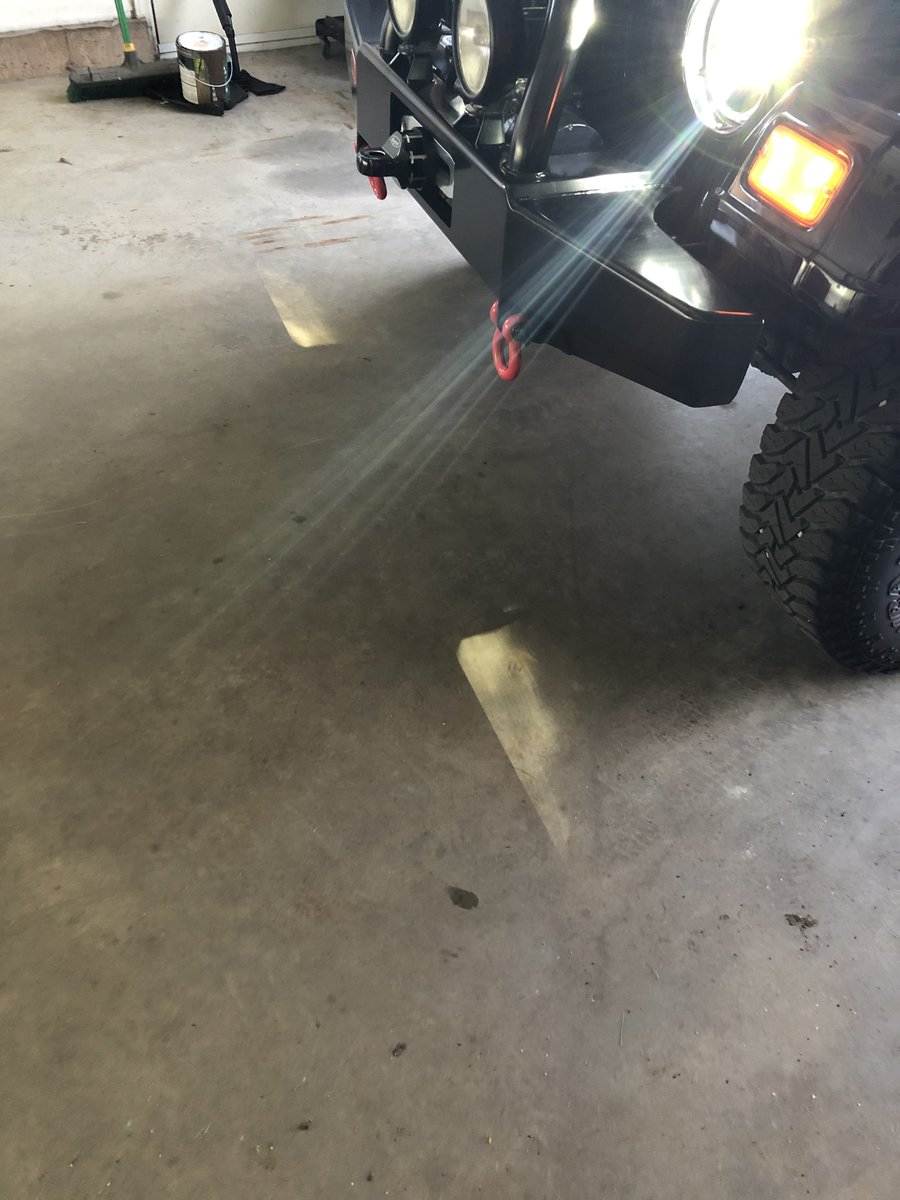

I noticed a bit of light spillage below the bumper, see the pic. Is this normal or does that mean their not aimed properly?
No, you don’t need to re-align if you didn’t move the alignment to start with. You’re correct in that the upper is the low beam and the high beam adds the lower LED’s. If you have any doubts, the “DOT” should be at the top, as should be the vent. Also the small ears on the lights should only allow the light to be oriented in the buckets correctly. If you do need to re-align the lights, it’s park on a level surface with the lights 25 feet from your aiming wall/garage door etc., preferably with 1/2 tank of gas. Place a tape mark on the aiming surface that is perpendicular to the centerline of the Jeep. Measure from the surface you’re parked on to the center of each light. Transfer those measurements to the aiming surface and mark with horizontal tape lines. Measure from the Jeep centerline to center of the headlights and transfer those measurements to the aiming surface with perpendicular tape lines. Should have a grid that more or less look like this:
Depending on your model year, you’ll either have a single up/down torx adjustment screw on the upper outboard of each bucket, or an up/down and left/right located upper outboard, lower inboard of each bucket. There should be tapered grooves on your trim rings to guide you to the proper screw(s).
You want the brightest part of your low beams to be 2 inches below the horizontal line and 2 inches to the side of the vertical lines away from oncoming traffic.

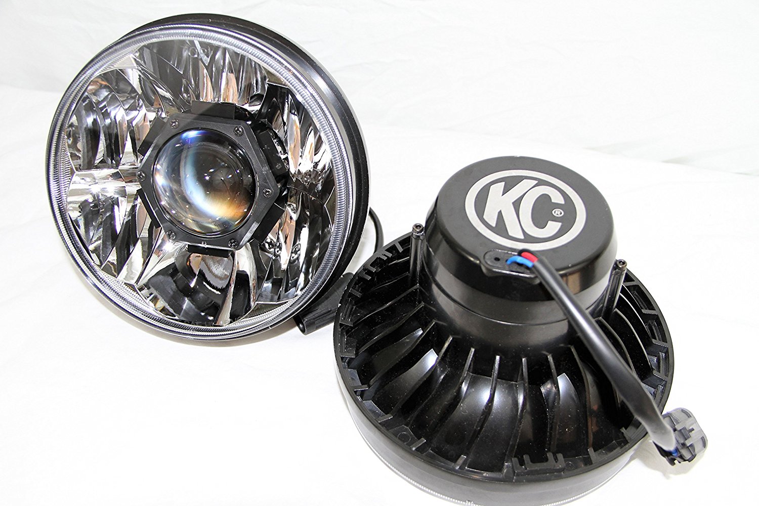

LED Setups
A true LED setup has many advantages over a halogen setup. A true LED headlight will have a much sharper cutoff pattern (therefore illuminating the road better while not blinding oncoming traffic), better light output, and it will feature a headlight housing that is designed from the ground up for an LED bulb (this is very important). Let's also not ignore the fact that all modern vehicles are starting to go towards LED headlights being installed from the factory. Even the 2017+ Jeep Wrangler JK now comes stock with LED headlights. LED headlights will eventually replace HID headlights as they are more efficient, draw less power, cheaper to produce and last much, much longer. If you want my honest opinion, the best possible headlight you can get for your Jeep Wrangler TJ, is an LED headlight.
It's also worth noting that all of these LED headlights use polycarbonate lenses as oppose to glass (which halogen headlights use). Polycarbonate is great for off-road vehicles since it won't crack or break if your headlight happens to get smacked by a tree branch (or similar) on a tight, off-road trail. This is one benefit of LED headlights that most people overlook.

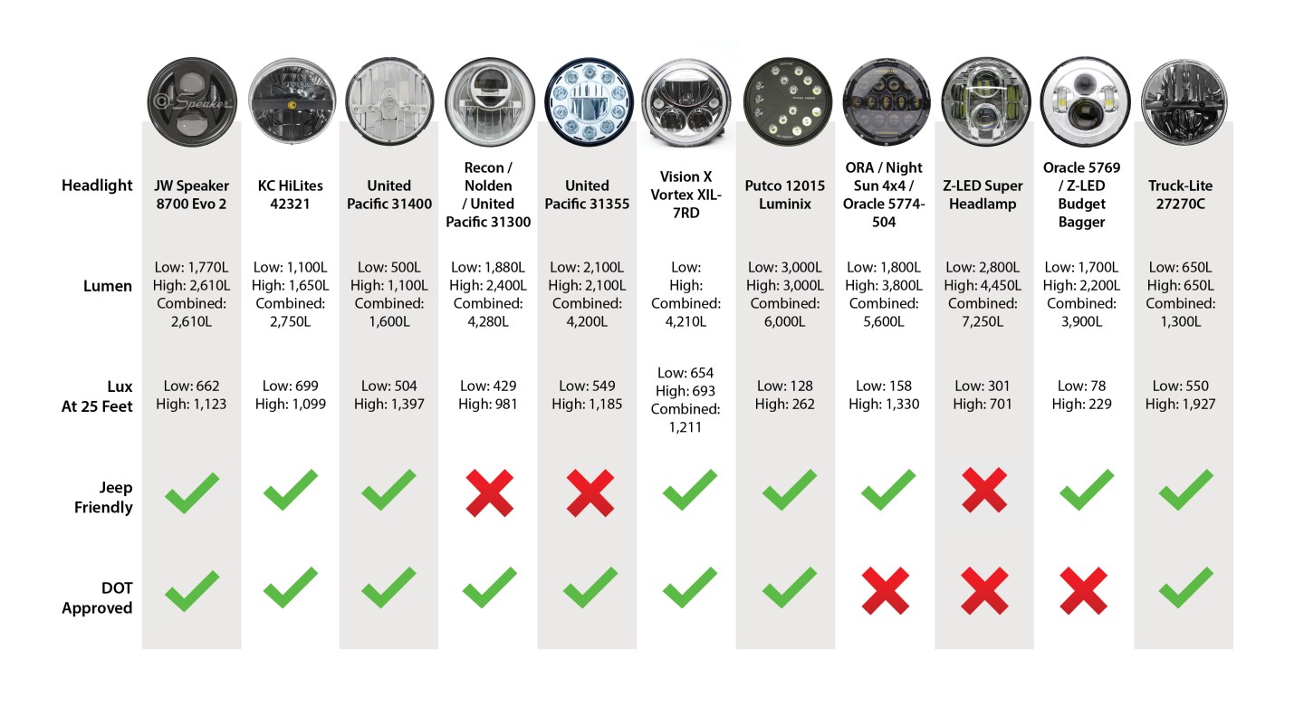

Here's a rating comparison of some of the more popular LED lights for the Jeep Wrangler TJ:

Be aware that when choosing an LED light, there is way more to it than simply which one has the most lumens. A perfect example of this would be the Truck-Lite 7" LED Headlights. While they don't have as many Lumens as some of the others, it doesn't matter, because the reflector housing in which they are in provide a far better light output than almost any of the LED lights on this graph.

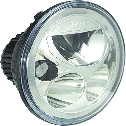

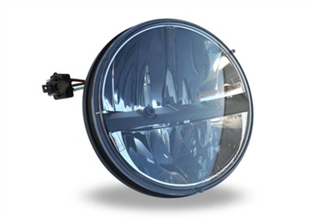

Don't be put off by the outlandish price of these headlights. I switched from my Truck-Lite (27270C) LED Headlights to these things, and I am absolutely blown away by how nice of a headlight this is. If you're one of those people who considers yourself a lighting snob (that's how I am), I assure you that these headlights are the one you want. These things are the cream of the crop. Both the way they look and the way they perform is outstanding. They are made in South Korea and include a lifetime warranty (how many other manufacturers can say that?). The quality of these things is apparent not only by looking at the packaging they come in, but also inspecting the headlights up close. The Vision X Vortex outperforms all the other LED headlights on the market, and looks outstanding while doing it. They offer a halo LED ring, as well as the ability to run both your high beams and low beams at the same time (with the optional Hi4 harness). These headlights easily win my top pick, and if you have the money, then you honestly should consider picking up a set. As far as I am concerned, there is no better light out there than the Vision X Vortex. My Truck Lites were amazing, but these outperform even my Truck Lites! These headlights will work on both JKs and TJs, as they come with adapters for both!​
If you'd like to see my review of the Vortex Vision X headlights, you can find it here: My review of the Vortex Vision X LED Headlights
Ask around among any Truck-Lite owners (myself included) and 99% of them will have nothing but praise for these headlamps. It's absolutely shocking how good the light output is on these things. I went from stock sealed beam headlights to these things, and it was like shock and awe the first time I drove at night with them. Even on completely unlit roads, these things illuminate so far ahead of you that it's almost like you're driving in the day time. Don't assume that just because these don't have the sophisticated appearance of a light like the JW Speakers, that they aren't as good. Quite the opposite actually! The reflector housing in these things provides a very defined light output. There's a lot of other LED manufacturers out there, but in my opinion Truck-Lite was the first to the market with these things. They're used by the U.S. Army on many of their vehicles throughout deployment in Iraq and Afghanistan. They also make a heated version of the Truck Lites as well (for those of you who live in extremely cold climates). These would be my second choice.

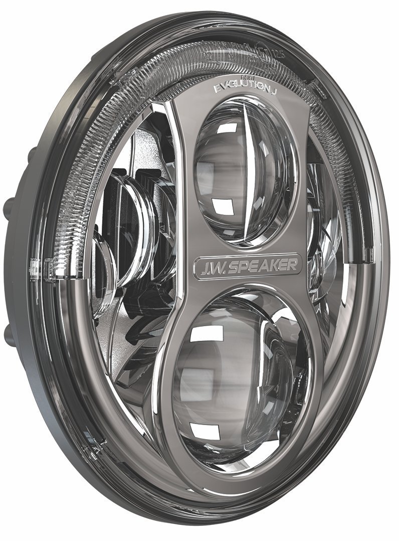

These JW Speakers have a proven history of being one of the brightest available headlights out there for our TJs. Thee headlights are run by a lot of Wrangler owners, and therefore they have a proven track record with the quality to back it up. Available in black and chrome. They're not cheap, but the light output and quality easily make them worth the price. These would be my third choice.​
The Gravity Pro is the latest 7" LED headlight for the Jeep Wranglers. It further improves on the previous KC model (42321) by combining both a reflector housing and a projector lens. The light output is crisp, clear, and has a nice, sharp cutoff, thanks to the projector lens. In addition to that, these things provide an aggressive look, without going over-the-top. You won't find an halo rings here, just pure, quality lighting from a reputable manufacturer whose been in the game for a long time. Since these headlights are designed for JKs, to make it a plug and play situation, you'll need some H4 to H13 adapters.​
These things look a lot light the Truck Lites, and all the reviews I've read say that the light output is on par with all the other top choices. They cary the reputable KC brand name, so these are a solid buy for sure.​
Without a doubt, if you have the money to spend, these are pretty widely regarded as the brightest LED lights available for our TJs. Available in black and chrome. They're spendy, but the light output is second to none. In addition, these things are hands down the best looking LED headlight out there for our TJs in my opinion. Since these headlights are designed for JKs, to make it a plug and play situation, you'll need some H4 to H13 adapters.​

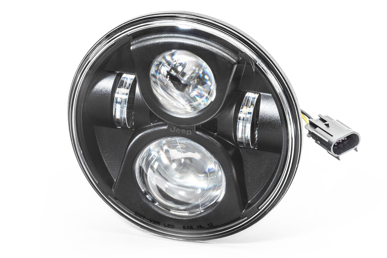

These are the factory OE LED headlights that come as an option on the 2014-2016 Jeep Wrangler JKs. They're around $800 for the option (when you ordered your JK brand new), and from what I can tell they are identical to JW Speakers, but they have the "Jeep" logo imprinted on them, which is pretty awesome. They are a 100% plug-and-play headlight for our TJs. Since these headlights are designed for JKs, to make it a plug and play situation, you'll need some H4 to H13 adapters.​

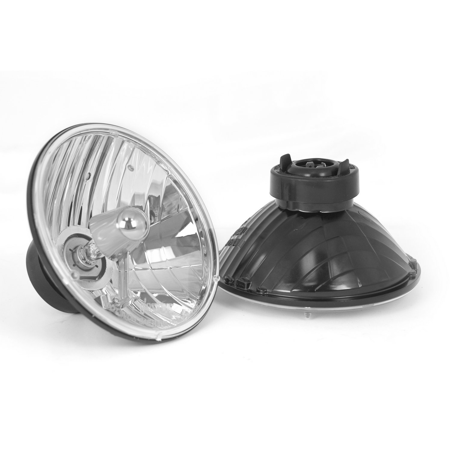

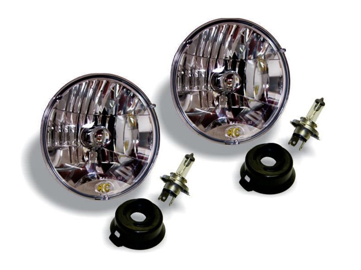

Since the stock headlights are sealed-beam, you can forget going out and buying a pair of better headlight bulbs. In order to do that, you'll first need to convert to a set of 7" H4 headlights (which are non-sealed beam). With these headlights you'll be able to replace just the headlight bulb itself (not the entire assembly) and you'll also reap the benefits of much better light output versus stock. Now I don't know why anyone would bother with halogen lights considering how much brighter (and less wattage) LED lights are. However, everyone has different taste, and if you insist on running halogen headlights, you'd be a fool to consider anything other than the following halogen headlights for your Jeep Wrangler TJ.
These would be my top choice for halogen replacement upgrade hosings. There have been many comparisons of the Cibie 2" versus the Hella 7" but the Cibie always seems to edge the Hella out in regards to light output just a bit.​

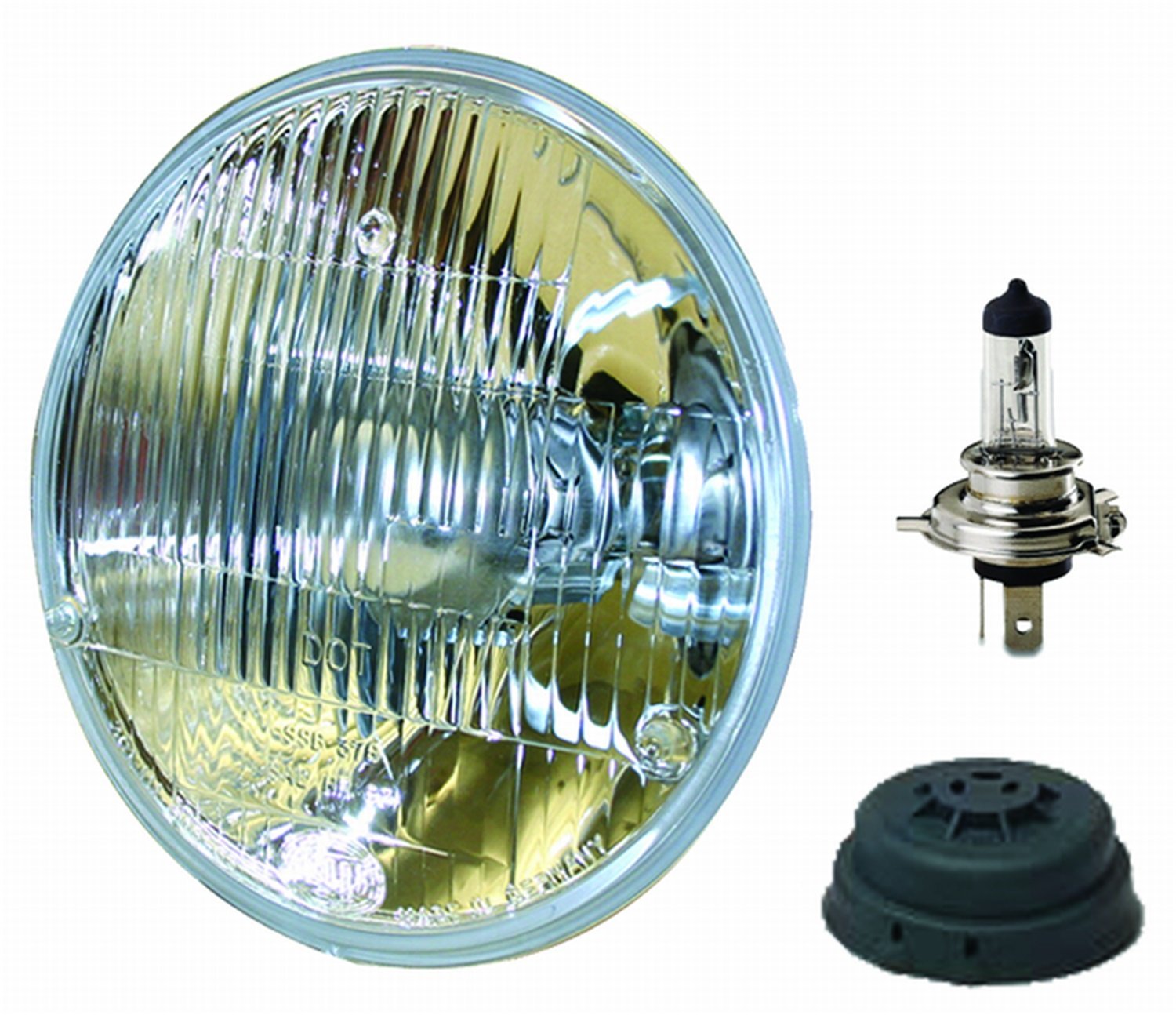

Often times referred to as "Hella E-code headlights". A close second to the Cibie, these 7" halogen headlight upgrades are a solid choice for improved light output over stock.​
I can't comment on these personally, but the people who are running them really seam to like them, so I'd put them right up there with the Cibie and Hella H4 lights.​
The whole 'crystal' look is just that, a look. To some people it looks really good, to others it doesn't. However, this is another viable option for a halogen headlight upgrade.​

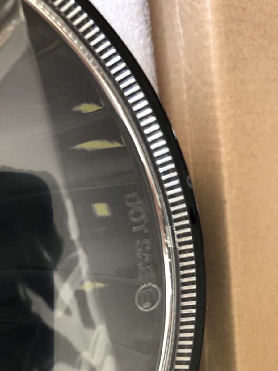

Technically, the D.O.T. (Department of Transportation) doesn't approve anything. If you are a supplier to the automotive industry, you build your parts to be compliant with the specifications that the DOT has come up with for each item that affects safety, etc.
Why am I putting this out there? Simply because many people assume (I myself at one point assumed this as well) that in order for a headlight to be street legal, it needs to have "D.O.T. Approved" stamped on it. This is not true, and as stated earlier, the D.O.T. doesn't actually approve anything, it's simply a set of specifications. Don't be fooled into thinking that just because a headlight has a D.O.T. stamp on it, that it's going to be any better than one that doesn't have it.

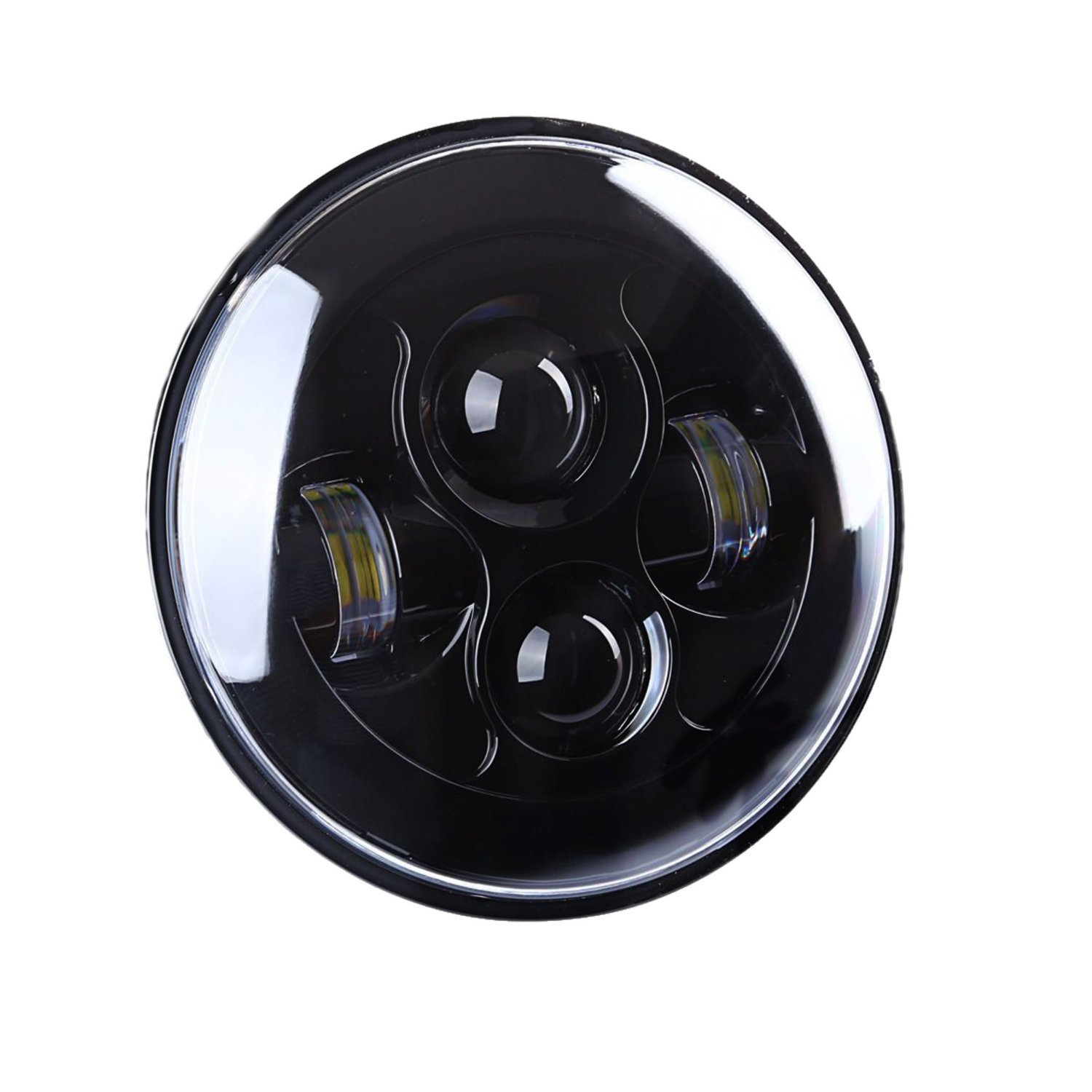

I put these in my 98 a couple weeks ago. I liked that they looked close to stock, nothing fancy. The light output is great, the definition of objects and road is outstanding. Plug and play. No flickering.
WHDZ 7 Inch Round Led Headlight... https://www.amazon.com/dp/B018JKIUF4/?tag=wranglerorg-20

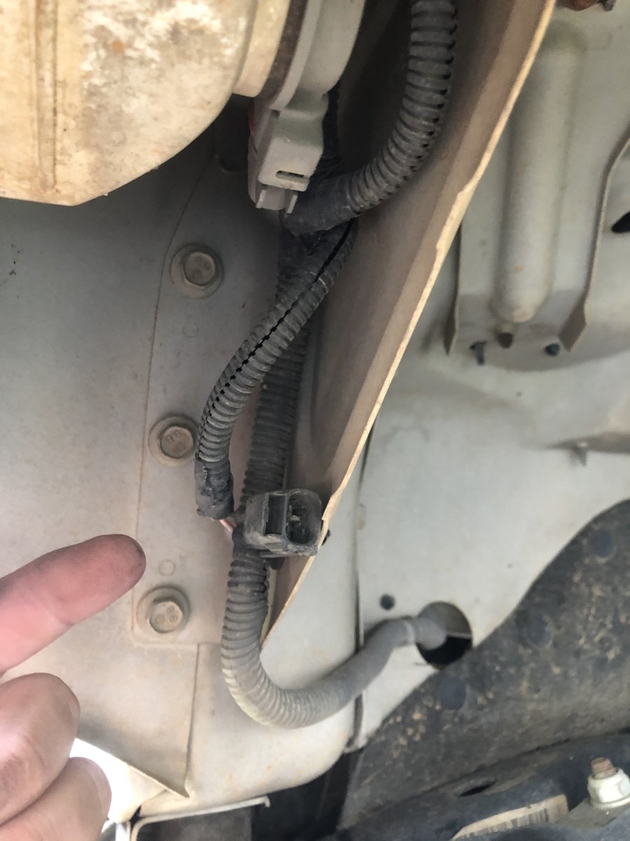

The lights installed came with DRL , I would like to wire them up. I have read to use the parking light. I was looking for a screw I dropped and noticed a connector that is not being used located beside the parking light harness on the inner fender. What does this connector go to ? I attached a pic.
Fog lamps.
