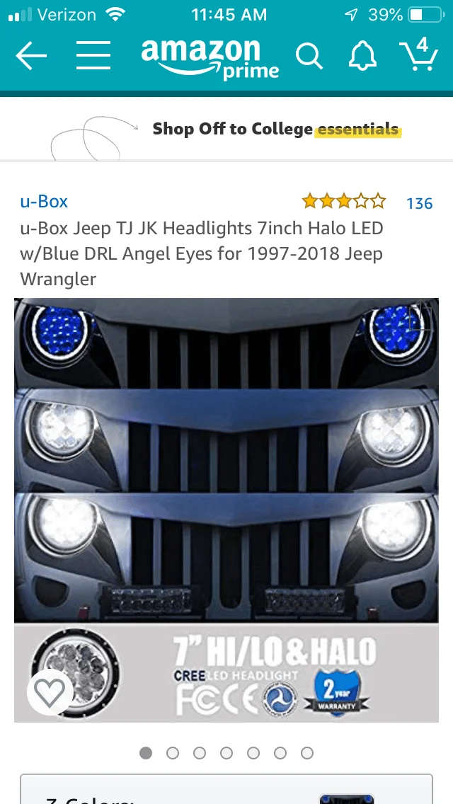

Have you heard of these lights?

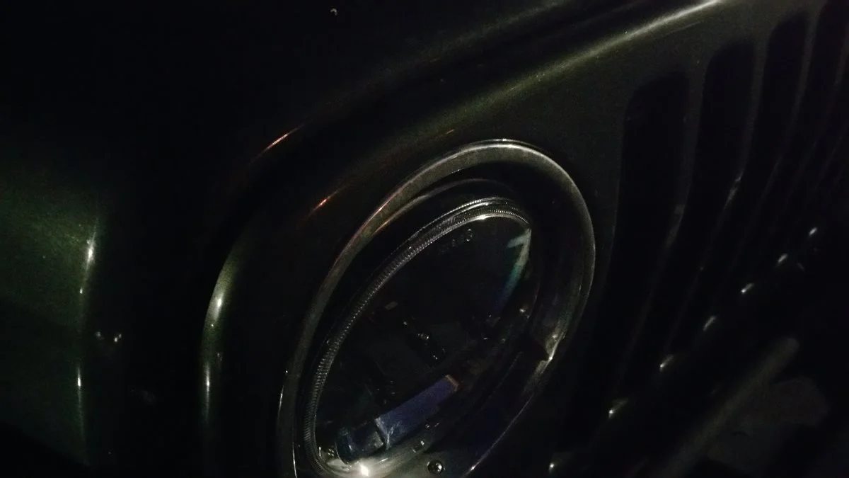

Truck-Lite (27270C) LED Headlights (Chinese Knockoff Version)
So far my opinion is split about them.
They light up road phenomenally, no complaints here, but light is very scattered. When i was adjusting them, at 25ft away i was a bit confused as to where the light focus was, it was literally lighting up the whole garage door.
To an extent i like it, because when im in the woods or some dark roads, i see everything. And those high beams can probably burn through someones soul. It even made me think 3rd time about investing into a light bar.
However, i have a feeling that one of this days someone from incoming side will fly off the road because of me unintentionally blinding them. I have them adjusted good, they are never above sedan trunk height when im in traffic, but because of the spread i always see them lighting up side mirrors of cars in front of me.
Another thing is, i am almost at the peak of adjustment range, and because of that they look at bit retarded.
Lift or weight load on my jeep may or may not have effect on the angle, but even if it is a little bit not proportional, it should not effect it so much to cause such extreme adjustments.
Mine as well. They're adjusted like yours and there was difficulty inserting the top screw on one of the bezels.
