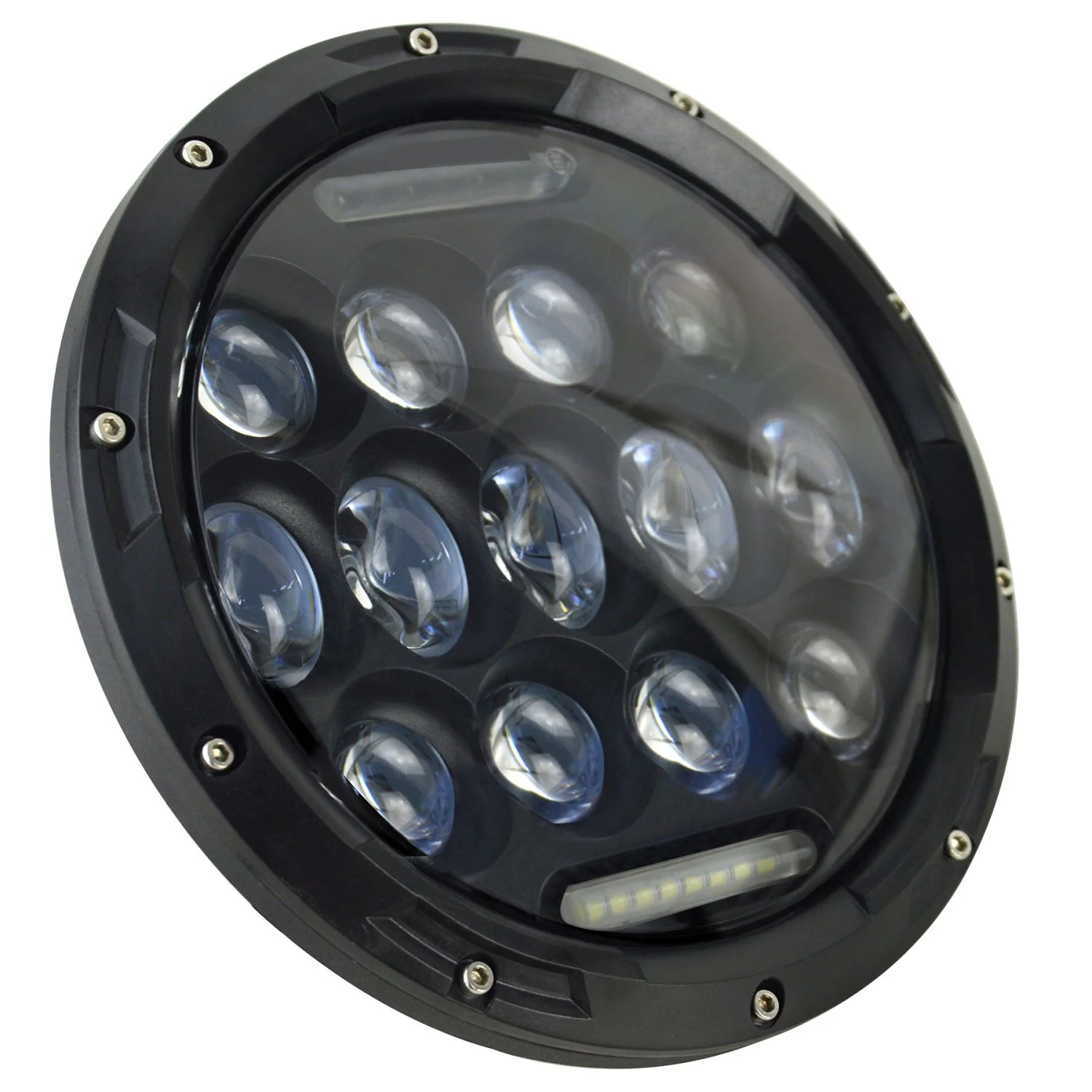

My headlights aren't noticeably 'out of place', but just one had the bezel screw issue. I could probably manipulate the headlight's other adjustment screw to gain clearance for the bezel's hole.
I think mine are scattered. It's definitely difficult to understand where they're specifically pointing.
One of my Truck-Lite knock-offs seemed much more brighter than the other and I thought they were returns because the box arrived all taped-up. So I returned them and ordered a second pair. Same thing with the second parcel - it was taped shut and looked like possible returned merchandise. The lights were of equal luminosity, though. So I kept them.
My grand plan if I ultimately don't like these headlights is to pass them onto my daughter's TJ and try a different brand/type. I'm anxious to get my TJ up to the mountain home and try it out on trails and at night. That will be the true test for the headlights' worth. But that opportunity will be some time in November...

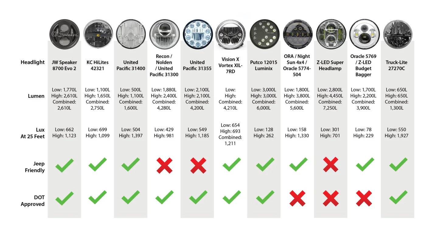

Here's a rating comparison of some of the more popular LED lights for the Jeep Wrangler TJ:

Be aware that when choosing an LED light, there is way more to it than simply which one has the most lumens. A perfect example of this would be the Truck-Lite 7" LED Headlights. While they don't have as many Lumens as some of the others, it doesn't matter, because the reflector housing in which they are in provide a far better light output than almost any of the LED lights on this graph.

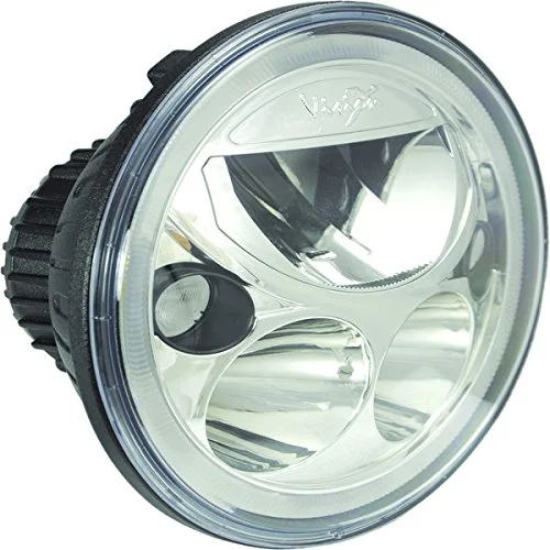

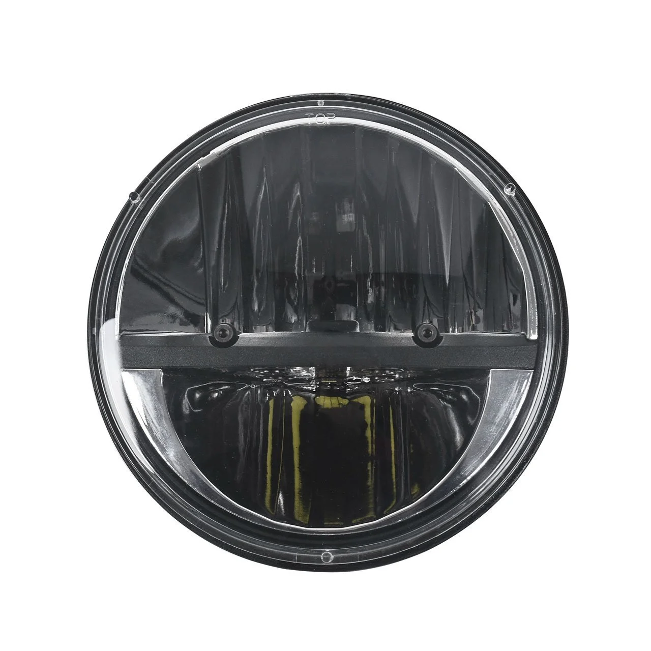

Don't be put off by the outlandish price of these headlights. I switched from my Truck-Lite (27270C) LED Headlights to these things, and I am absolutely blown away by how nice of a headlight this is. If you're one of those people who considers yourself a lighting snob (that's how I am), I assure you that these headlights are the one you want. These things are the cream of the crop. Both the way they look and the way they perform is outstanding. They are made in South Korea and include a lifetime warranty (how many other manufacturers can say that?). The quality of these things is apparent not only by looking at the packaging they come in, but also inspecting the headlights up close. The Vision X Vortex outperforms all the other LED headlights on the market, and looks outstanding while doing it. They offer a halo LED ring, as well as the ability to run both your high beams and low beams at the same time (with the optional Hi4 harness). These headlights easily win my top pick, and if you have the money, then you honestly should consider picking up a set. As far as I am concerned, there is no better light out there than the Vision X Vortex. My Truck Lites were amazing, but these outperform even my Truck Lites! These headlights will work on both JKs and TJs, as they come with adapters for both!​
If you'd like to see my review of the Vortex Vision X headlights, you can find it here: My review of the Vortex Vision X LED Headlights
Ask around among any Truck-Lite owners (myself included) and 99% of them will have nothing but praise for these headlamps. It's absolutely shocking how good the light output is on these things. I went from stock sealed beam headlights to these things, and it was like shock and awe the first time I drove at night with them. Even on completely unlit roads, these things illuminate so far ahead of you that it's almost like you're driving in the day time. Don't assume that just because these don't have the sophisticated appearance of a light like the JW Speakers, that they aren't as good. Quite the opposite actually! The reflector housing in these things provides a very defined light output. There's a lot of other LED manufacturers out there, but in my opinion Truck-Lite was the first to the market with these things. They're used by the U.S. Army on many of their vehicles throughout deployment in Iraq and Afghanistan. They also make a heated version of the Truck Lites as well (for those of you who live in extremely cold climates). These would be my second choice.

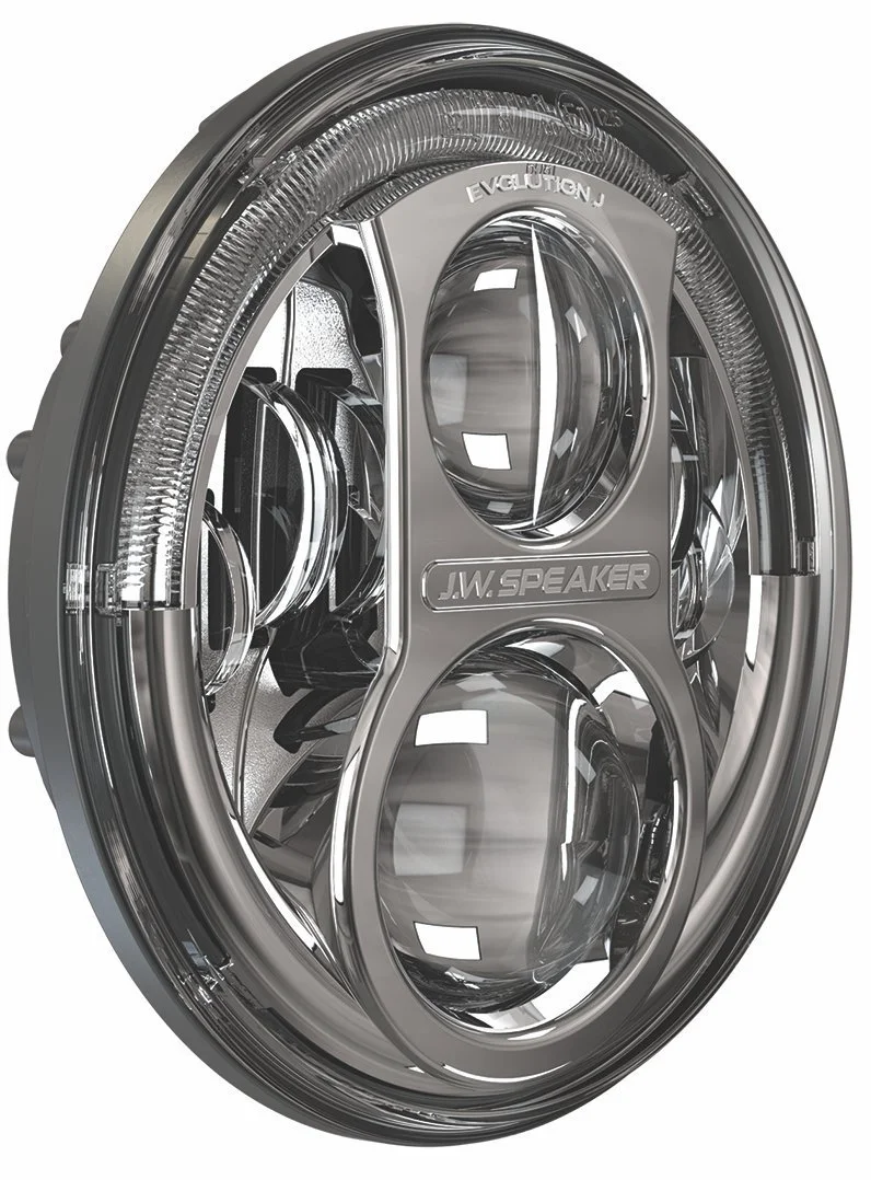

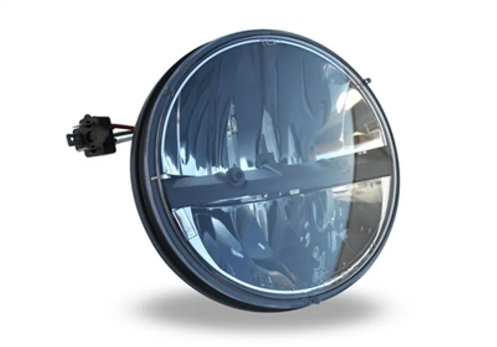

These JW Speakers have a proven history of being one of the brightest available headlights out there for our TJs. Thee headlights are run by a lot of Wrangler owners, and therefore they have a proven track record with the quality to back it up. Available in black and chrome. They're not cheap, but the light output and quality easily make them worth the price. These would be my third choice.​
The Gravity Pro is the latest 7" LED headlight for the Jeep Wranglers. It further improves on the previous KC model (42321) by combining both a reflector housing and a projector lens. The light output is crisp, clear, and has a nice, sharp cutoff, thanks to the projector lens. In addition to that, these things provide an aggressive look, without going over-the-top. You won't find an halo rings here, just pure, quality lighting from a reputable manufacturer whose been in the game for a long time. Since these headlights are designed for JKs, to make it a plug and play situation, you'll need some H4 to H13 adapters.​
These things look a lot light the Truck Lites, and all the reviews I've read say that the light output is on par with all the other top choices. They cary the reputable KC brand name, so these are a solid buy for sure.​
Without a doubt, if you have the money to spend, these are pretty widely regarded as the brightest LED lights available for our TJs. Available in black and chrome. They're spendy, but the light output is second to none. In addition, these things are hands down the best looking LED headlight out there for our TJs in my opinion. Since these headlights are designed for JKs, to make it a plug and play situation, you'll need some H4 to H13 adapters.​

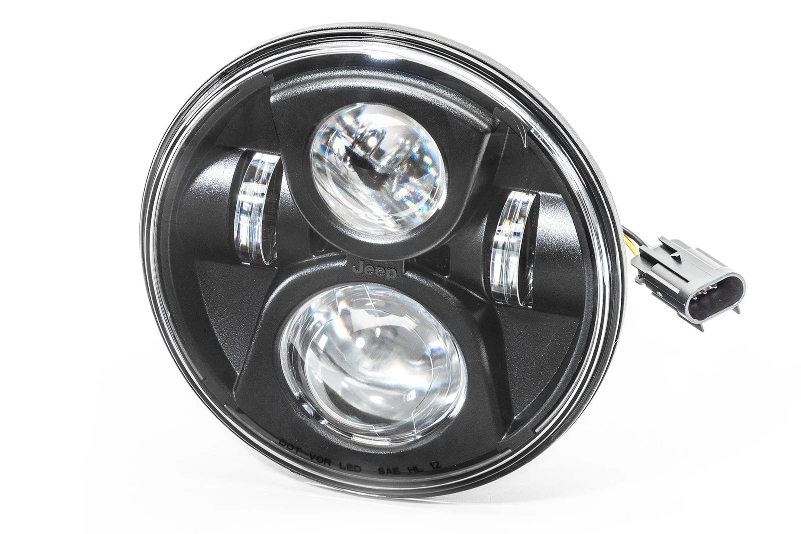

Factory Mopar LED Lights (stock on 2014-2016 JKs)​
These are the factory OE LED headlights that come as an option on the 2014-2016 Jeep Wrangler JKs. They're around $800 for the option (when you ordered your JK brand new), and from what I can tell they are identical to JW Speakers, but they have the "Jeep" logo imprinted on them, which is pretty awesome. They are a 100% plug-and-play headlight for our TJs. Since these headlights are designed for JKs, to make it a plug and play situation, you'll need some H4 to H13 adapters.​

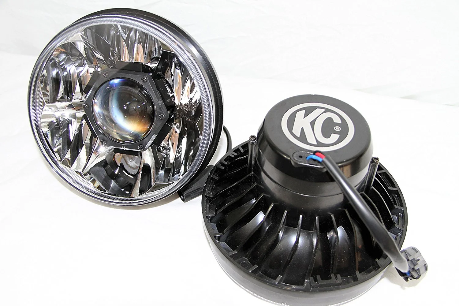

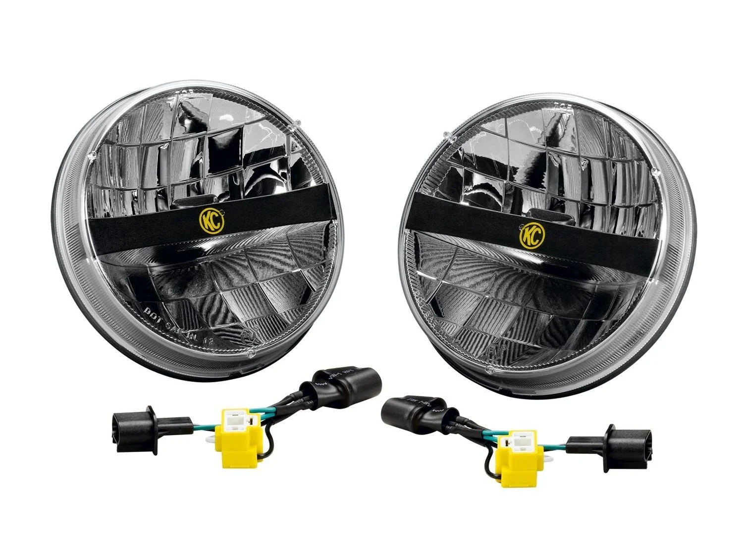

If you're a big fan of the JW Speaker headlights, but not a fan of the price, try these out. They're identical to the JW Speakers but at a fraction of the price (note that the price is for TWO headlights, not one). I'd be willing to bet dollars do donuts that these things are just as bright as the JW Speakers, and no one would ever know the difference. Gotta love the Chinese for putting out a cheaper version of the same headlight.​
I can't attest to the quality or light output of these things since I have yet to see anyone running them. However, I'm certain it can't be bad, and for 1/3 of the price of Truck Lites, I guess this is a good and affordable headlight for most. I wouldn't hesitate to purchase them either, since Amazon is really, really good about their return policies. Next to the Truck Lites, these would be my second choice, and I say that only because I know first hand how well the Truck Lites perform. For a good read on how these things perform, check this thread out: Replaced Headlights w/Truck-Lite Knockoffs

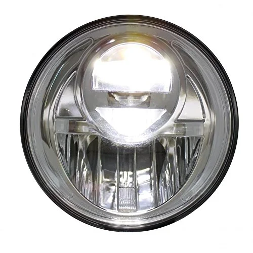

While I've never personally used these, I love the way they look. I also like the fact that they're available in both chrome and black. The chrome ones look like they'd maintain a lot of the "stock" look of the factory headlights.​

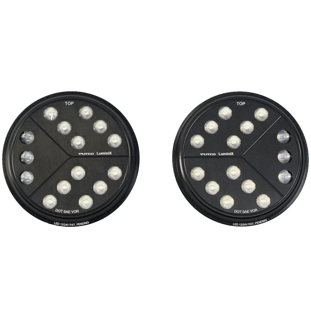

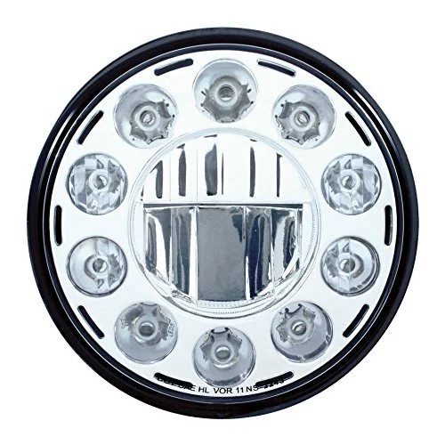

Another option from United Pacific, and I admittedly like the chrome as well!​
These things look bizarre. Almost like something you'd expect to see in "Close Encounters of the Third Kind". However, the have a more lumens than any other LED light out there, and if you're looking for that futuristic look, then I wouldn't rule them out. Given the low lux value of these lights, they're going to be much more of a "flood" light as opposed to a "spot" light output. This isn't necessarily a bad thing, as a a flood type output is ideal for driving on roads.​

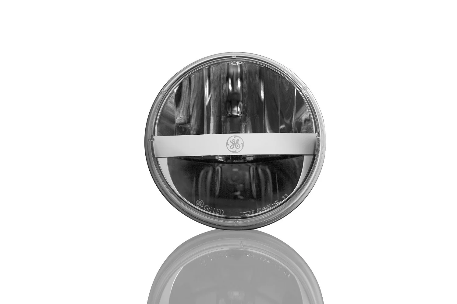

The reviews for these are almost all positive. I've never seen GE offer a headlight before (which is interesting), but given that they look nearly identical to the Truck Lites, I would have to assume that they are a LED headlight that performs very well.​

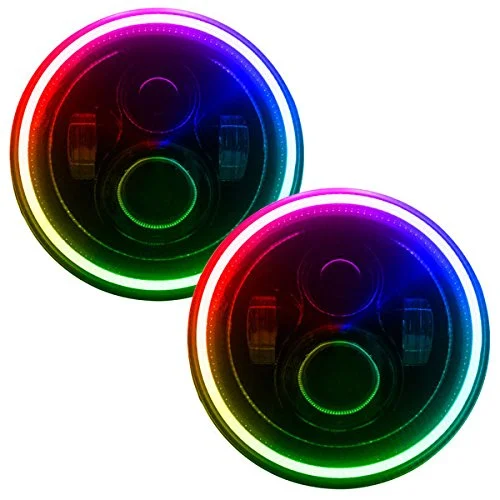

Halo LED Headlights (with built in turn signals)​
I've personally spoken to about a dozen people with these headlights who really like them. I I personally don't care for the halo look at all. However, everyone has different taste, so if you're looking for that halo look, these are a very highly reviewed option with fantastic light output and the ability to make your turn signal integrated with your halo! A perfect option for those of you with aftermarket fenders.​

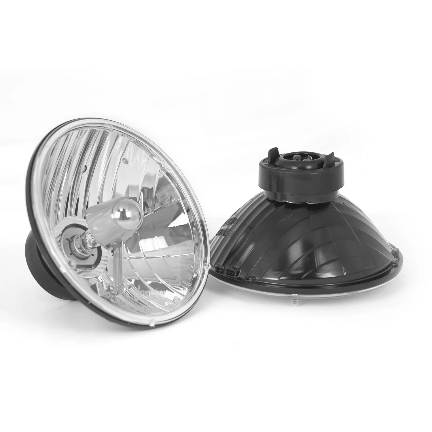

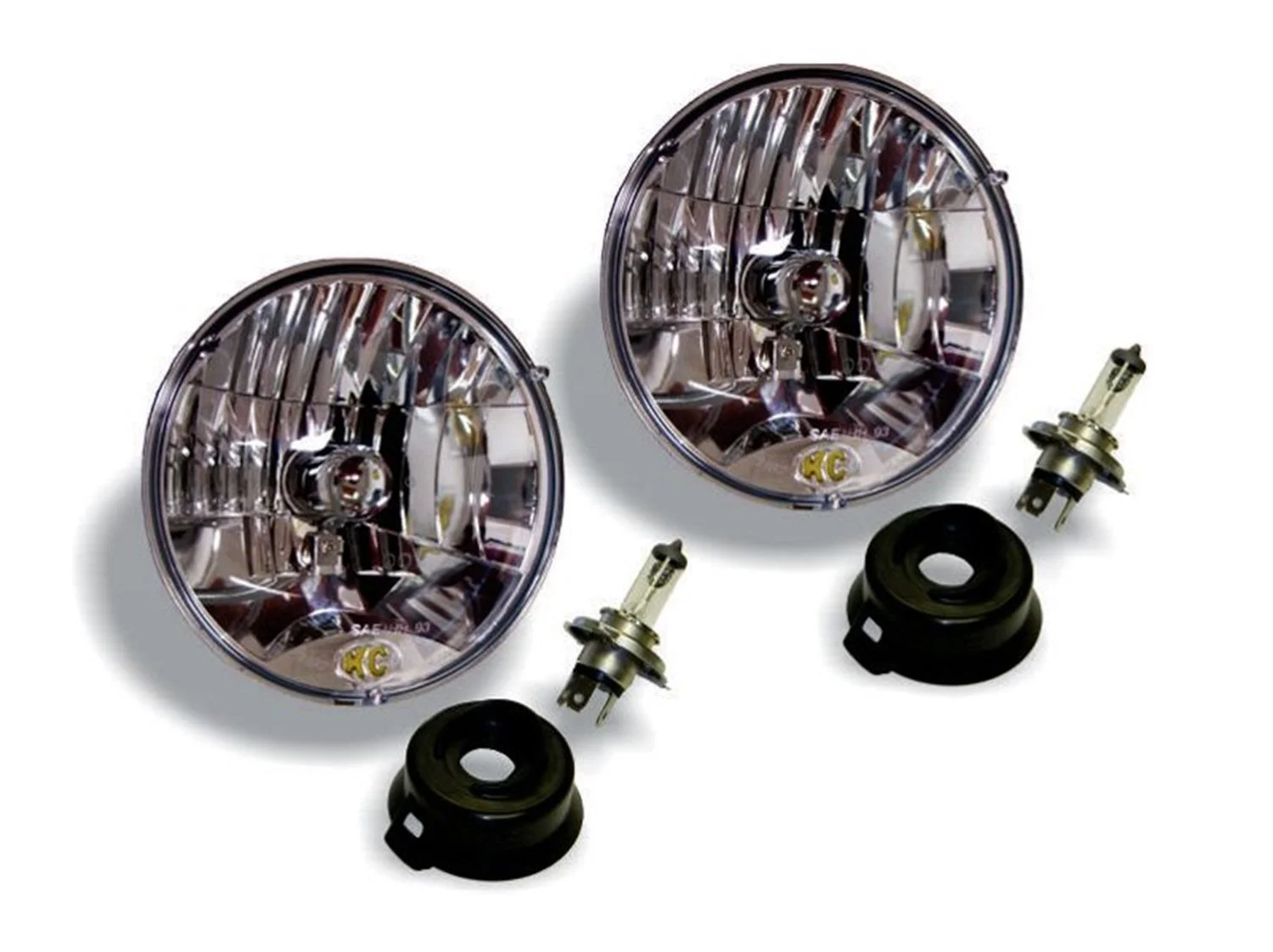

Since the stock headlights are sealed-beam, you can forget going out and buying a pair of better headlight bulbs. In order to do that, you'll first need to convert to a set of 7" H4 headlights (which are non-sealed beam). With these headlights you'll be able to replace just the headlight bulb itself (not the entire assembly) and you'll also reap the benefits of much better light output versus stock. Now I don't know why anyone would bother with halogen lights considering how much brighter (and less wattage) LED lights are. However, everyone has different taste, and if you insist on running halogen headlights, you'd be a fool to consider anything other than the following halogen headlights for your Jeep Wrangler TJ.

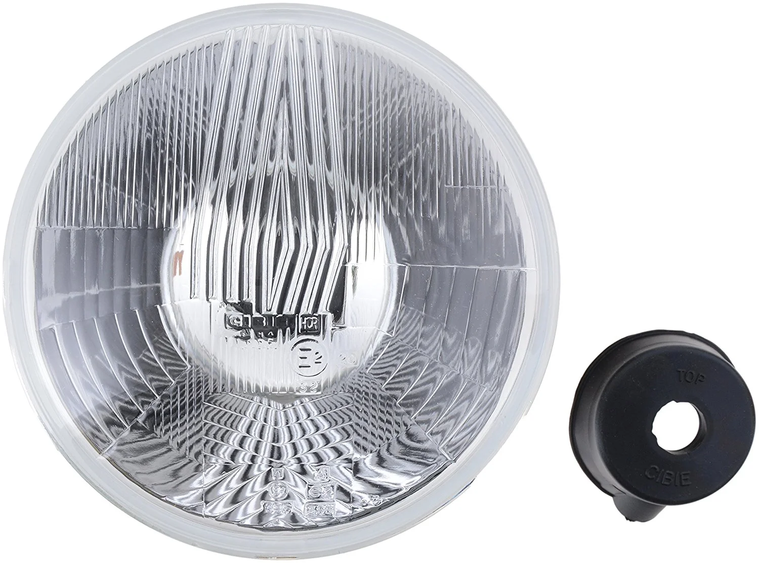

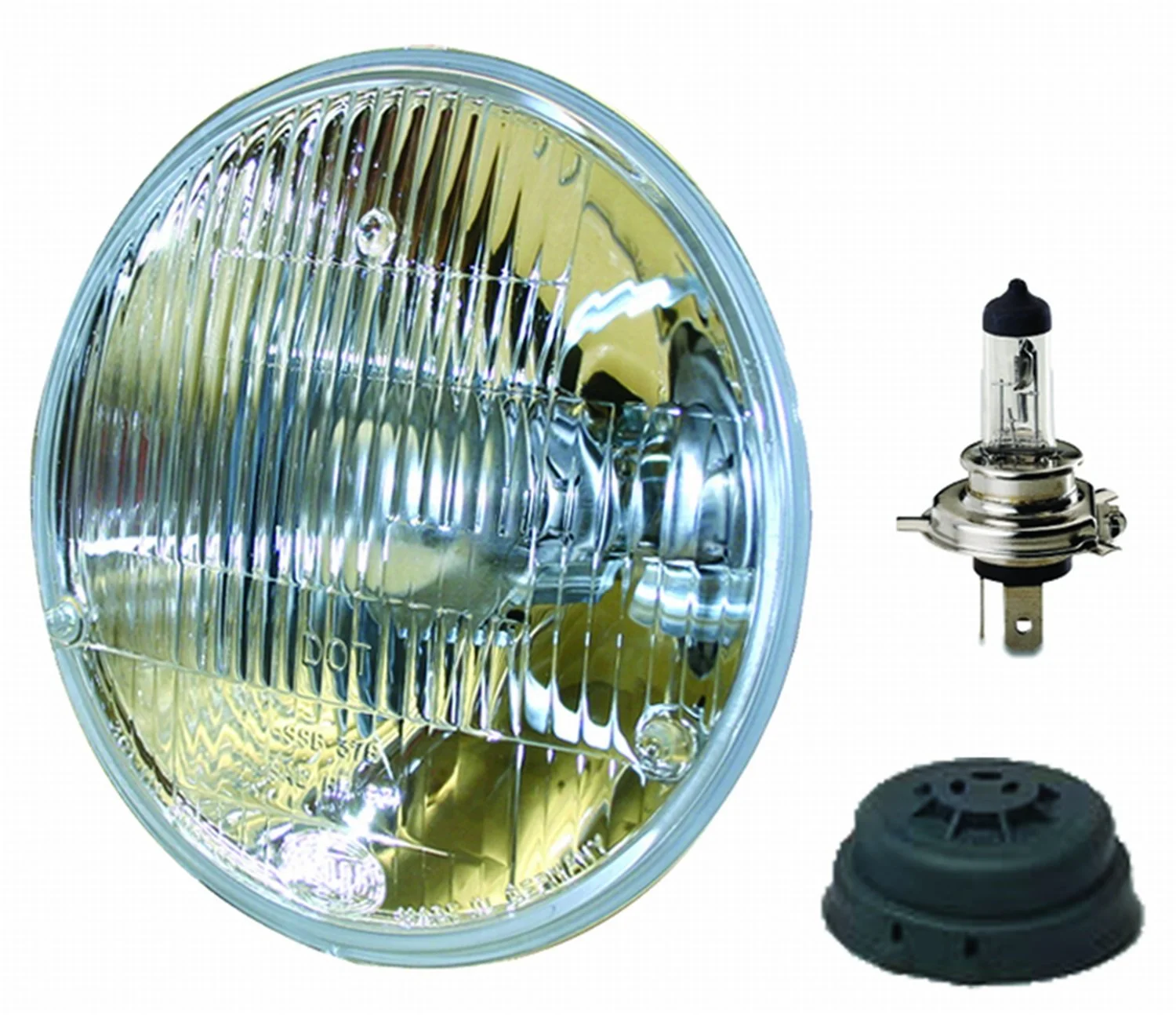

These would be my top choice for halogen replacement upgrade hosings. There have been many comparisons of the Cibie 2" versus the Hella 7" but the Cibie always seems to edge the Hella out in regards to light output just a bit.​
Often times referred to as "Hella E-code headlights". A close second to the Cibie, these 7" halogen headlight upgrades are a solid choice for improved light output over stock.​
I can't comment on these personally, but the people who are running them really seam to like them, so I'd put them right up there with the Cibie and Hella H4 lights.​
The whole 'crystal' look is just that, a look. To some people it looks really good, to others it doesn't. However, this is another viable option for a halogen headlight upgrade.​

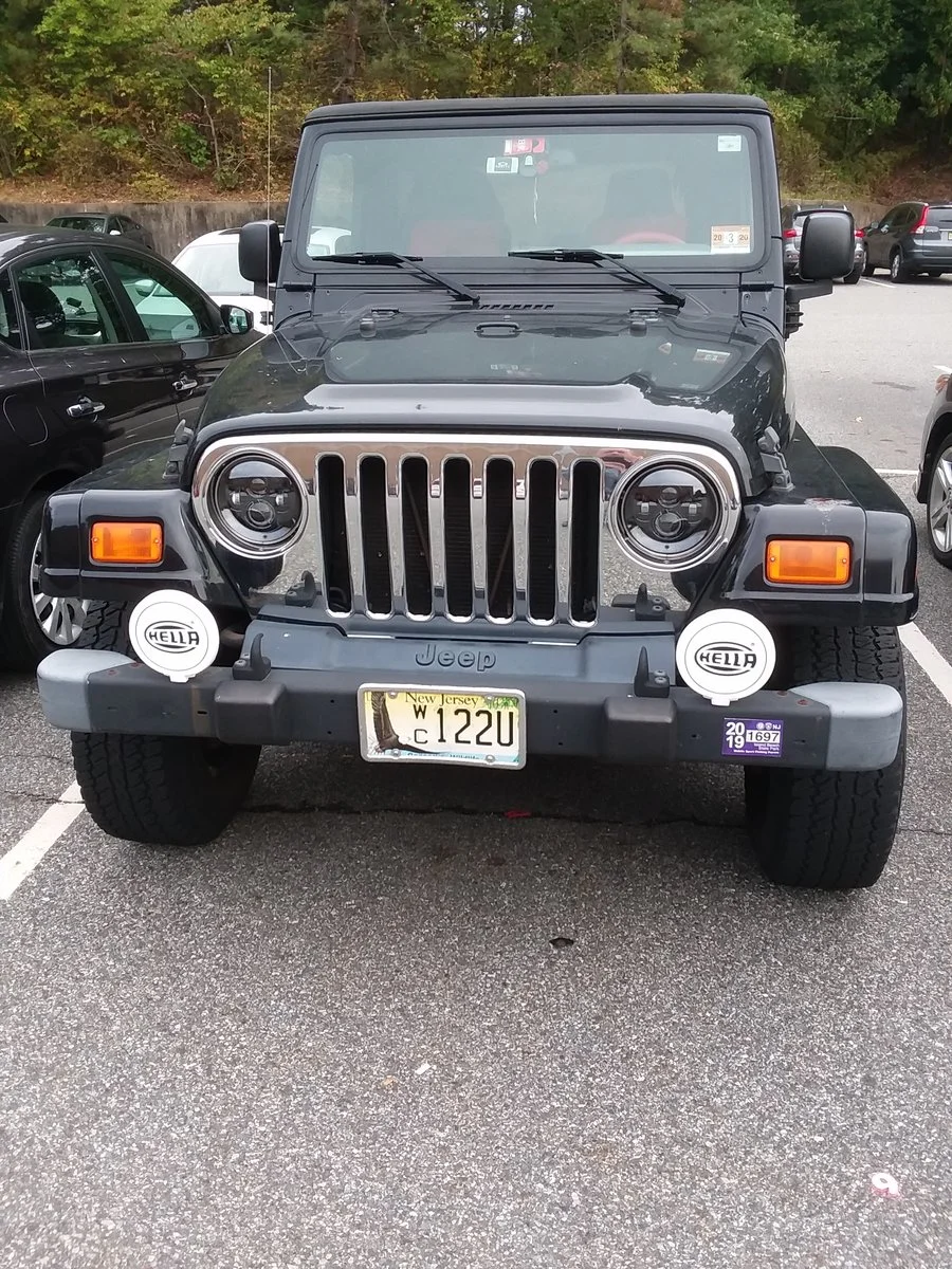

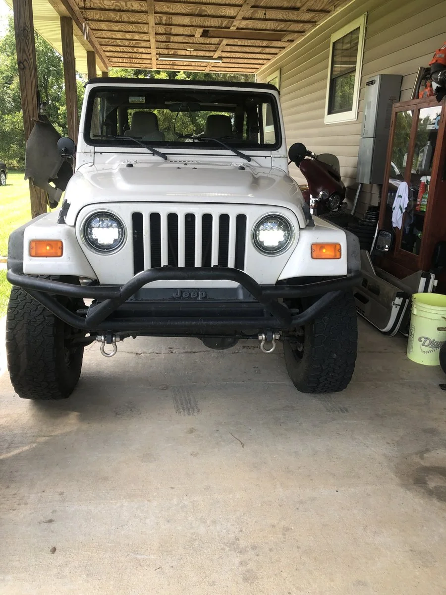

Yes, I think the regular price was $90. I figured that the blacked out look would look good in the chrome grill.
Yeah, they look good! I'm more partial to that Cree design of LED light, so if I can find them for that flash sale price, I may purchase and move my Truck-Lite LEDS over to my daughter's TJ. Thanks for sharing the pics.

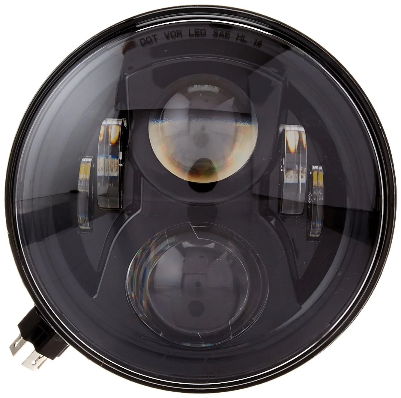

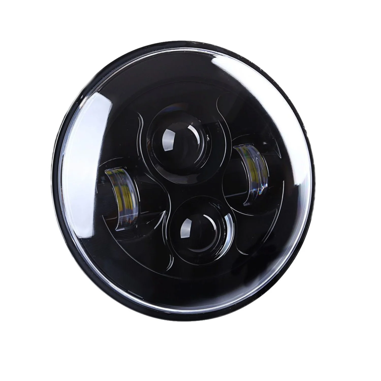

I just installed the COWONE LED Headlights , I like the look of them. I haven’t had a chance to check them out at night yet.
COWONE 7 Inch Round 5D 2019... https://www.amazon.com/dp/B0744F5ZMD/?tag=wranglerorg-20
I just put these on my jeep and had to adjust them to the limits of the adjusters (down). My TJ is pretty tall. The light output is nice. Kind of a bluish tint to it. Way better than the stock lights. Not a sharp cut-off at the top edge of light like I was hoping.
I may have over-adjusted it down in an abundance of caution. May try aiming them back up in small increments until I find the sweet spot.
I am a big fan of classic front looks of TJ and earlier models, and do my best to preserve it. However, any modification that i thrown on the front of my jeep have completely changed its character.
You on other hand managed to keep it and upgrade it in the same time. Beautiful, i love it.
