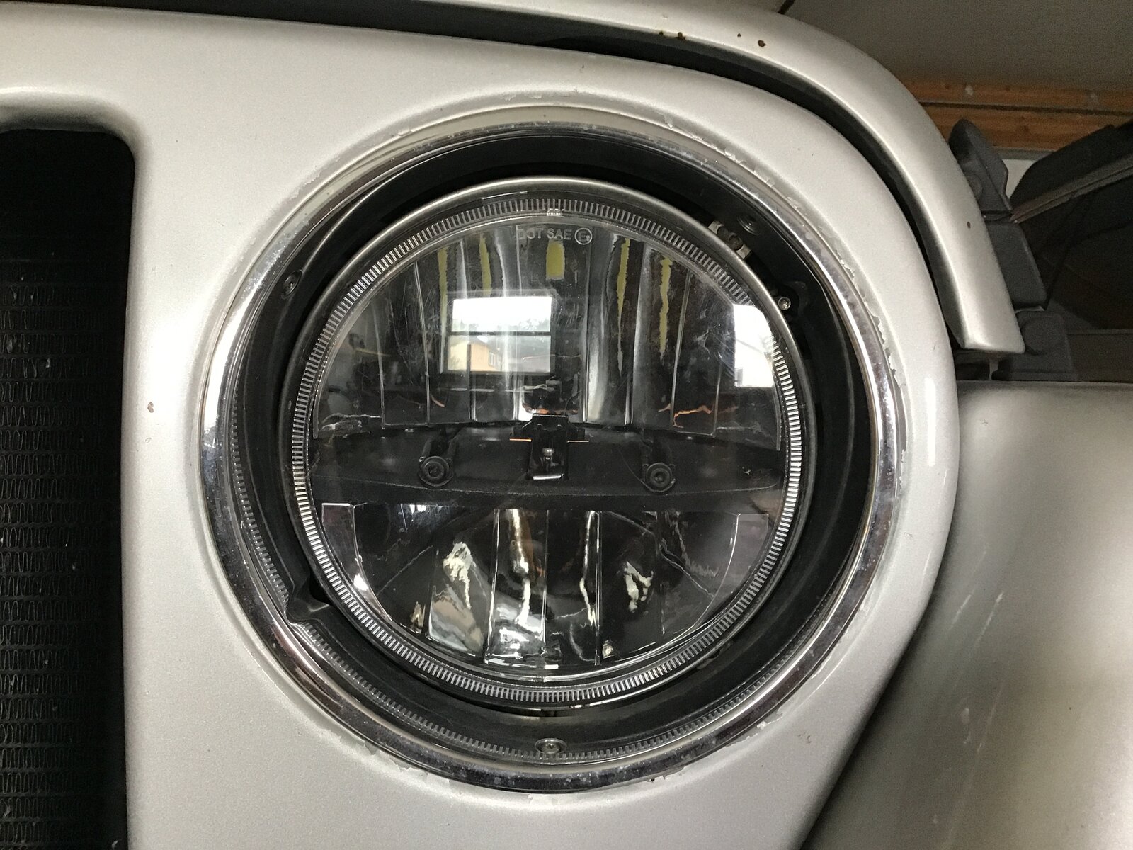

I only made it to about post 340, but wanted to add my input. Through a series of events I recently ended up with the Wagner Lighting H6024LED. The look to be similar if not identical to the TruckLite 27270c. They also retail around the same price if not more. So may be the same light. Interesting note, the box they came in along with the lens on the light says Phillips. But I don't know the Phillips model #. So far I love them. They really turn night into day on the road.

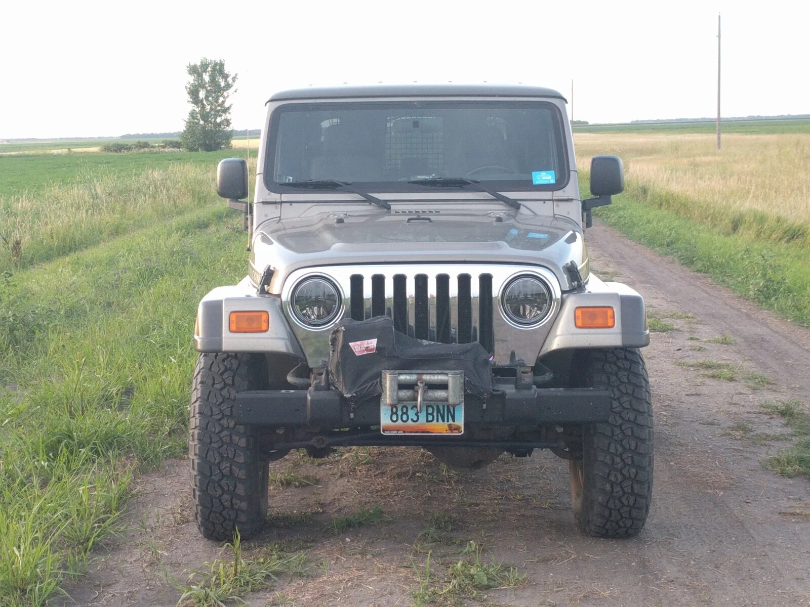

I also like the way they look with the chrome grill on my Rubihara. Clean, modern, yet simple.

I bought the TruckLite 27270C lights for my '04. Unless I'm missing something in the install, I would not be recommending them as fitting a Wrangler. The lights stick out a tad too far, and you can't get the screws back in place that hold the metal trim piece in place. I'm referring to the outer metal trim piece, not the metal ring that holds the lights in place.
I'll probably end up having to use double stick tape to hold the trim in place

I never had that issue with my Truck Lites. It's been years and I no longer have that Jeep, but this is the first time I've ever heard of this.
