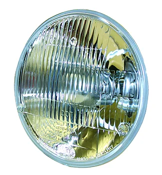

Hella 7" Vision Plus H4 HeadlightsOften times referred to as "Hella E-code headlights". A close second to the Cibie, these 7" halogen headlight upgrades are a solid choice for improved light output over stock
I didn’t read all of the thread. But this isn’t accurate.
Vision plus are not E-codes.
Vision plus was created with flutes that are DOT compliant. A true E-code lens is not DOT compliant. Because at the time the dot regs required a dispersed light while the euro’s required a sharp horizon cut off with a flag illuminating more of the shoulder. There are different E-codes for L or Rt hand drive countries.

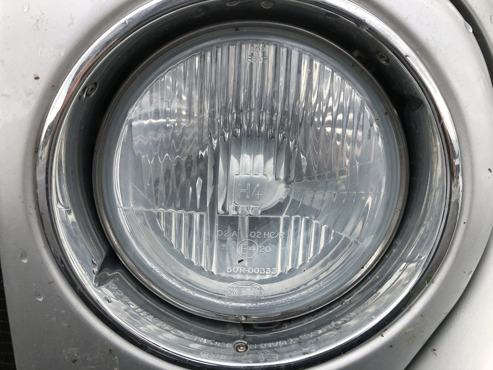

Nope, been using Hella E-codes since the early 80’s.
about the only place left to get them is Rallylights.com
this is an e-code
and vision plus
