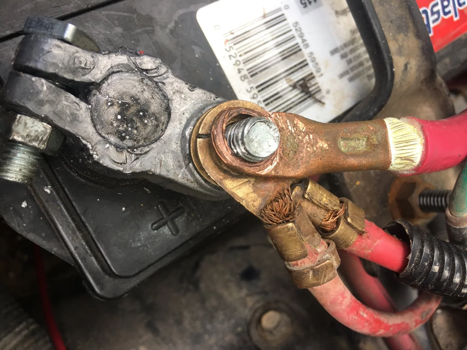

The bottom two crimps attach the fuse box & starter to battery terminal. Top lead feeds winch. This setup was done by PO. Corrosion under crimp was enough to drop voltage to starter solenoid to the point it would not even energize the starter.

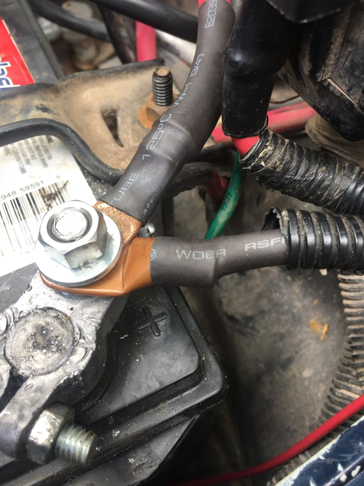

Terminals soldered & heat taped; hopefully, no more issues. My preferred winch install uses a combination sidepost/toppost battery which allows winch leads to attach to sideposts.
Looks much better, shouldn't have much problems there anymore.
