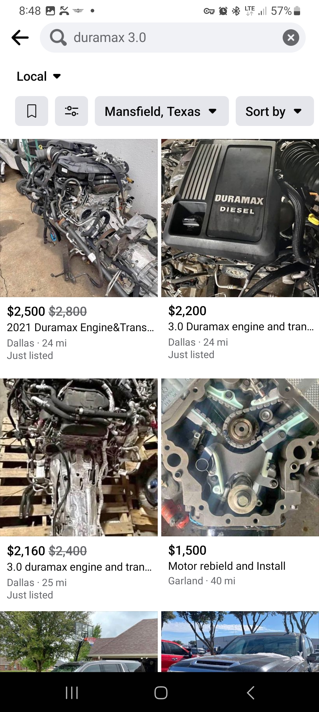

That's a problem far far off in the distance. The odds of getting the Duramax running and able to work in the Wrangler are far from good. I can't even connect to the ECM right now as it doesn't have direct communication to the data link connector. So my first list of parts so far are: Serial Data Module, Pedal Position Sensor, Mass Air Sensor, Fuel Pump Module, Fuel Pump and Fuel Filter-Water Seperator-Fuel Heater Assembly. It will also need a tune that costs $700+ just for the credits.
