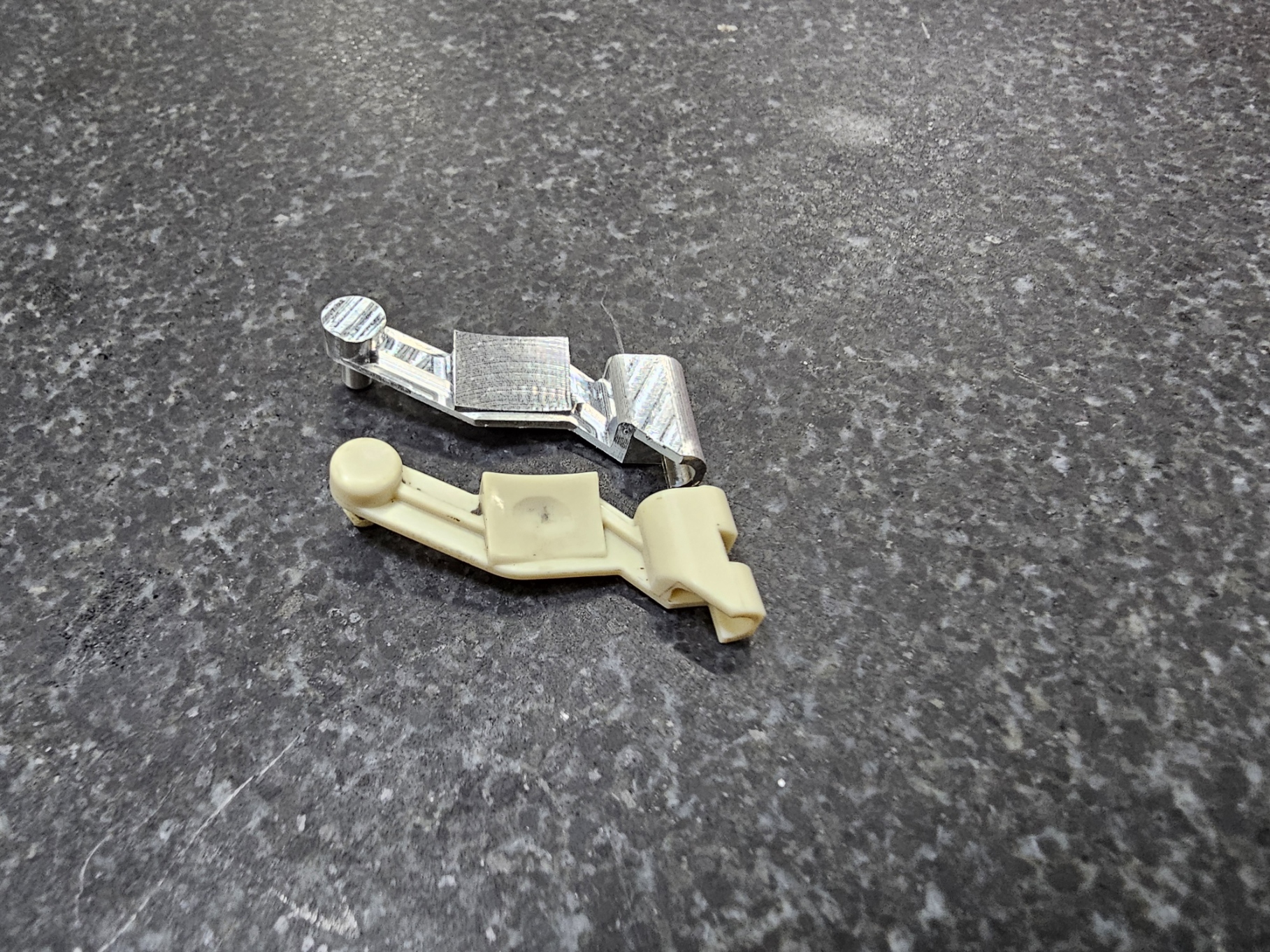

I'm working on a little side project. My multi-function switch failed again leaving the fog lights on. I had previously repaired the lever inside with some JB epoxy, but it wore another groove in it. I'm testing this replacement part to see if it will hold up long term.

That looks like some challenging mill work. Nice.

My multifunction switch is also failing (turns fogs on by itself intermittently).
This would be a good solution!

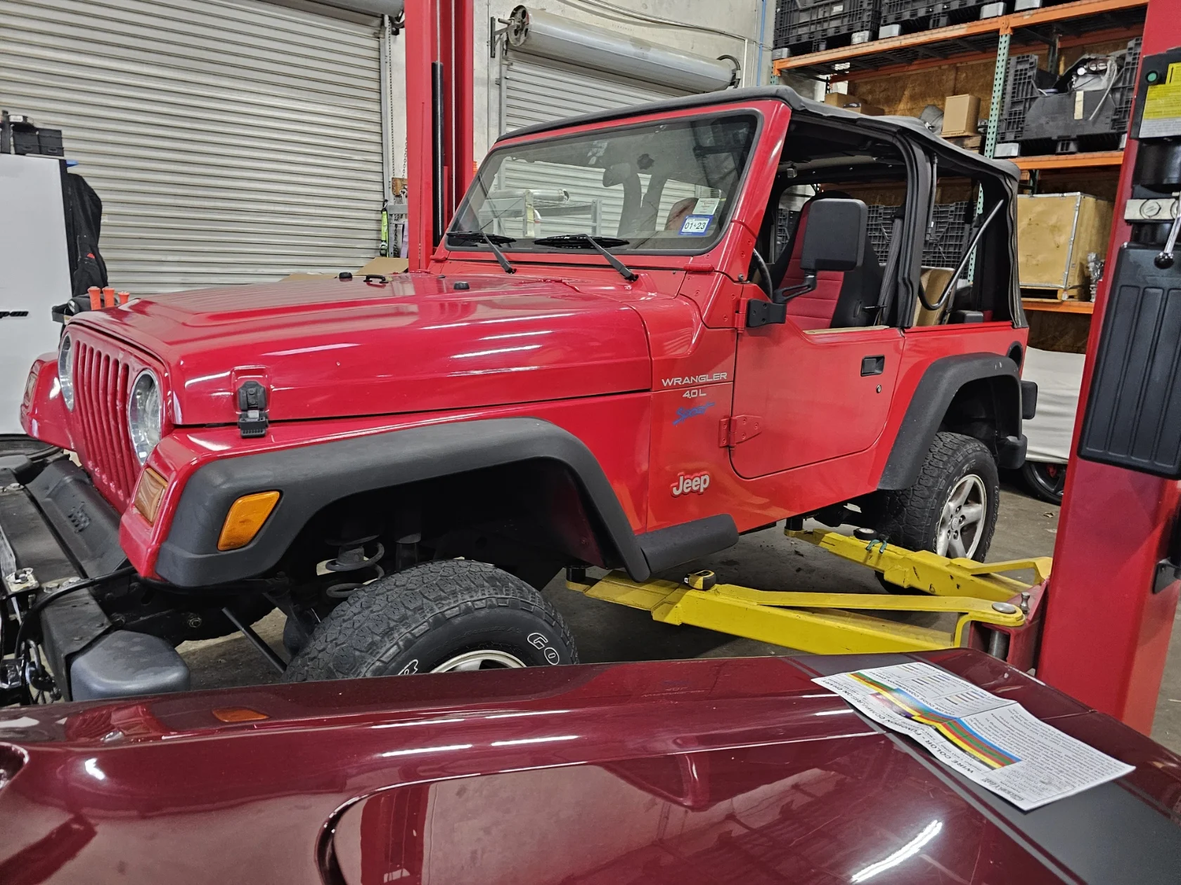

The turbo LJ is going to go on hold for a quick minute while I give this new rig some love. I want to do some videos of before and after on some basic mods. There's probably going to be another stock airbox vs video as well.
Awesome. Do you have a basic list of what you're going to test?
I want to see if it's possible to make 200 wheel hp or about 250 crank with some basic mods. Basically I think I can disprove or maybe verify whether or not basic mods make a difference on the 4.0. I don't plan on going any further than possibly a cam. Most likely a header, cat back, windstar intake, throttle body, tune, then maybe cam and thin headgasket. I think it's got 200 on tap, but we'll see.
Manual trans? That'd make 200 whp easier right?
I'll guess tuning, or just simply getting more aggressive with timing than factory, will give the biggest bang-for-the-buck.
