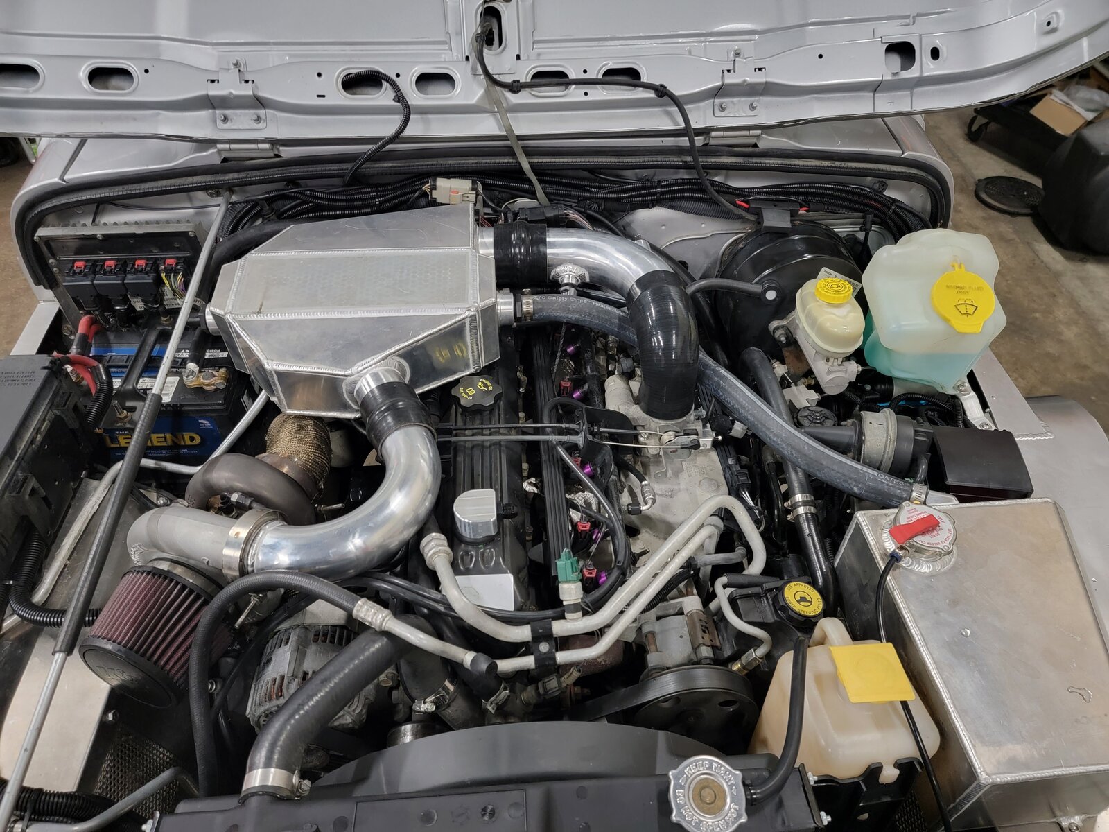

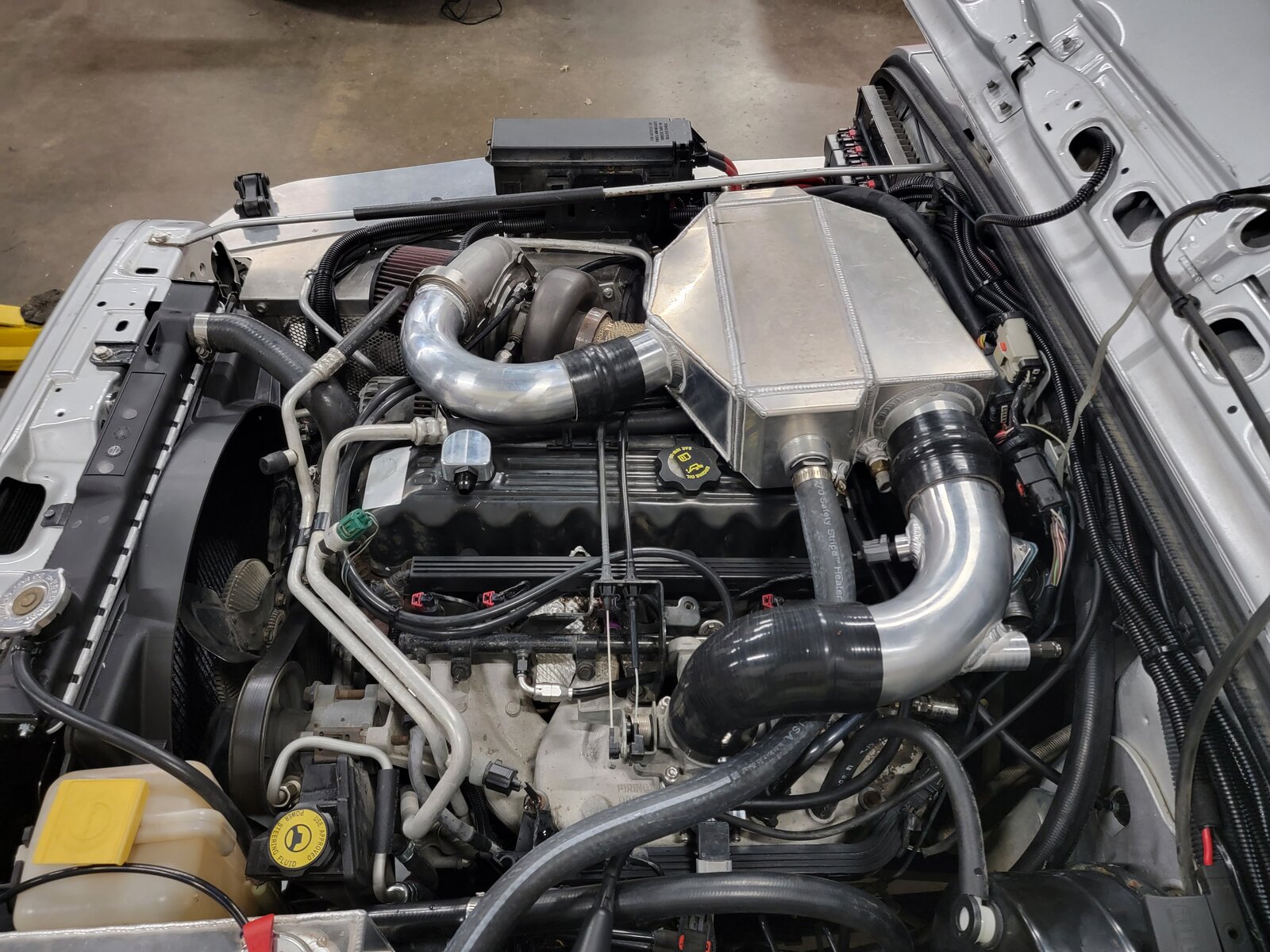

I wrapped up the intercooler installation yesterday. It's a tight fit.
Looks amazing and super beefy for cooling. Is lag a concern when using the larger cooler and tubing?
I sure can be. It's more of an issue on vehicles with a front or side mount intercooler and large piping. The more volume the turbo needs to fill the longer the lag.
The real question is this: Is the trade off of a little increased lag worth the additional power from the resulting cooler air charge? My guess is probably.
