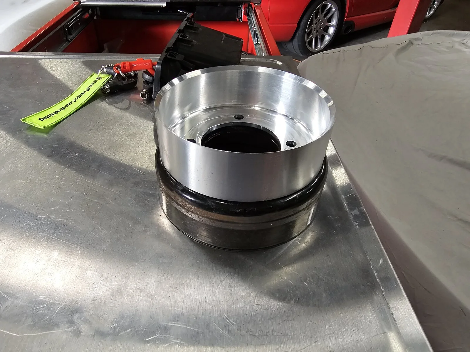

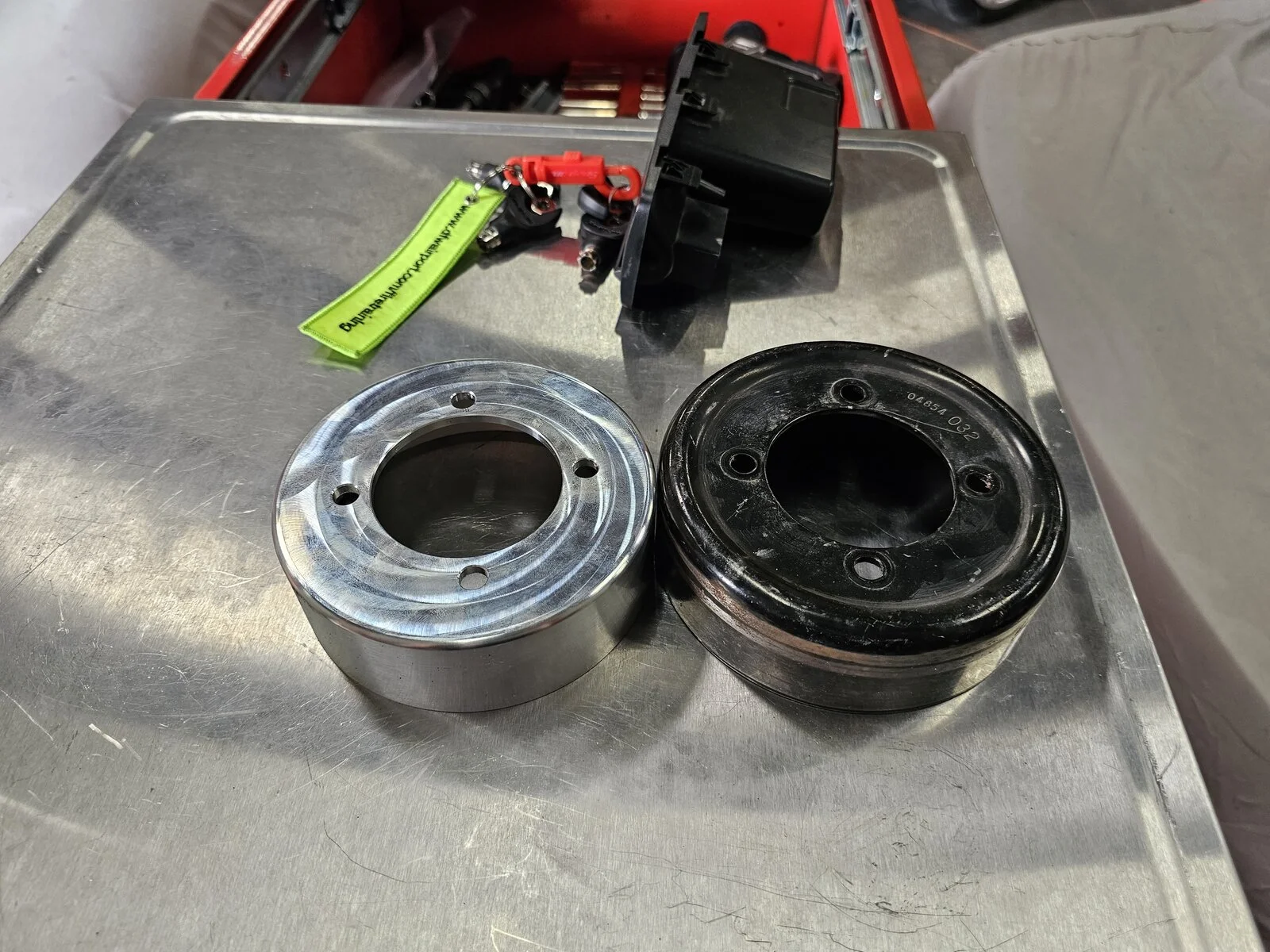

The water pump impeller seems like it knocked 5 degrees or so off the running temperature. It certainly made more difference than the hood louvers. That being said it still is getting warmer at idle than I would like with the AC on. I cut a overdrive pulley for the water pump to test. It's about as small as physically possible. I calculated it at 9% overdriven. It should help the fan and pump at idle.

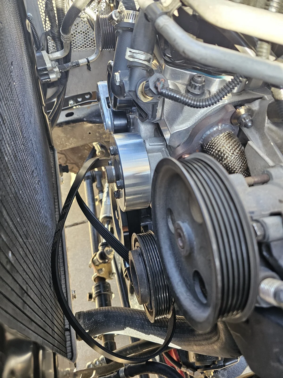

Update. So far the overdrive pulley seems to have made the largest difference, especially at idle. I did have to get a slightly shorter belt to fit properly. The stock belt worked, but the tensioner was almost maxed out. Driving in 100+ degree the temp would hold 208-214 with the AC on. If I let it idle with the AC it slowly moves to 216 and seems to level out there. I have a radiator manufacturer that produces the Viper radiators for us. They have a core that I think might work well for the TJ. They use Visteon cores and TIG welded end tanks. I might order one and test it out. It seems as though the TJ has very little reserve cooling from the factory. Granted my setup is a worst case scenario compared to other builds.

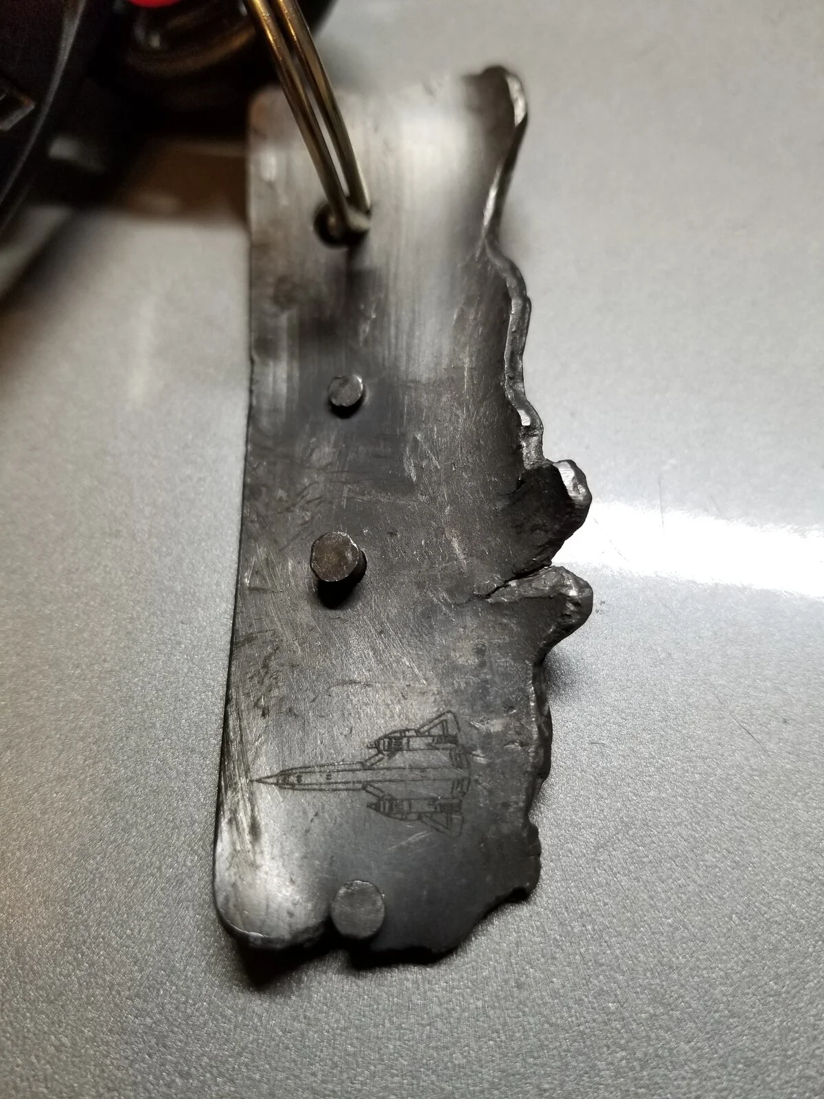

B) Is OXCART an airplane reference? 😎

B) See pic below. My keychain.

That's what I thought you were referencing. Just a fan or or were you involved with it somehow?
