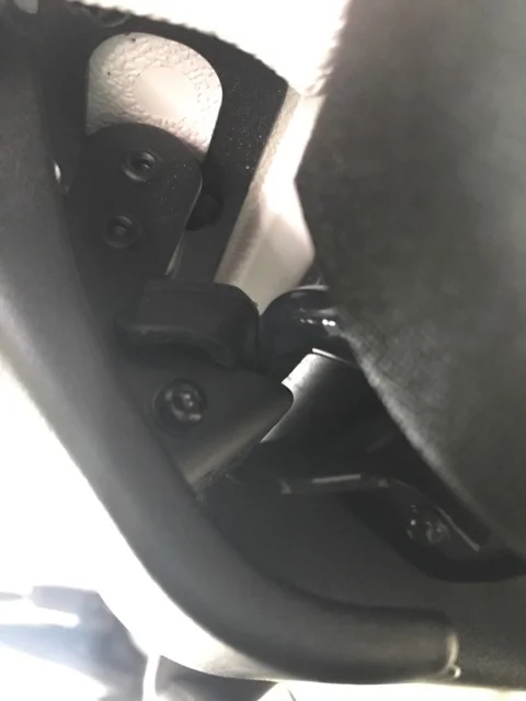

This is what it’s like. Maybe it’s right and I’m just a newbie and feels like it should latch better.

Can you open the latch, let it hang down, and take a photo of it? In your photo, the rubber foot should be under the footman loop, not behind it. I can understand your frustration. It seems the arm that the foot is on is too short. Is there any adjustment to that at all? That's why a photo of the latch open would help...

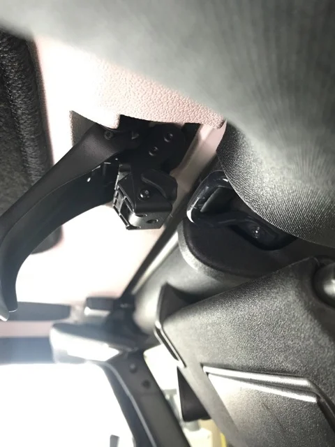

Sent a photo with it open. It’s almost like the rubber smashes in to the metal hook vs going under it
In this photo, with the latch in that position, can you push the foot forward while holding the bottom of the latch back, so the rubber foot is next to the footman loop, then close the latch, so the rubber foot is pushing up on the loop? That foot should be extended forward before you close the latch...

What I am getting at is, if you open the latch all the way back, then extend that foot forward all the way it will go (it should move forward independently of the latch handle), it should then be close to or touching the loop. Then close the big latch, and that should be it!

It might be stuck in that position, and needs to be freed up. The foot should go forward, to where it is either touching, or almost touching that loop, before you even move the latch handle forward...maybe you could try prying it with a tool of some sort to free it up.
