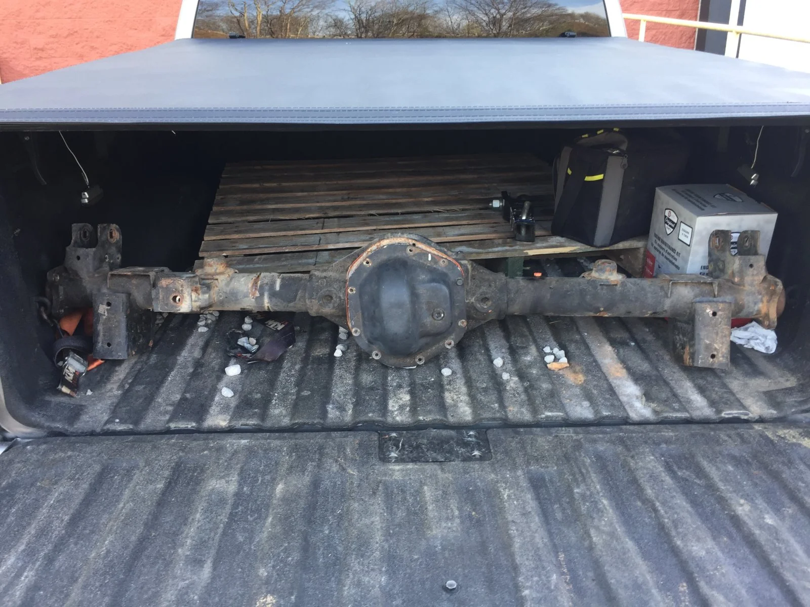

I have not seen any JK to TJ axle swaps (here), so I will do my best to document the process for the rear axle swap. I picked up this JK dana 44 for $50 and 8lbs of ground venison/2 beers and 30min of Jeep talk; not a bad deal if all goes as planned.
“Why not just do tons brah?” Because I don’t need them and the price point just getting those axles defeats the purpose of even doing a JK swap. The whole point of a JK swap was the price, I could not find a TJ Dana 44 cheap enough to justify rebuilding and swapping. Why not get the “beefier” JK Dana 44 cheap and see where it takes me?

o Axle is straight, no damage outside of typical usage
o No axle shafts/brake baking plates/hardware/etc.
o Carrier/bearing caps present; 3:21 gears/ No visible damage
Step 1: Remove JK brackets/Weld TJ brackets
o Artec JK2TJ brackets w/Truss (Non-triangulated): $424.99
o Appears the “easiest” of the available options
o Pro/Cons of trussing a rear axle? I don’t see much of a use for a truss for my needs.
o TNT Customs: $224.00 +
o Too many additional pieces to purchase, looks way too bulky/annoying to deal with.
o E.C.G.S: I only see brackets for 2.75” tubes, JK has 3.25” tubes
o Others I have not seen?
Not much reason to get beyond this point as of now, I will need to relocate the axle vent/brake line t-mount thing from P to D side, other than that, it looks like it’s going to be “cut/paste” work to get the brackets in line. Should be fun, I’m keeping the 65” WMS, I’ll just have to work out whether to attempt a front JK2TJ swap or use spacers to make up the gap on my stock TJ Dana 30.
Running Price List: Target goal: under $3000
