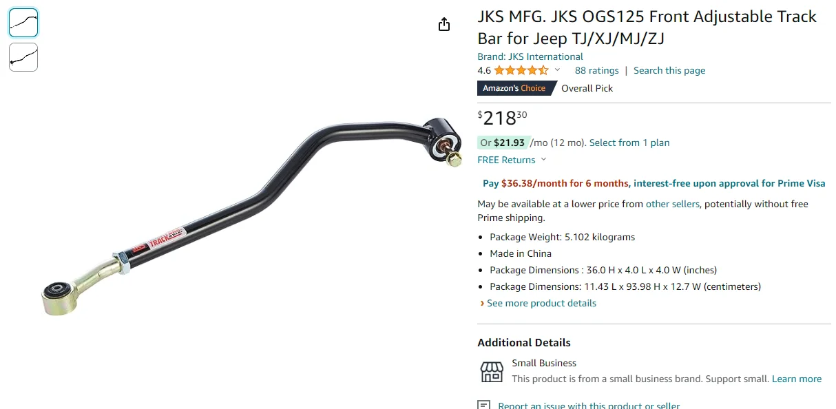

JKS can be had for $220

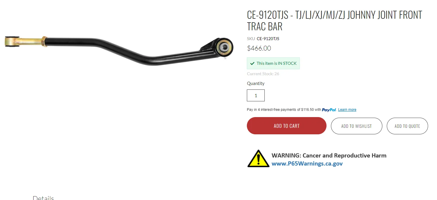

Where-as Currie is sitting heavily at $466.
Sure, I expect the Currie is probably stronger/last longer than the JKS.
But at current pricing, one could break/bend a JKS, buy another, and STILL be cheaper than the Currie.
As far as the differences between the two bars is concerned, the Currie is boasting TWO rebuildable Johnny Joints, one on each end.
Where-as the JKS only has one Rebuildable Joint on the frame side (somewhat comparable to a Johnny Joint, although not exactly), with a rubber bushing on the axle side.
While I do understand the strength/longevity of a Johnny Joint, especially on applications such as Control Arms, I'm not sure I fully understand where they would make a $250 impact in usage such as a Track Bar.
Along with the Joints being different, I've also read in a few places how the Currie causes less issue with suspension binding/contact.
Sure, the additional 1/2" - 1" of clearance MIGHT make a difference in some aspect, but I'm not sure I understand where it's enough of a difference to warrant the additional $250 price tag.

I don't think I'd worry much about the strength, and don't bother with the version of the Currie that has JJ in both ends. I prefer having the Clevite style in one end to hold the bar from flopping around, as the pitch of the bar plays into how well it stays out of my diff cover.
When I bought mine the prices were much closer and word on the street was that Currie had somewhat better diff clearance.
Both have rebuildable joints, I believe.
To me, as long as both bars don't touch the diff cover before my shocks bottom out, then I'd save my money and go with the JKS. If it cost me uptravel, I'd probably spring for the Currie.
I currently have a Currie front and a jks rear.
Currie/Rockjock allows for more suspension up travel due to the bends around the diff cover being better and the offset Johnny Joint at the frame side which further pushes the bar forward. And the joints are actual Johnny Joints. That is all that needs to be said about which is the preferable track bar.
With that foundation established, Currie/RJ is better suited for reshaping after a front stretch and building in additional up travel after a front outboard.
Short of custom fabrication, mine couldn't exist as it is without the Currie track bar in the front.

I do have a Dana 44 front, and even when cycling the suspension on jackstands, i'm nowhere close to getting any sort of differential contact with the JKS bar.
If I had about 2" of stretch in the front THEN I could see issues, but on my current specs, I can slide my hand between the differential and the Track Bar at full droop, as well as full compression. I've got about 1" of clean clearance between the Track Bar and anything else.
Hence my confusion, or maybe my own ignorance which i'll also claim.
IF Currie was still within the same ballpark as JKS as far as the pricetag is concerned, I think it'd be a no-brainer.
BUT, in my specific scenario, it seems as though it's coming down to a difference of Joints, rather than clearance issues.
So with that said, I'm still at a toss up of whether or not the additional cost is worth spending.
