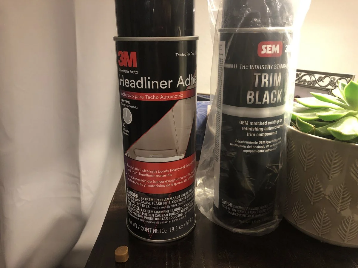

SEM Trim and the Headliner Adhesion sorta came in. Now it just needs to warm up outside.
This thing had no headliner, just a bunch of ugly stuff hanging down. I acquired a headliner. 3M adhesive for headliner should be arriving on Tuesday. This will be a big improvement for the interior. View attachment 149047
It will take twice as much adhesive as you think it will take. I just did that on my Dakota excab. PITA with all the contours.

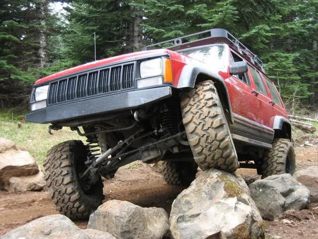

I ran front TJ flares, front and rear, in mine. It had about 5" of lift, RE back when they were good, and 33's. Of course I geared it and had frt and rear No Slips.
That’s a very capable rig. Looks fantastic too. Love the front bumper. Did you cut the body to make the TJ flares work? If so I might do that. I could get a Crown set for $100 new and cheaper if used. They look good on yours and give a bit more coverage. It looks like the fronts are on the rear and the rear are backwards on the front, if my eyes doth not deceive me. Or they are cut?
Reactions: TWiG01
For the fronts I followed the inside of the flare and cut accordingly. You remove a lot of material and need to make new supports (easy) as well as drill holes, etc. The rears, just cut and fold in the seems or you'll get into the interior, ask me how I know:rolleyes:
That bumper was designed by myself and welded by a Pirate forum guy way back.

That is good to know. I’m not looking forward to this job. Should I leave what remains from the first headliner? Or pull it all out?
I pulled the headliner substrate from the vehicle, removed all remaining headliner, sanded the old adhesive off (gently so you don't damage the substrate), then attached the new headliner. Lay the headliner down then fold it back on itself halfway and apply adhesive to both surfaces. Follow the instructions for the adhesive you are using for drying time before bonding the two surfaces. The reason I say it will take twice as much adhesive is if your headliner has a foam backing it will absorb the first coat and you will need to apply a second coat of adhesive. If you have any questions just give me a shout.

Geez, PITA. Thanks for the help. I wish I could turn the XJ upside down for this! 🤣
