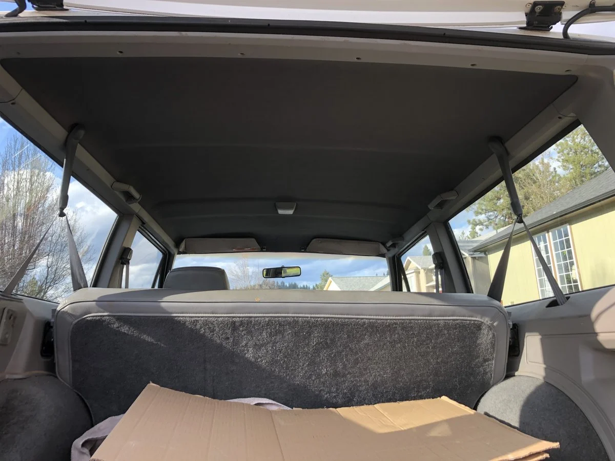

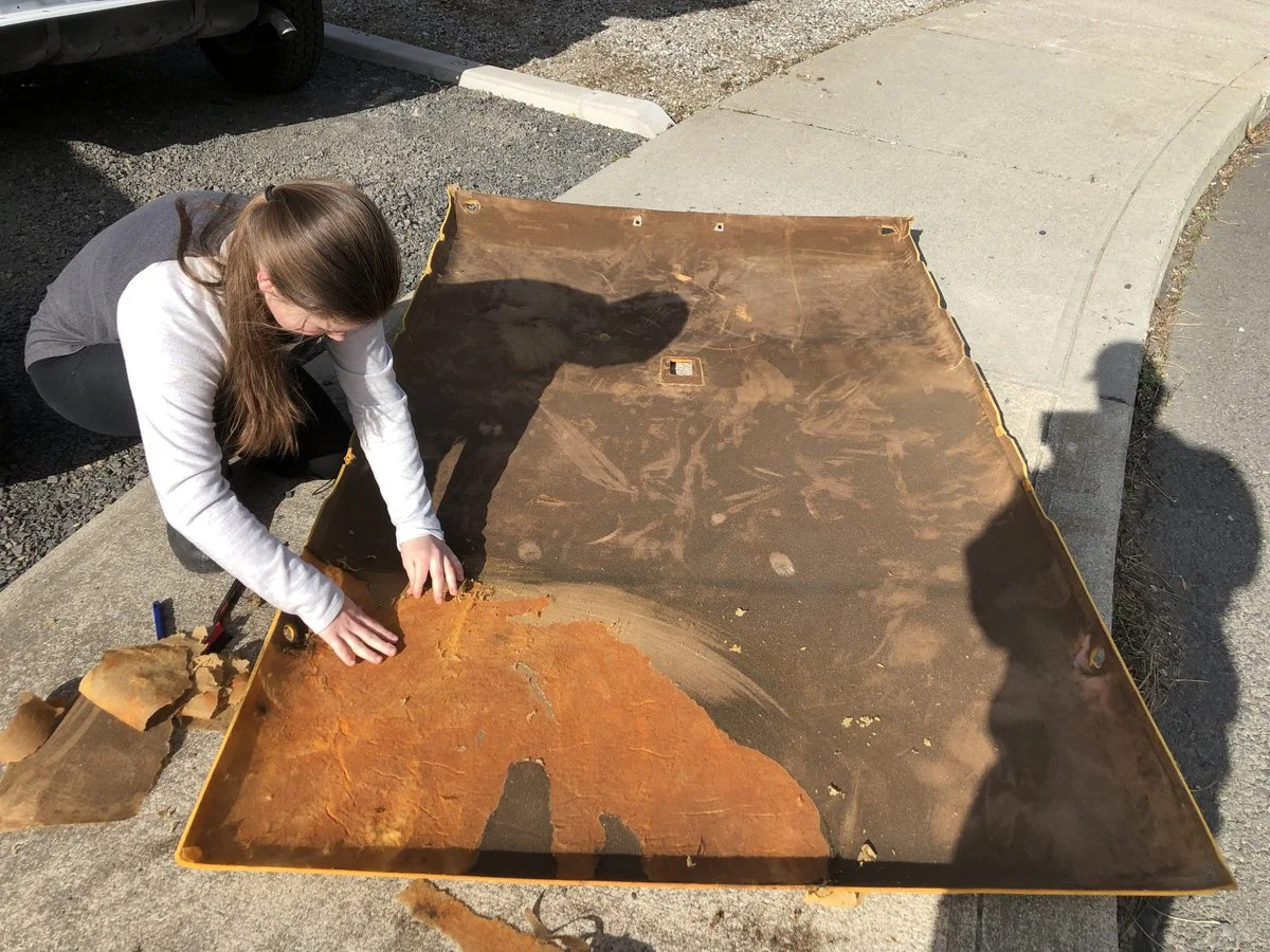

This XJ has no headliner. It was the first thing my daughter noticed and said she wanted fixed. So we researched, got the headliner, 3M headliner adhesive, and went to work. These can be a pain.
you’ve got to pull the headliner, then clean all the old residue off.
Then you can spray lots of adhesive on both surfaces.
It turned out nice.

That looks great!
Is the old adhesive the orange looking stuff?
No, the brown is the old adhesive and inner layer of the previous headliner cloth.
The orange is actually a fiberglass insulation. I had never pulled one of these before. If you ever do, be sure and clean it well, use plenty of the best adhesive on both sides. Use even pressure to press it on. Do not pull the fabric, just make it fit as best you can. Cut all your holes after it’s dried. It’s a bit of a pain getting it all back together. Worth it.

Ah, I see. It turned out great.
If you had to guess, how much time did you spend just cleaning the old adhesive/inner layer of headliner off? I imagine a while. That's a big head liner.
Reactions: JMT and rasband
About 40 minutes with help from my daughter. If you can get a corner started and peel it in strips it comes off pretty easy. After that, use a steel brush to work the tougher areas.

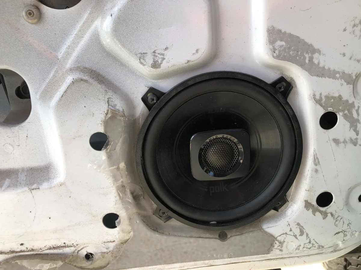

Today I removed the door panels and mirrors to replace with new, stable mirrors. While I was in the door I replaced the 29 year old factory speakers with Polk DB 5.25”’s. Sounds so much better. Next weekend will be the head unit I got from @tworley.
check out this stock cone! 🤣🤣🤣
The new Polk’s
Son doing the work! Likes the new sound.
New mirror painted with SEM Trim Black is so much better than stock!
