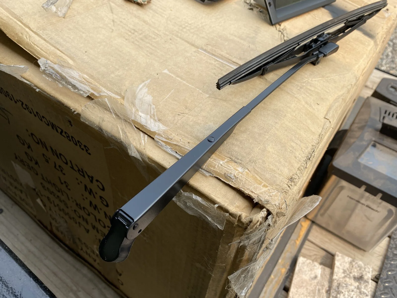

life picking back up with the XJ. Today I worked on all the exterior accessories. They are all faded and look like crap.
Scuffed with scotch brute pads, cleaned w alcohol, sprayed with adhesion promoter, and top coated with SEM trim black. Looks a lot better. Still a long way to go, but it drives well. Big plans the next couple of weeks.

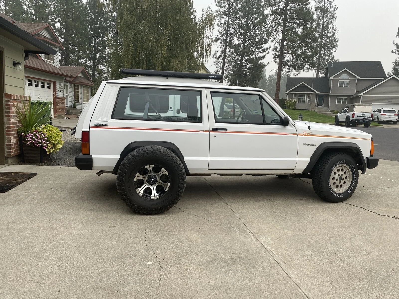

I’m a little concerned that the rear will get too much lift because the Sport XJ is lighter than the 4-Door, but I’ll just remove a leaf to adjust. Doing a leaf lift in the rear will be a new experience for me.
For fun I put my 33 spare up beside the XJ just to see what I’d be looking at. There’s nothing that changes the look of a vehicle like wheels and tires.
