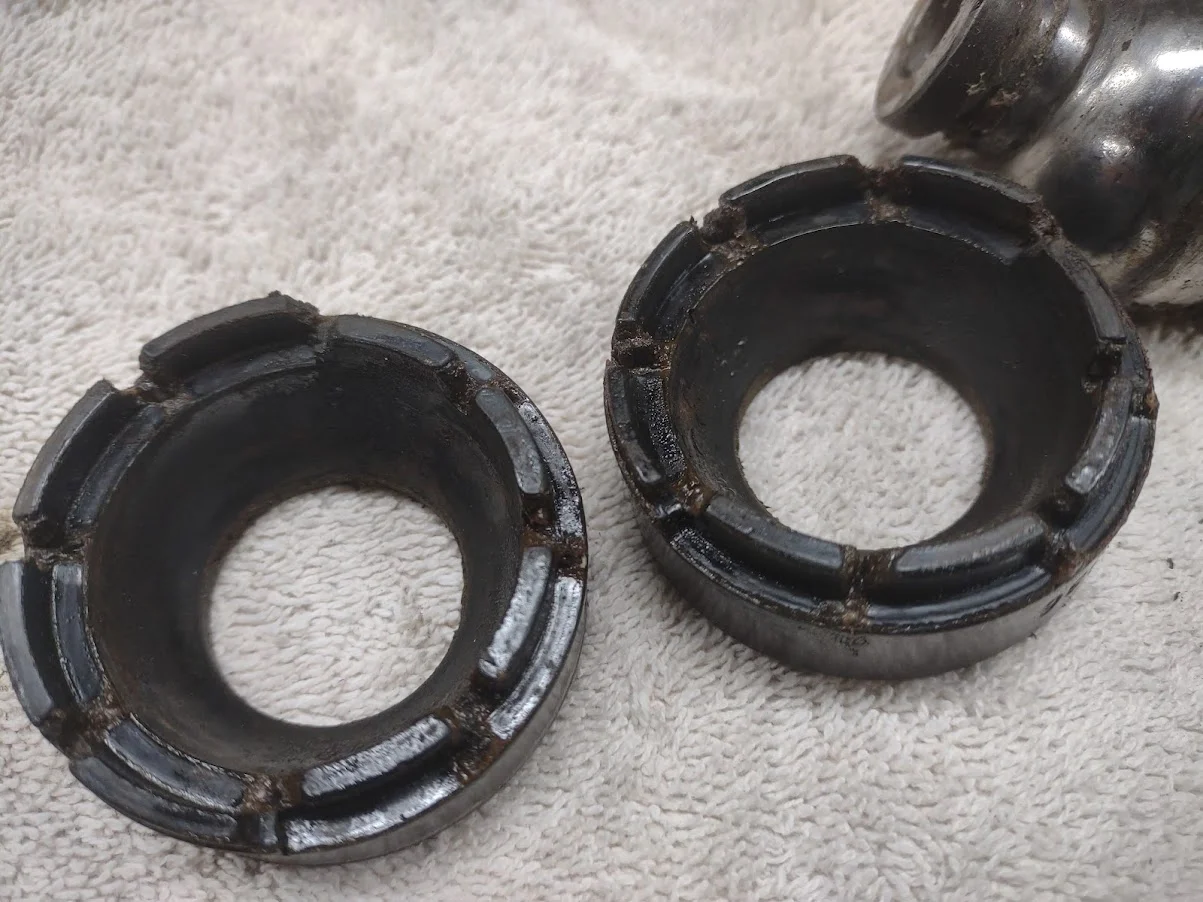

I rebuilt all my rear johnny joints yesterday. These were done once already this year, in May. Couple wheelin trips and this is what they looked like...
The grease is a solid. Its also been displaced out of the joint, so the place where the ball rides was dry. The net result? My jeep creaks and groans over bumps like a room full of 40 year old "dads."
Once you dip the parts into a tank of simple green the grease transforms. It becomes a snotty, sticky mess. Its gross. Can't brush it off, it just slides around. It needs to be wiped off with a disposable rag (many disposable rags). Anyway, I cleaned them all off again and lubed em up with the energy suspension stuff. As a secondary experiment...On the front I just put enough grease in to cover the "race". On the rear I placed much more grease in. Enough so that it squeezed out the grooves in the race and made a collar of sorts around the ball. The theory I'm testing is if the grease will create a barrier toward water intrusion.

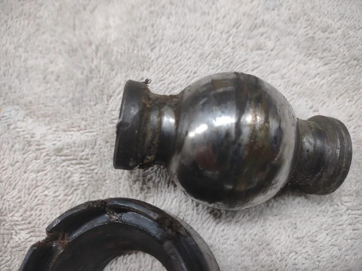

Not that I expect you to miss it but a lot of folks do. There is a long side and a short side to the ball. Done that way to have the same amount of bolt sleeve sticking out past the joint body.
^^ Almost all the balls on my rig have a small line around the collar on the bolt sleeve on one side. That side goes toward the side with the snap ring.
They haven't always had that ring to tell you. We just got in the habit of marking them. Doesn't matter how you do it, just be aware it needs to be done.

So, Does the long side of the ball go on the snap ring side? I redid the uppers over the winter. And now that its mentioned , I remember the sides being different. But thats it..until now.
Long side goes on the snap ring side due to the extra bit of depth needed to add the snap ring and groove for it. The other side doesn't have a snap ring, just the lip for the washer.
