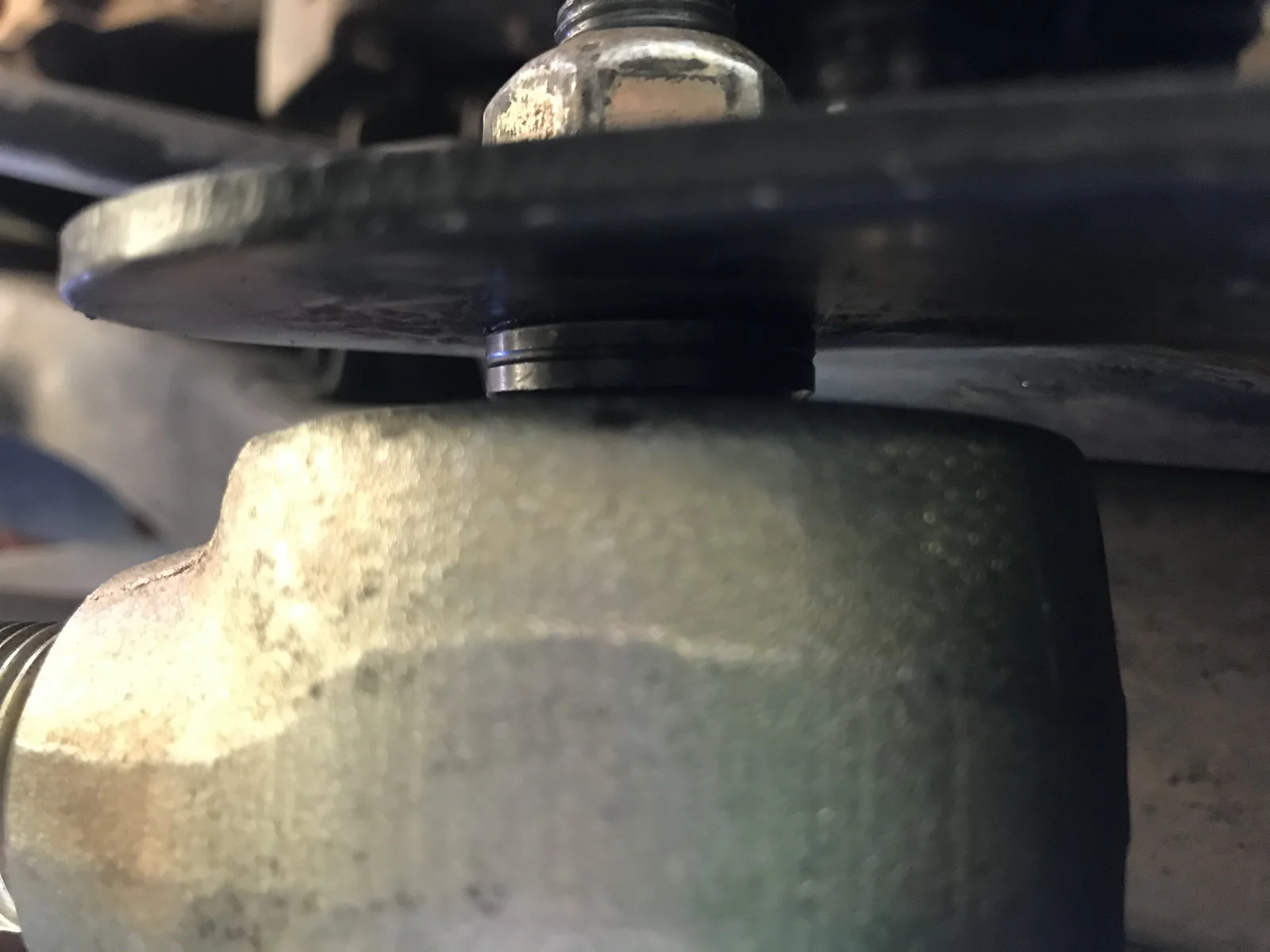

I serviced the joints on one arm a couple of weeks agop. I am woaiting till after a wheeling trip next week to do the others. I went and chcked for the line on the balls of the one arm I serviced. Both ends are wrong. :)
Mr. Blaine and others, it seems to me like a liquid lubricant applied on a regular basis might substitute for grease done annually. Whay say you brainy guys?
Here is the line:

The issue is two fold. The races are compressed a bunch to keep the ball from doing anything except what it is supposed to. The vast majority of us don't have an issue with lube life. The problem is wheeling in clay sucks the oil out of the base used to turn it into a grease which leaves the base behind. (anecdotal speculation) If you used just the oil, the clay will dry that out as well. We are trying to find a grease that is immune to separation.
Not that I expect you to miss it but a lot of folks do. There is a long side and a short side to the ball. Done that way to have the same amount of bolt sleeve sticking out past the joint body.
You have set your expectations of me far too high. I did notice the ring, but it didn't occur to me that they would be offset in any way.

Deposits? Like something that is hard like rust, but isn't? Did that ring on my center ball come through in the picture? Yeah, I get that. It's the leftover stuff from the grease, after the oil has left the building, or so I assume.
