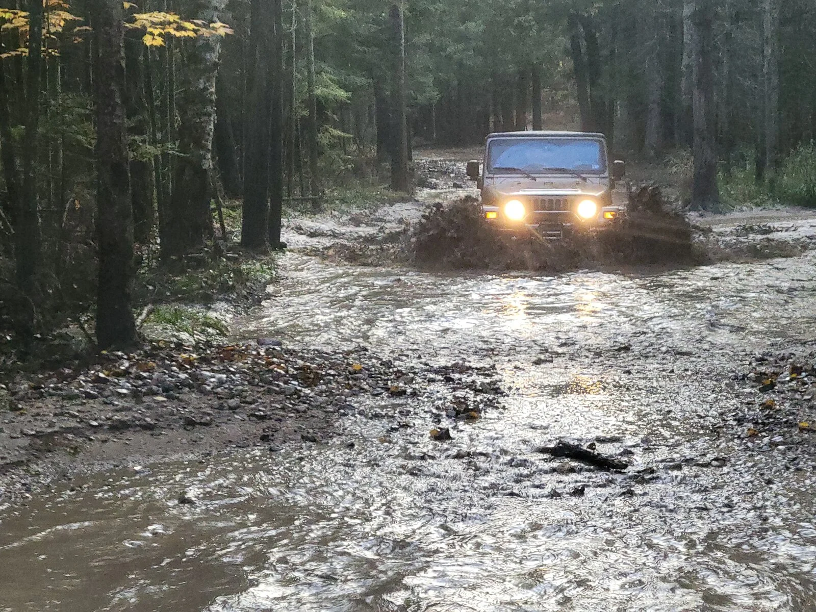

I went a month ago and played in the mud. I didn't get stuck, but this was pretty typical
OP
Mike_H
Mike_H
autos are better - WRWD508
Feb 28, 2017
10,383
Grand Rapids, MI, United States
This was Drummond island, right? That looks like a screenshot from a Jeep commercial.
Correct. My wife managed to grab one of the best shots of the trip, bouncing around in the back seat of my Jeep, with her cell phone, through the rear window!

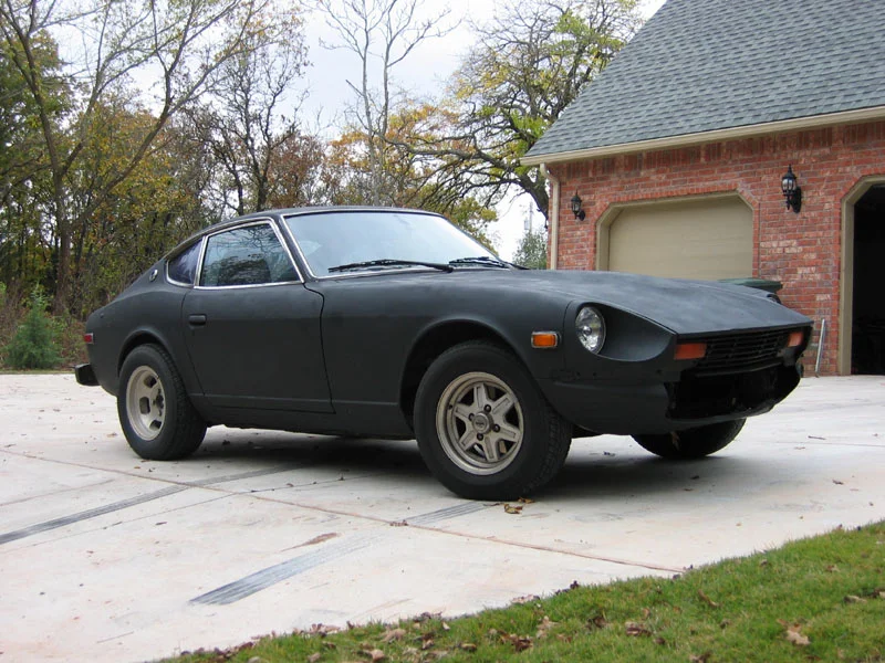

I want to see the Z.
Hate to disappoint, but it was a beater in appearance. I spent all my college student budget on the mechanicals which left enough for a rattle can paint job. Flat black was the color du jour back then.

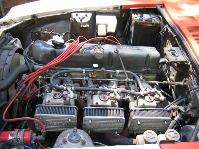

Digital photography entered my life roughly halfway through ownership so I don't have nearly as many photos as I'd like, in fact the only engine photo I can find was pre-paint, where it's obvious that the body panels came from at least two different cars.
I built the engine with flat top pistons out of a 280zx and milled the head a bit for a 10.5:1 CR, a moderate cam and triple weber carbs, 6-1 longtubes, matched it to an 8lb flywheel and a 5 speed and 3.90 rear differential (vs the 4 spd and 3.55 it had), also out of a 280zx.
