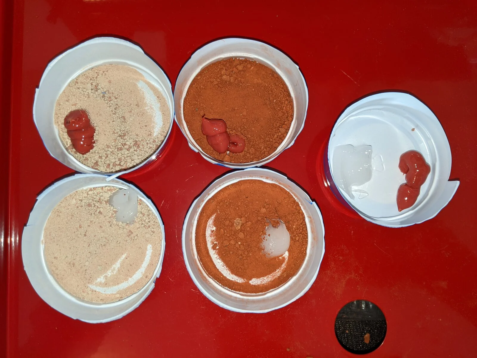

ok, so here goes.
I collected 2 samples of clay-rich soil from my property in Oklahoma.
We have two flavors of clay...the red stuff, and the white stuff, so I got one of each. I can't tell you if these specific samples were "native" to my property or whether they rode in with some fill dirt because there are 4 houses in different phases of construction on my street and mine is in the middle of them.
I cut the bottoms off of some solo cups to create some petri dishes, placed a generous dab of Redline CV2 grease w/ moly into two of them and a dab of Energy Suspension "Formula 5 Prelube" into the other. I then filled the dish with amounts of dry red and white clay as to completely surround the grease to a consistent depth with a little dust scattered up on the side.
The fifth dish without any dirt is the control, because science.
I'll take photos every 24 hours until either results appear obvious or it becomes apparent that they're going to happen on a slower scale than justifies daily checks.
