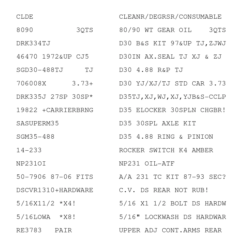

Sancho
Jan 17, 2018
1,756
San Diego, CA, United States
@michi
Give this a look over.
It is a list of items that was part of an Sye, regear from 3.07 to 4.88, new control arms, new beefier axles, new seals, and a rear electric locker.
I already had an aussie locker in the front.
Don't forget to replace the speedogear.
