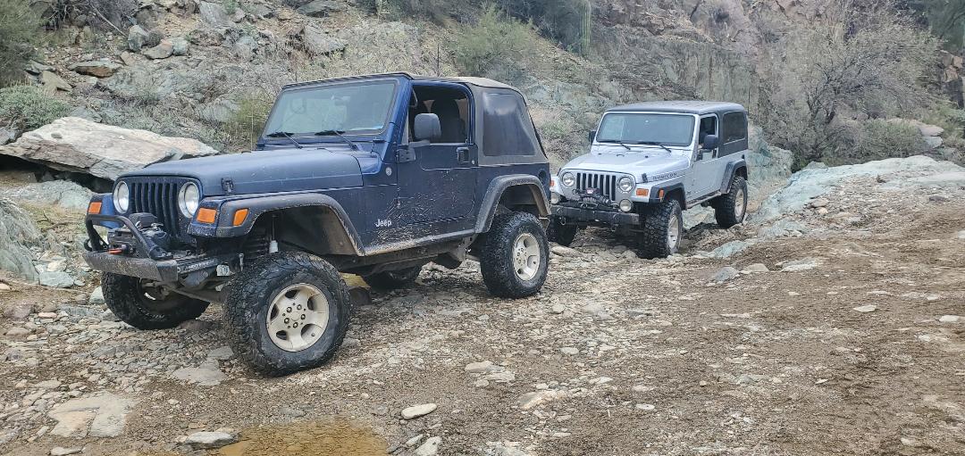

Why do you assume tire size difference percentages are directly proportional to gear ratio difference percentages?
Because of math?
Because when I went from 4.10 gears and 28" tires to 4.88 gears and 33" tires I was now doing the same RPMs at 70 mph (3000) as I was before the changes.
However, as was alluded to earlier, me going from 4.10 gears and 28" tires to 4.88 gears and 33" tires brings me back to the factory parameters, but it doesn't compensate for the larger tires' increased weight and rolling resistance. So if I was to bump it up just a little bit more to the next available gear ratio (in this case 5.13) that extra 5% change would help compensate for the increased tire weight and rolling resistance with a negligible change in RPMs at highway speeds. Or when pulling a trailer.
Four-cylinder TJs are much more sensitive (and responsive!) to proper gearing based on tire size compared to six-cylinder TJs.
