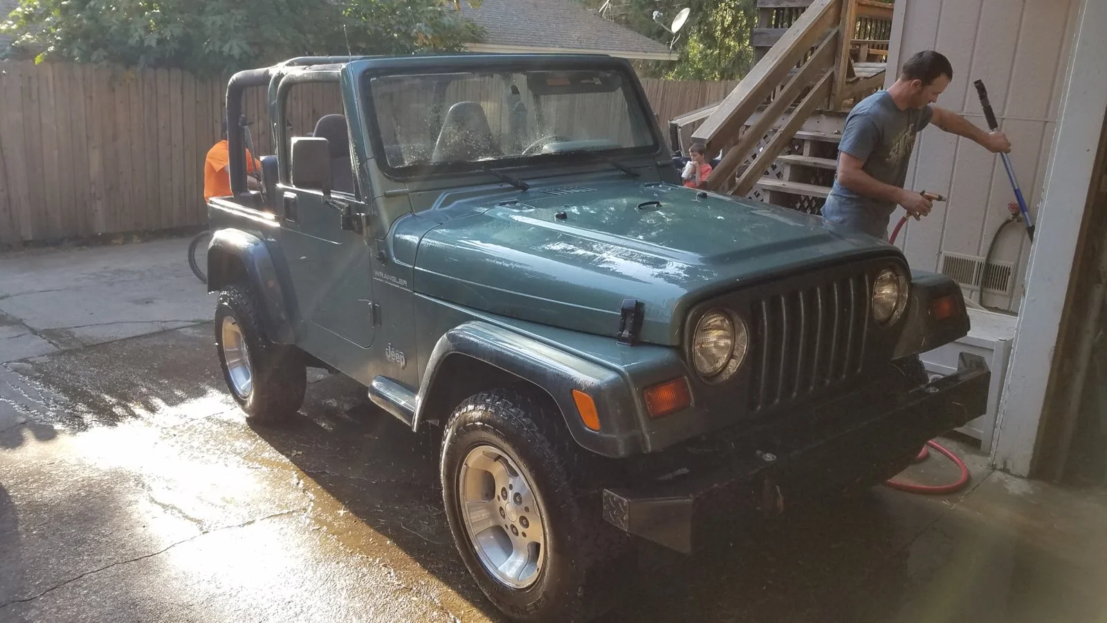

I picked up a 99 wrangler se with 100k miles, 5 speed no a/c. Fern green? Got it cheap was going to clean it up and sell it, but thinking about using it for my daily. Anyone know if factory a/c can be added? Gets real hot in summer traffic here!
