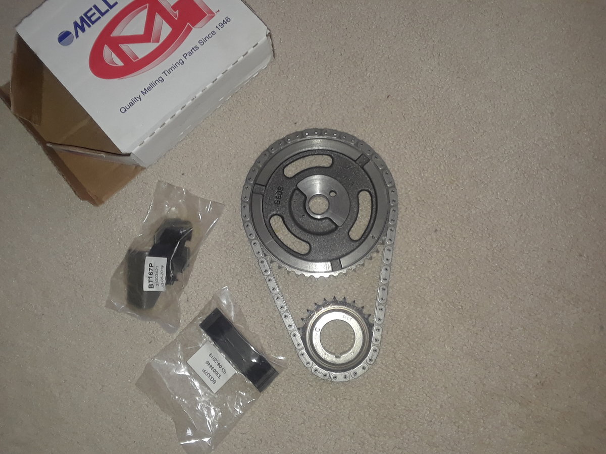

I checked the timing chain and found 8 degrees of slack. 2.5L was running terrible and throwing misfire codes and a too rich condition code.
I was not able to find timing chain slack specs but at 175k it can't hurt to replace all that.
Installed new Melling timing chain, cam and crank sprockets, and snubber. $55 or so.
Coincidentally, the day before I did all this, I heard a metallic noise from the front of the engine...
You can see how the chain dug out the metal holding the rubber snubber. This is the old and new rubber snubber. I caught it before it really got bad..
Easy to see how the timing chain dug into the snubber metal ears and thats at 8 degrees slack. This wis where the metallic noise was from.
Engine was running terrible still, after install. A guy in my jeep club suggested plugs. I still had POs spark plugs so I pulled one out, a Bosch iridium. Replaced plugs with OEM champions as posted under the hood and that did it. RUNS LIKE NEW!!
If you have Bosch iridiums in your 2.5L yank them out asap, thay are junk. My 2.5L runs like new and all codes are gone.

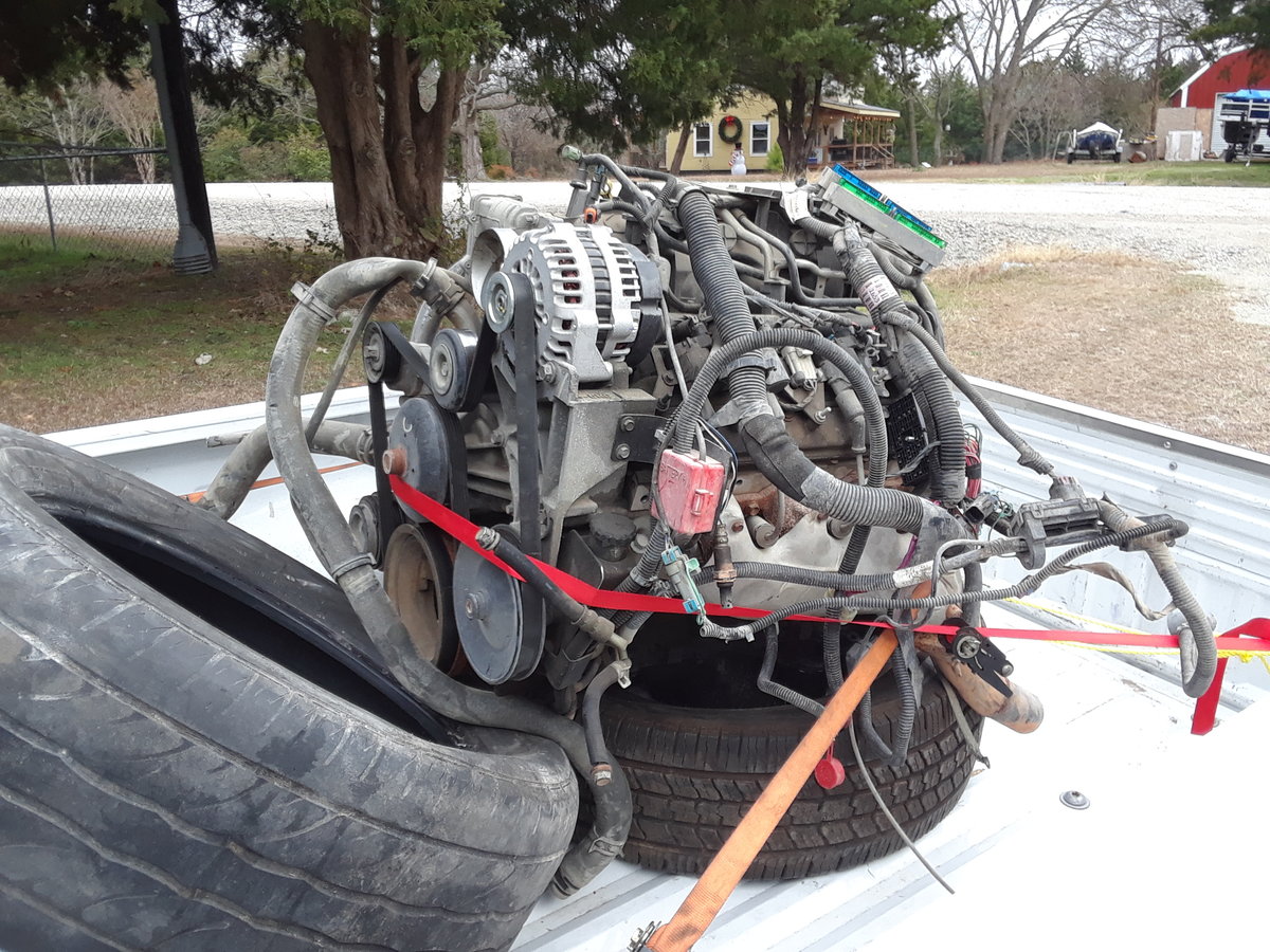

Well well I found another. 2006 hard to find, rare L33 all aluminum Chevy high output 5.3L. truck engine.
330 HP, 350 lb torque.
Drove to Waco, Tx this morning and picked it upView attachment 130392. Complete engine with 131k miles, $1000 and that's if u can find one...
Where is that going?
Where is this engine going???
U and JMT thinkin alike! Well good question and the answer is i dont know.... just hope i dont find another L33 cuz i dont have another $1000 handy 🤣😩
Right now I will just take the motor apart, rebuild it, and have it sitting on an engine stand ready for a swap... it's on standby for now 🤣
