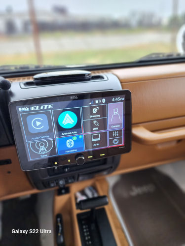

My Headunit is a Boss 10" Touchscreen BE10ACP single din with removable screen, Android Auto, Bluetooth, Rear Camera, Microphone.

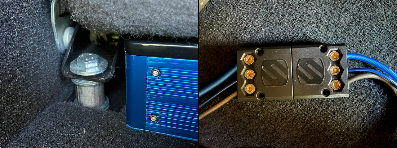

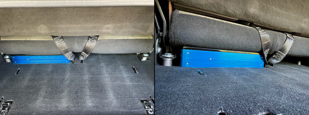

So I bought the Kicker CS series as recommended by many TJ videos, and fellow enthusiasts…..
However sadly, theyre nearly empty on the sound stage. Im powering ea of the 4 main channels with a 100Watt per ch RMS amp. I also have them in the $90 aftermarket Sound pods
Tried the Soundstream P4.1000 D class
[/URL]
Tried the Rockville Proton (80w x4ch)
[/URL]
I know a part of the issue is the 6.5” Skar TX65s in the rollbar pods are waaay overpowering them on the sound stage. Benefit of bein close to the heads of front occupants.
So Im sending all the Kickers back, and Im back on the hunt. The Polk D522s look about the same on paper, so lookin for some user input here who installed an amplifier and got a better 5.25” front to balance out the 6.5” in roll bar.
Im lookin at Components and Coaxials but thinkin a component might be better so as to put the tweeters top of dash for a better sound stage. Just need to keep it 4ohm
Anyone gor higher end speakers up front that can chime in on better amplified options??? Im lookin at Hertz components next, but seeking input
