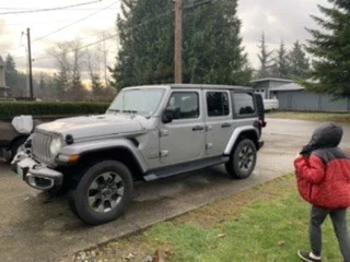

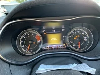

Here’s what my 2019 did to me last week , at least they gave me a decent loaner, And the error light disabled 4wd and brakes due to some wheel sensors. We’ll find out tomorrow, the JL Sahara was worth more than my kL new
