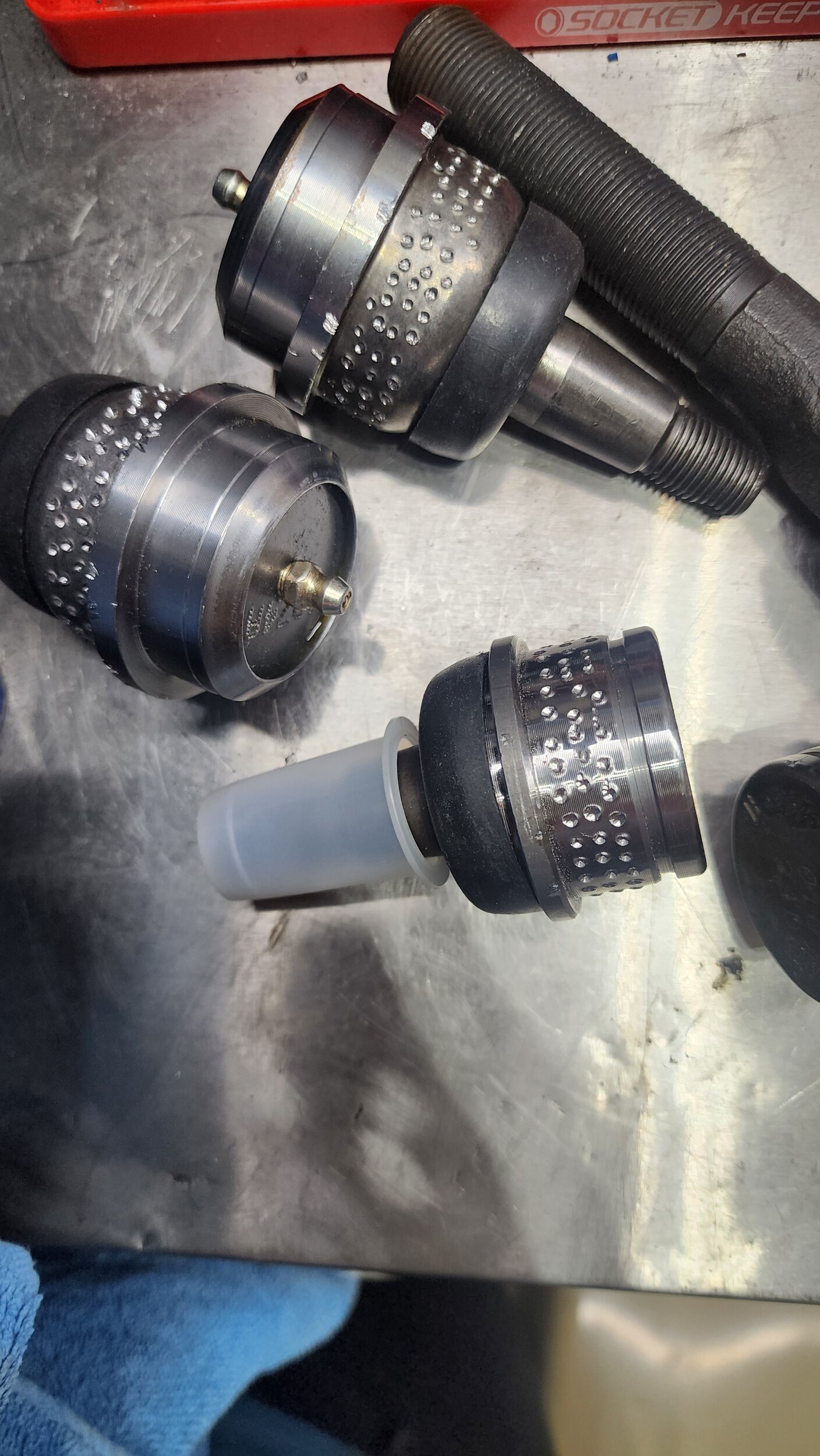

So I'm currently experiencing some shimmy, and while I did everything so far possible to balance my tires, check them, road force balance them through a few local shops, my shimmy still here. Noticed a little play in the RC trackbar so replaced it with MetalCloak one. My 2006 Jeep LJ only has 67k on it, 2.5 inch lift and 33 inch tires. While checking all the rest of the steering, I didn't see anything moving other then a possible bad ball joint on driver side. I can lift it up and down with some force by hand, ohh so little but enough to make a clunk up and down. I'm thinking possible that is my issue.
Long story short; thinking of replacing ball joints which are Rough Country ball joints. Looking at photos of them, they seem to be the knurled ones. I'd like to go with Spicer ones that are smooth. I've seen many here used a punch on the smooth Spicer ball joints and 680 Loctite to press those in place of Knurled ones.
My question would be, how successful was that for those that did do the switch back?? I'm thinking if I replace and go with RC or any knurled brand, its aftermarket and they might not last as long again.
Thanks in advance for the feedback, opinions and tips. :)

I had one side knurled and one side smooth. Pinged the new smooth ones all the way around maybe fifteen or twenty pings. 20,000 miles later and I’m still running smooth and straight. No wobble or shakes. It fit back in tight. Ping it and send it.
Like @Mike_H, I too converted from knurled back to stock Spicers. While I only have roughly a thousand miles since the replacement, they pressed in very firmly and haven't moved since the install. Also, I believe the correct Locktite is 609, but others will jump in to correct me if needed. The following shows 609 as a typical use for press fit applications.
https://www.mecampbell.com/media/pd...ceLQ9nkkIUtD6GnN3diwb9tYVnCV3jKYN1esIMY8JNn77
I only went and got 680 because it's stronger. I knew about 609 but thought stronger better? I might be wrong
That should do it for tomorrow's install. :)
That will work- for future reference, I prefer a sharper punch, less depth, and more of them. It really doesn't take much to really increase the interference fit.
It was pretty sharp and new :) I could add a few more in there if needed but I can sure feel the difference already.
I can probably use the smaller punch, like the push punch for smaller ones in between if you think itll be better but if not, then no need the extra work :P and I will be using 680 loctite on it.
