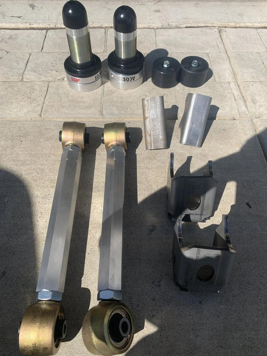

For a while ive been wanting to revert back to a shorter suspension setup, the RE 4.5 springs gave my Jeep 6 inches of lift over stock which is way too much and the jeep truly drove like sh*t. Ill be reinstalling my old 3 inch zone springs which gave me just under 4 inches of lift along eith these parts and a 1.25 body lift in preparation for 35s.
Here we have a set of Metalcloak aluminum arms to help me not rip off anymore lca mounts as well as Artec lca mounts with the skids. I have JKS ACOS to let me get the Jeep level enough to keep from annoying me and some 2 inch RE lower bump stops to get the bumps just right. I also have some rear shock mounts because when i did the 8.8 swap i welded them on too high which has limited my rear uptravel. Hopefully by the end of tomorrow ill have everything but the body lift which hasnt arrived on and back on the road and hopefully shell drive better again!

Those acos spacers will add 2” to your 4” springs.
Reactions: Justin Homan
Yep, the front for whatever reason is always a little over 2 inches lower than the rear. Its been something thats puzzled me since i started modifying this thing. Its not disproportionately weighted and the 8.8 only adds about 1/2 of extra height to the rear.

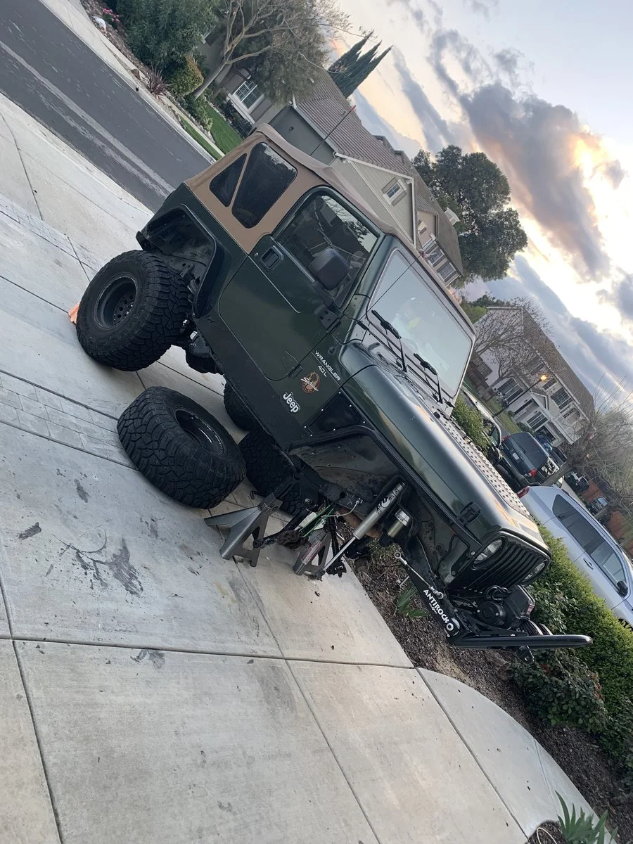

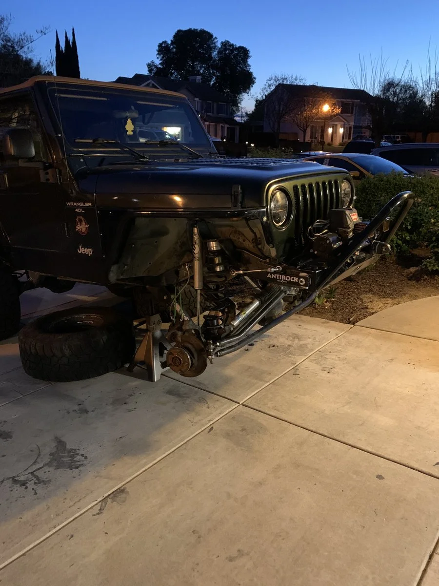

Made some good progress today, got the front end bump-stopped with the ACOS and new pucks then proceeded to pull the axle. Tomorrow morning will consist of finishing the front end although i may re-use the RE springs if time wont allow for me to do the rear as well. If thats the case next friday ill get that done and hopefully ill have a body lift to do then as well.
Reactions: BuildBreakRepeat
Day 2 done, I didn't get as far as i wanted but got the new lca brackets burned in and the Metalcloak control arms in. Made it a good ways putting her back together but had to stop due to lack of light. Tomorrow night im hoping to get the front all the way back together and start on the rear.
Got the front end together this evening, all all thats left to do up front is straightening the steering wheel. I will start on the rear Tuesday evening and hopefully be able to finish it Friday morning.

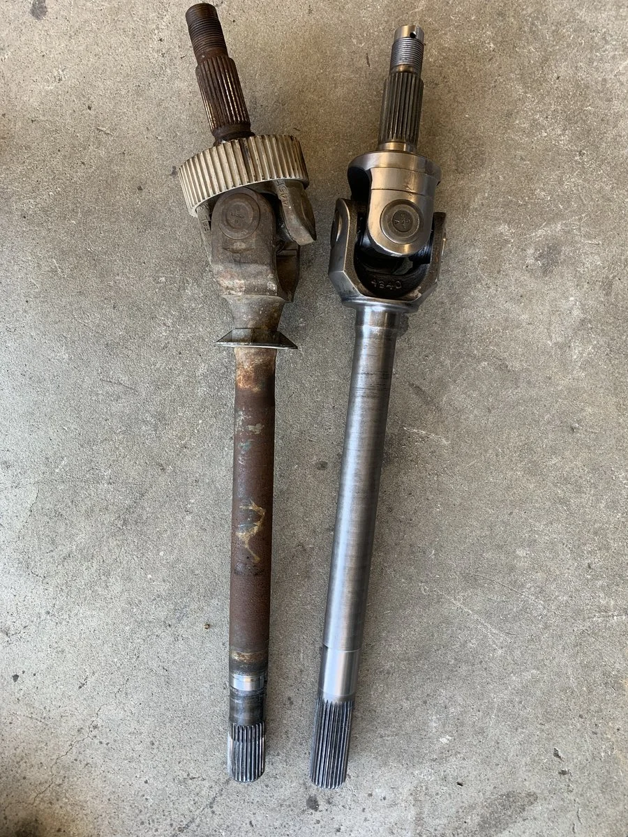

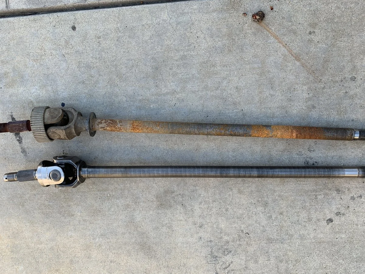

Got the rear end set down on the shorter springs earlier this week and took today to install my USA Standard 4340 chromoly axle shafts.
These were a simple and quick project that is quite necessary for a big change i have coming very soon.

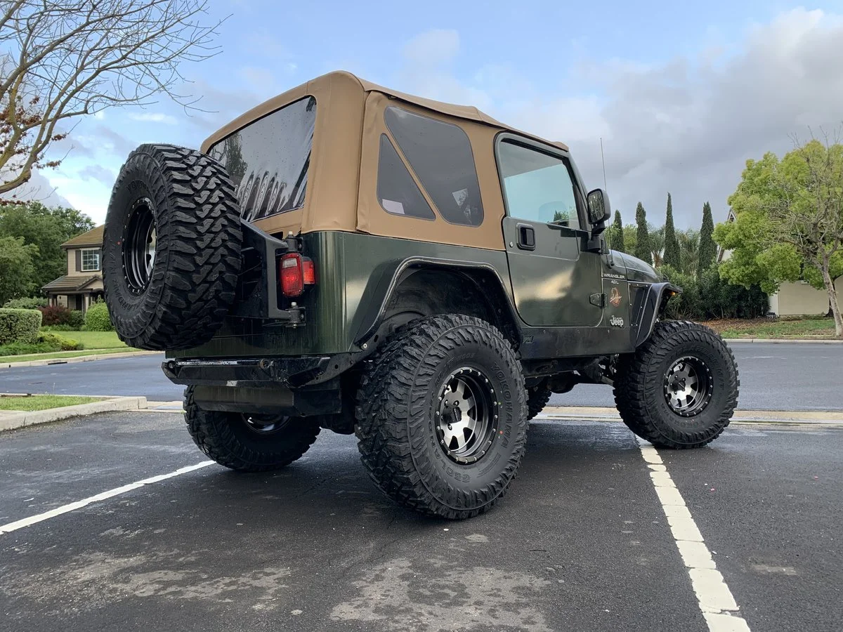

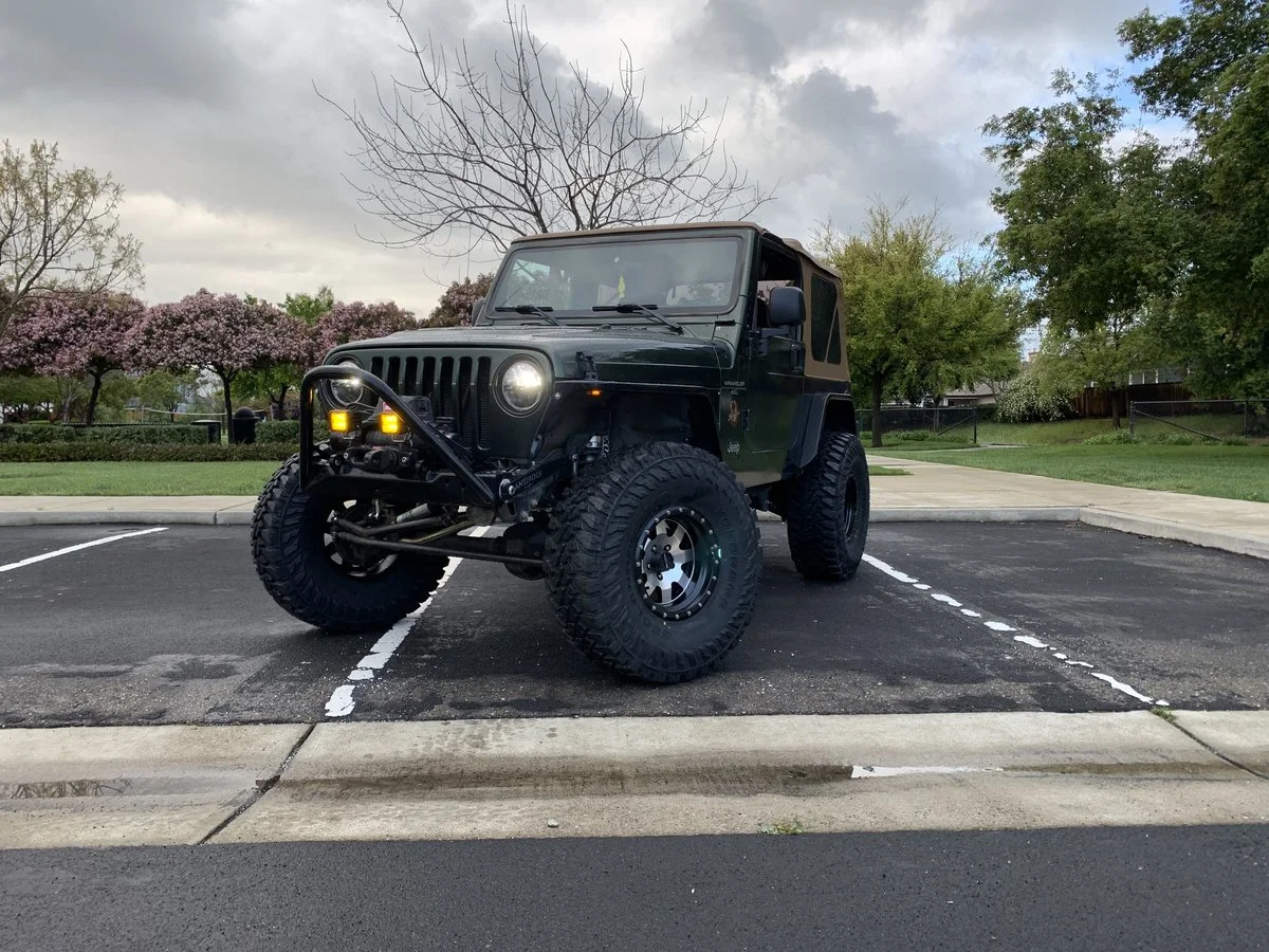

Still dont have the rear shocks on but these happened today.... All i can say is holy sh*t they are perfect. 35x12.50r15 Yokohama Geolandar G003 wrapped around a set of Raceline Defender 935m, specs on the wheel are 15x8 -24 offset (3.50bs). By the end of the week shell be back to being my daily driver.
Finally got her done and got a chance to do a nice drive as a bit of a test and all i can say is wow she drives good!
Before these recent changes she had some bump steer and wandered all over the road even at proper tire pressure. Im running these 35’s at 26psi and she runs straight as an arrow. Lowering the suspension seems to have done the trick as well as theres no more noticeable bump steer. Ive also noticed it seems a bit more comfortable than before, Im not sure what to attribute this too as it could either be the new rear shocks or the Metalcloak lca’s. The Yokohama’s are a nice tire too, they are very quiet although im sure they will start to make some noise as i wear them in. So far im extremely happy with these changes. Also enjoy this picture of how far this Jeeps come over the years, same spot just under 3 years apart.

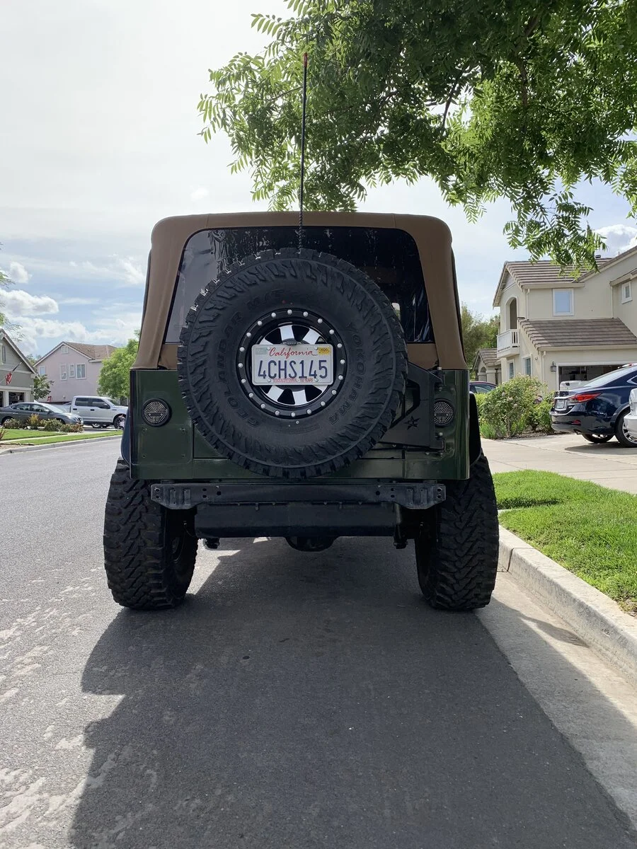

Been a while since ive done anything to the Jeep but today was the day. Finally went about ordering the Maxbilt TrailTails ive been eyeing up for the last couple years and damn do they look good!
Heres a before picture for refrence, also note that my Jeep didn't have a 3rd brake light, another thing i changed today. The wiring was extremely simple and only took about an hour to get the tail lights changed over. Running wires for the license plate light was the most difficult part of the job.
Heres the final look! I will definitely want to do some sort of corner armor to cover the holes were the license plate was and also protect the corners since the bumper i ordered isnt full width. Next step for this Jeep will be a Barnes4wd rear bumper with the 2 inch receiver to make it easier/cleaner to haul around my mountain bike.

I’ve got them as well, the back up lights are great at night!
